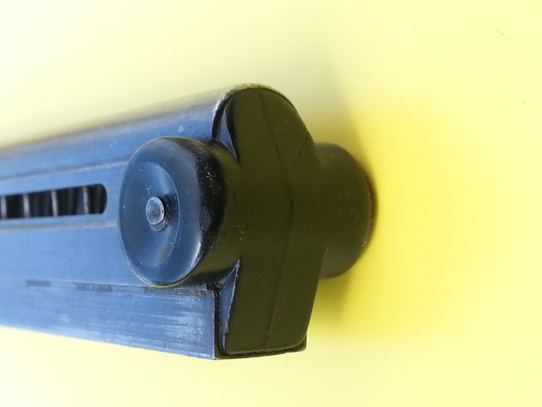

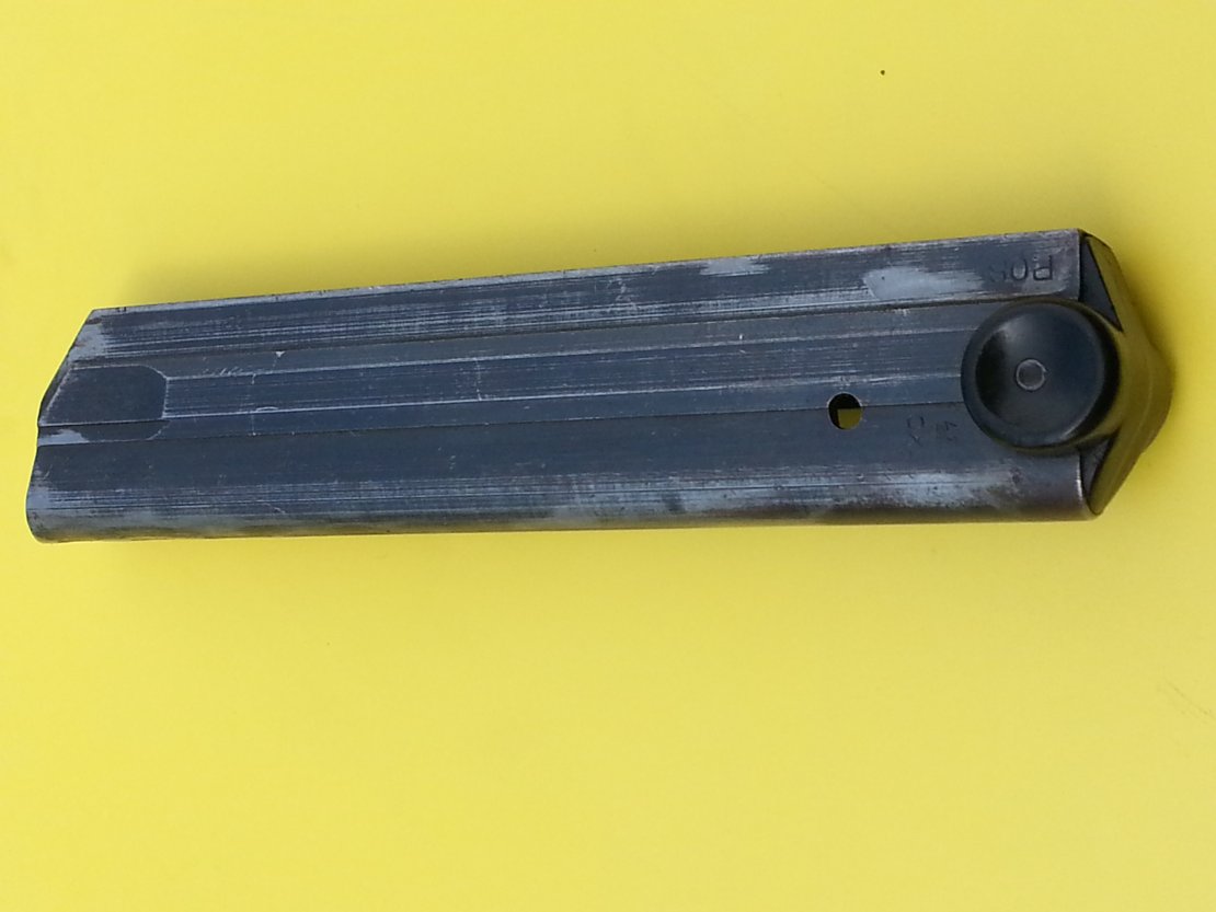

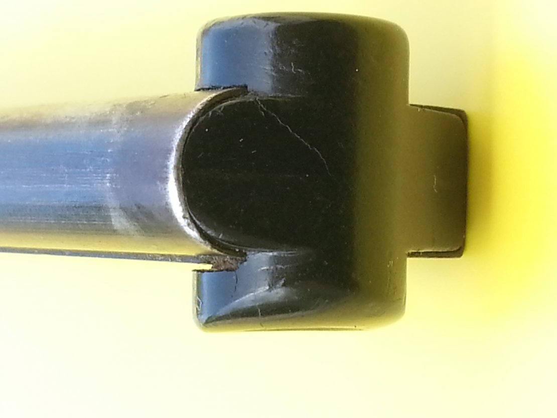

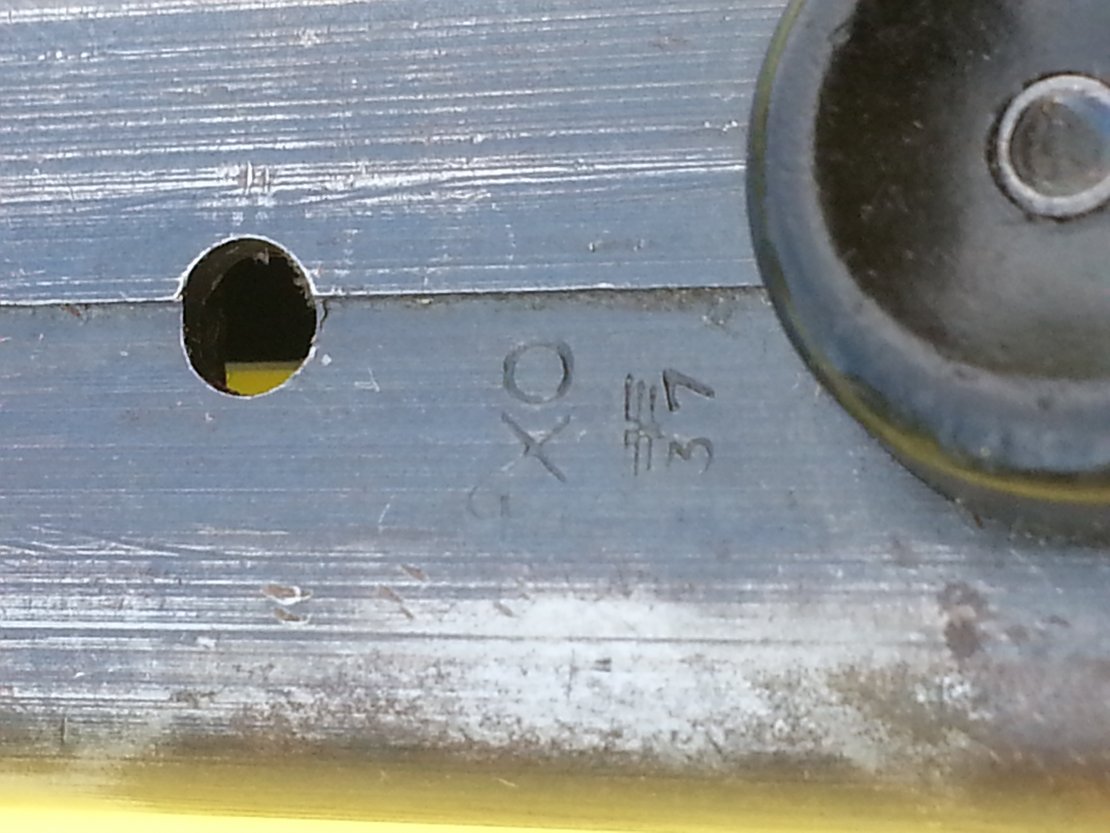

The mag you have is a WW2 military mag - you should have a blank, wood base, tin or nickle body
Unread 05-13-2015, 01:24 PM   #3
Your FXO magazine will be of interest to late WW2 Luger owners, as it would be universally correct for some models. You can get $150+ depending on condition and then pick up a magazine that is correct for your Luger.

I have some pictures of the mag.its not marked on the bottom and one of the lobes on the bottom is worn quite a bit but it has no dents or rust or pitting.

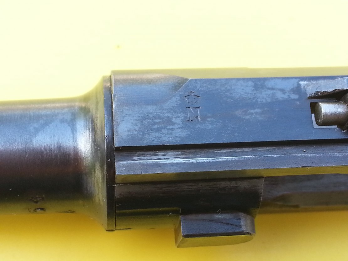

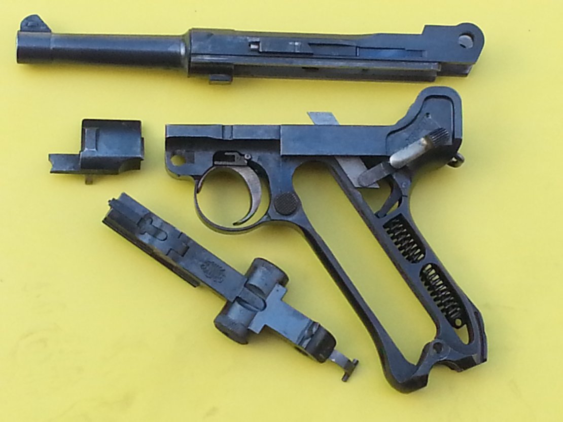

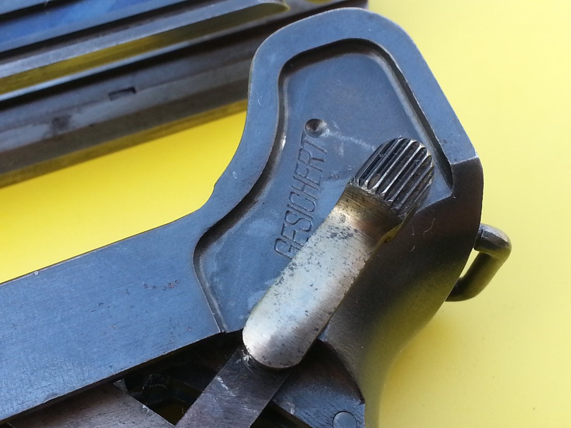

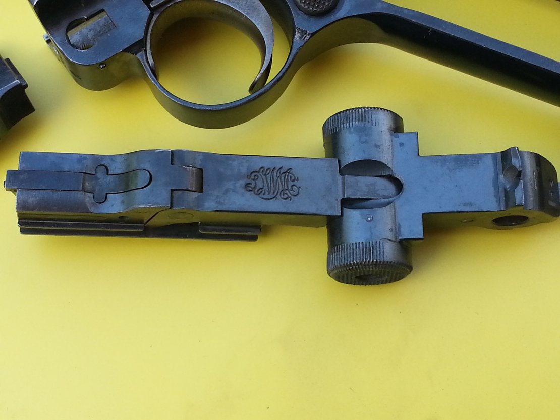

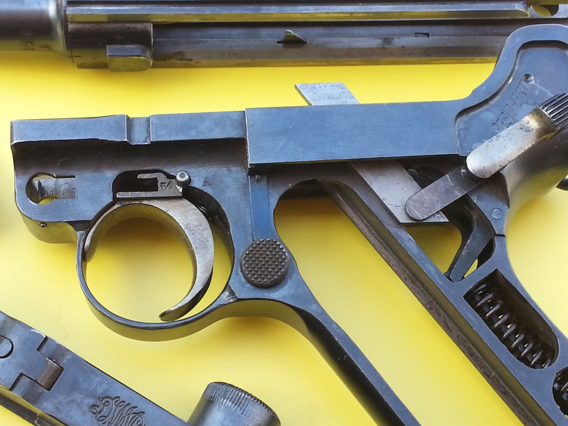

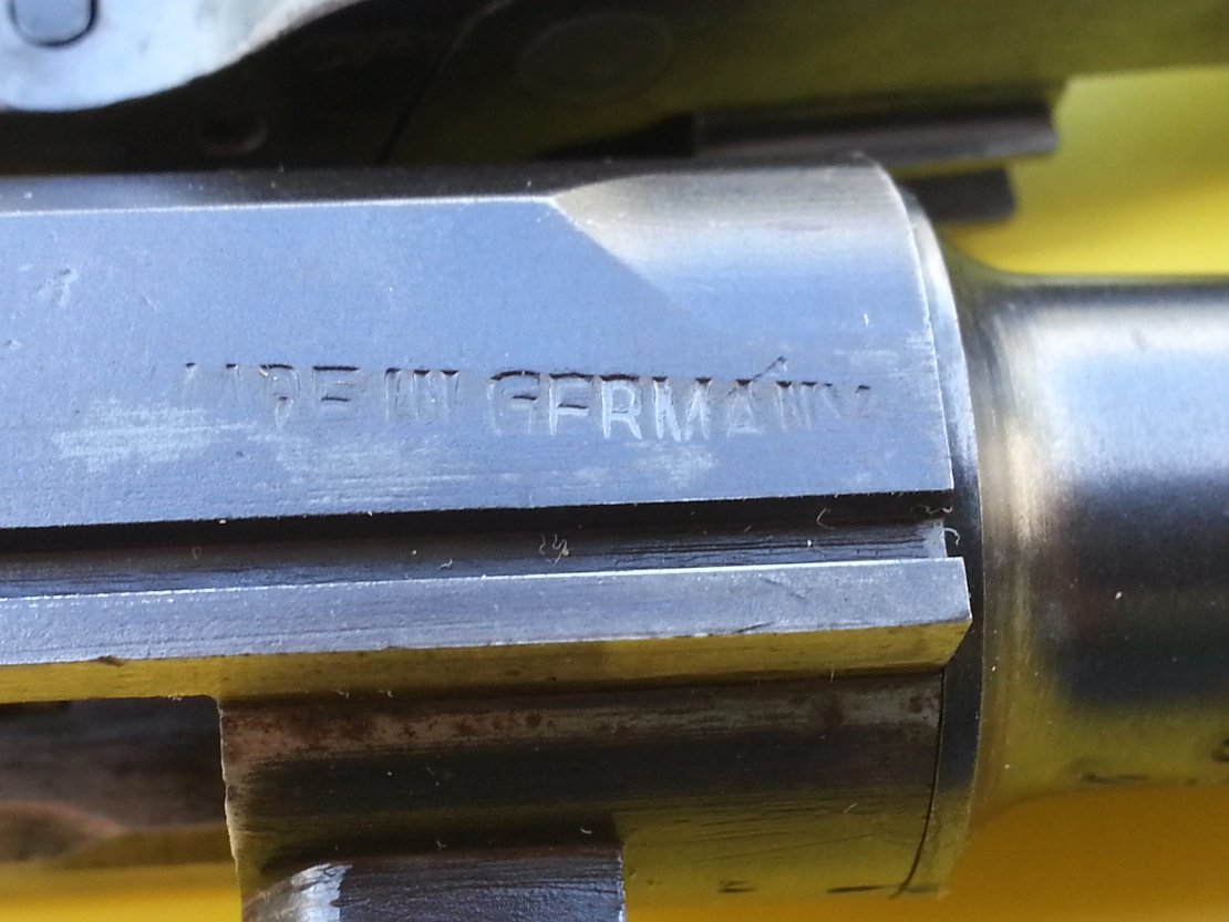

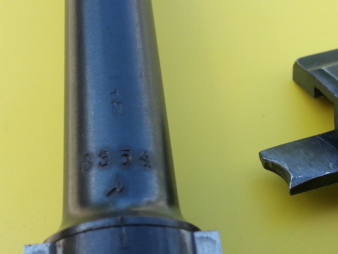

Here are some pictures of the DWM alphabet luger. It seems to be in too good shape I think it must have been re-blued whats your opinion and the approximate worth. It came with a holster but I think its a generic one.

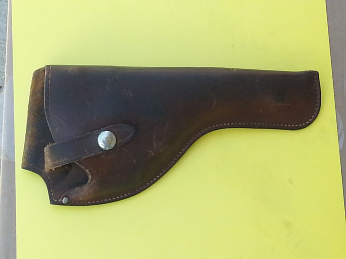

the holster

Hard to tell, it looks a bit smudgy but all the edges and markings are sharp and I'm not seeing any sure signs of reblue. Maybe $1000-$1200? Overall it looks pretty good. Holster is of little value.
If the inside of the frame is blued it's refinished for sure. But your pictures don't show us that.
Unread 05-15-2015, 08:42 AM   #10
The inside of the magazine well and the hole for the takedown lever appear unblued. How about the muzzle?
I hate to say it, but more photos will help.
But regardless, this is not a rare collector's gun. It is a nice run-of-the-mill commercial. So does anyone really care if at some point it had been reblued if the numbers and markings aren't all buffed out?
I'd say to enjoy it and don't sweat the little stuff.
Unread 05-15-2015, 09:11 AM   #11
I can tell from the fit, that your extractor is a replacement. The original would have had the last 2 digits of the serial stamped inside. TH
