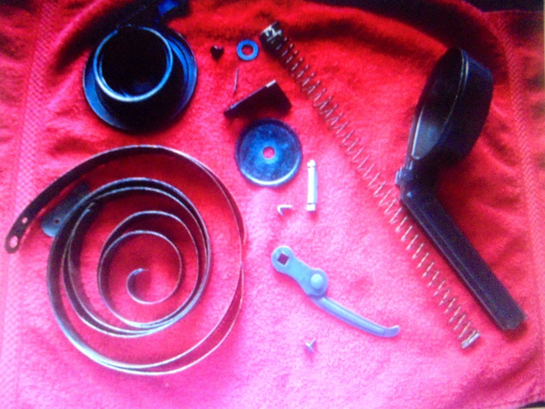

Default Drum Mag exploded view!
Hi to all, well for those of you who have never seen what the inside of a drum mag looks like, here you go! Pictures will be posted as soon as I can find one of the moderators to help me! ..........But, when you see it, you'll get the idea of what the, "Flat spiral spring" boogie man looks like!........ best to all, til...lat'r....GT

The next set of pics shows a relic from the battlefield! It was beyond any practical use, but the dimension check it provided was super helpful... Also, this is what 100 springs looks like prior to being born! And, last but not least, my custom spring winder, twister thingy? Best to all, til...lat'r....GT....

I think Rich, Rick & Eric have it right! There will be blood! ....... most likely as the spring material is pretty strong! And the final receptacle is pretty small! ...... But as mentioned, if needed, safety capture is pretty simple .. you just need a swinging bar over one small edge part of the diameter pie... What has yet to be done, is: finish the drilling fixture for the 5 total, four different, holes required, and the rivet set block for the truss headed rivet to join the bridle spring to the main spring... If there is enough interest, I will show the "spring making" journey step by step with pictures for the forum... And all the members can then make the 100 year old journey with me! ... Best to all, til....lat'r.....GT
