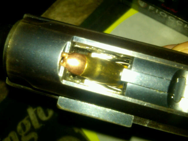

Fired a 30 caliber Luger, it consistently jams on feeding. The problem is same on every loading during cycling, and cartridge stucks on same position. At this position, even pull the toggle does not help because the bullet position is above the chamber. But initial round can be feed correctly manually. The hold open works fine as well.
Is this due to weak magazine spring? Thanks!

It might be affected by the spring, but I think it could also be OAL of the round. Hand-loads? Do different brands of ammo all do this?

The first thing that I would do after a good clean and lube, is to try a new Mec-Gar mag. That Fiocchi FMJ ammo should function 100% IF your Luger is correct. Start with the basics.

Check to see how high the magazine has latched into the frame. If there is a lot of play it could be shifting down too low during cycling.
The issue could also be the magazine spring. Don't try to disassemble it yourself. People that work on these (Like G.T. on this board) have special tools.
Finally, consider that the recoil spring could be a 21 turn rather than a 17 turn spring. This could have too much power, and cause the cycle timing to be off.

Proper O.A.L. for the 7.65 Luger should be 1.173 inches with a round nose bullet. None of the modern ammo I've measured comes any where near that.

It worked with a new Italian made magazine. I sold the gun to another collector, and sold the Italian magazine on ebay. As you guys know, most Luger collectors are chasing "Nazi guns", so it was not easy to sell, but it's in nice shape and asking price was low, so it was sold OK.

That looks like a classic "COL is too short" jam. To me, the round looks too short. Is the COL the same after trying to chamber as before?
Can you hand cycle them?
If the first round feeds fine, then the magazine is next place to look. The world is filled with junk magazines.
