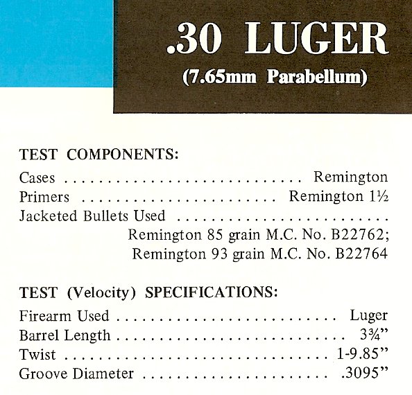

I was browsing through my old [1970] Lyman reloading manual and noticed the rifling twist for the 30 cal Luger...1 in 9.85" (which works out to 250mm)...
Is that right??? The same manual lists the .32ACP in the Mauser HSC as 1 in 16"; the .38 Super in a 5" Colt as 1 in 16"...
I routinely use Remington Model 700 and Winchester Model 70 rifle barrels in 30-06 for my 30 cal Luger barrels; they are both 1 in 10"...
It seems odd that rifles in 30 caliber should have twists close to the 30 Luger while other ~30 cal pistols use a twist almost twice as long...
I'm not complaining...Just sayin'...

Hi,
Well, here is what the Pre-WWI DWM Owner's Manual says:
Twist, 9.84 inches (exactly the same as the 9mm), 250mm.
Depth of grooves, .005 inches, 0.125mm
Width of lands, .122 inches, 3.1mm
Diameter of grooves, .311 inches, 7.9mm
Their metric numbers are perfect, with only slight rounding used for their inch numbers.
Please note that the Lyman Handloading Manual (above) groove diameter is way off. Stranger yet, please know that several of the original DWM bullets I've measured were all at .309 diameter.
Why shoot a .309 bullet down a .311 barrel? In the 9mm, why shoot a .355 bullet down a .358 barrel?
I hope this helps.
