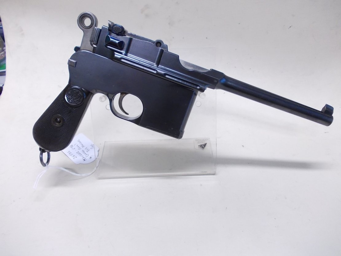

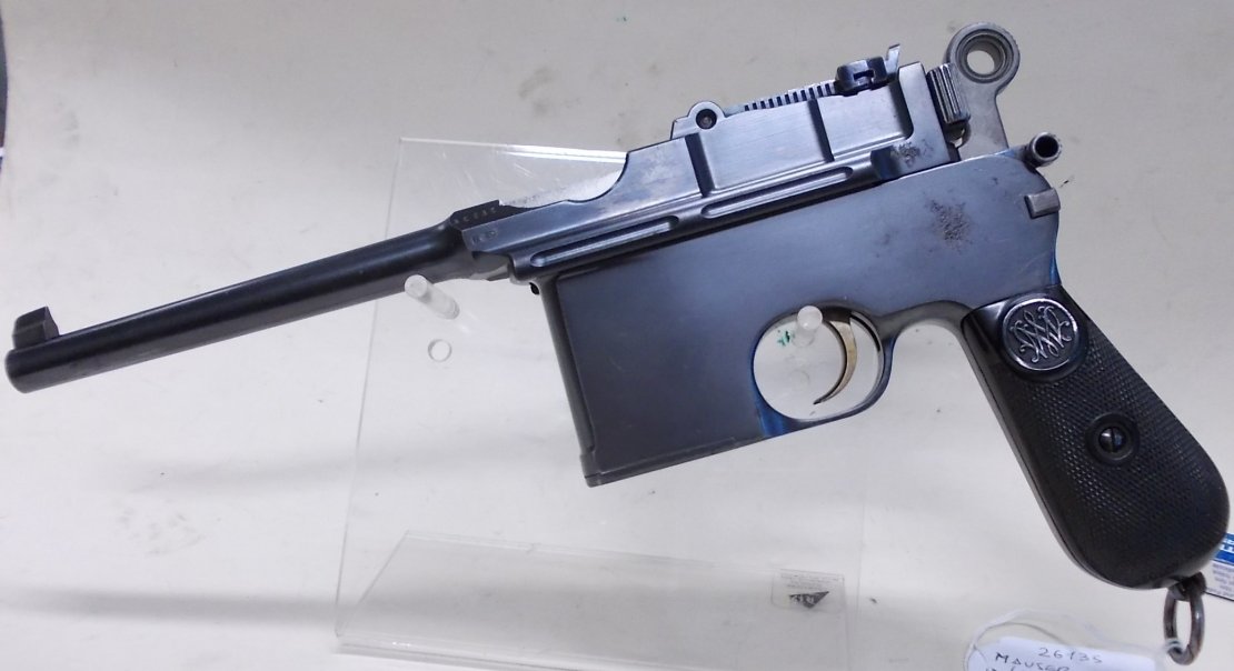

Recently with a reputable gunshop I saw this C96 late flatside large ring, it's not too bad, my bigger doubts are among the grips, according to "System Mauser" page 72 should have 23 groove walnut grips, while this gun has got hard rubber ones...

I would treasure the 'hard rubber' grips on a late Large Ring. You didn't say if you bought it...
It looks very nice...

That looks to be a very nice condition C96.

That looks a beautiful gun nevertheless. I am waiting to see alvin's learned postings and that of our other forum members.

Yes. There is such a variation of flatside with this type of grip panels. I have never owned one, but I saw it before. From these two pictures, although hard to tell it's correct down to everything, the general feeling is very good, the finish is correct with minor erosion and the color tone is correct.
No stock? LRH stock does not come easy. And the stock is fully number with the gun, 5-digit, so it's impossible to find a matching number stock separately.

this gun has got hard rubber ones [grips]...
[/I]
Would those be 'guttaperca' grips???

Yes those are the so called "guttaperca" grips.

I have a flat side, 22k serial range with Gutta Percha "angel" grips. The example above is a nice one any collector would welcome.
