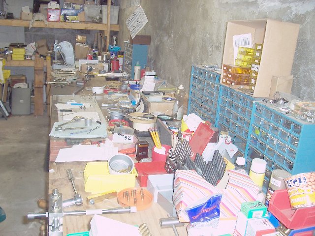

That teeny tiny pin on mine stuck to my drying rag and fell on the floor of my shop...For $1.00 I'll tell you how I found it...
(Took me ~15 minutes)...
(I can't find anything smaller than a wheelbarrow on my workbench!)

Rich,
I am impressed...your workbench actually looks worse than mine and I didn't think that was possible

Rich,
Only in the middle of a project... If you look close, at the bottom of the pic you can see my long-barrel Luger barrel in my barrel vise...I took that while milling the sight base...Notes, tools, bar stock, reamers, end mills, cartridges, TV remote...All within handy reach...
The bench is usually bare for dis-assembling, reloading, cleaning pistols...I have a stool but except for having a rag draped on it, it's never used...
