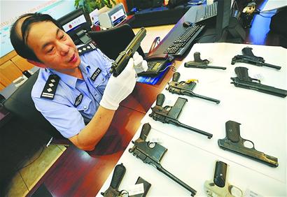

Nowadays, Nambu, of course, has exited from active service, and usually becomes part of police collection. On this table, there are quite a few kinds of C&Rs...a T14 on far left, even a Luger, a 1911A1, etc. All those were used by this police station in the past.

Alvin:
That is an interesting photo. In the cop's hand, a tangent HiPower? The front doesn't look beveled like a Browning but definitely a tangent rear sight.
And on the table, a box magazine full auto Schnellenfurher?
Used? Or confiscated & kept for ballistic, comparison, and training purposes?
Is that Chinese police? Are they regional or national?
Unread 12-01-2014, 01:51 AM   #11
It's police unit of an eastern province in China, equivalent of New Hampshire's "state trooper", so it's a regional level unit. Those pistols were their service pistols in the past, and have been in storage for more than two decades. The initial plan was to destroy them, but the officer in picture happens to be a firearm enthusiast, he made a request to keep this pistols "in memorial of man and woman's service in the unit". The request was approved, so he kept those C&R.
With all those different calibers, ammo supply could be an issue,,, he did show a picture of large number boxes of DWM and FN ammo, but I lost the picture. If I remembered right, the pistols of this police unit were almost all foreign-made guns, but they don't have any genuine FN 1900 -- all 1900 were copies. I guess the reason being original FN 1900 must be submitted to higher level (higher rank officials' favorite, a smaller gun), they could not keep them. But they do have quite a few copies, large and small variations.
Who would have thought that a guy with a comb-over like that would make such a good judgement call?
Unread 12-01-2014, 08:38 AM   #13
Even has the daintiness to use white gloves....
Unread 12-01-2014, 09:38 PM   #14
The best part -- after saving these guns, he got an assignment to clean and classify them, setup a display room in the bureau, write short description on each one, find each gun's service history if still possible, etc. Well paid job, without any business pressure. Many viewer asked, "do you need an assistant? I am willing to help without payment"
