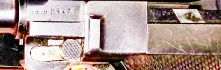

Here's a pic of that gun, showing the left side, including the sear bar. The operative digits for serial number marking look like a dot, then a "9" shape. Sorry about the gun show pic quality, which does not show the marks on the sear bar clearly. But it does show that they are not the usual "Western" Arabic numerals.

For your consideration...
I notice that the pistol in your pic has a side plate that is, technically, mis-matched--the digits are reversed, compared to where they appear elsewhere. What's up with that? Did a tech at the factory become dyslexic (maybe dysnumeric?) when marking it?

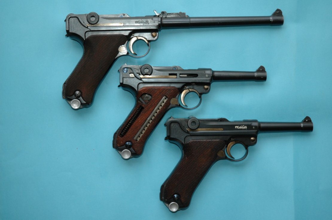

The following 2 members says Thank You to guns3545 for your post:
Unread 11-15-2014, 09:03 AM   #13
It's off-topic, John, but thanks for the pic of the cutaway Luger! I have a set of Khyber Pass grips I was planning to make into 'cartridge counter' grips like the Dutch experimental models. That gives me an idea of how they cut out the slot!
