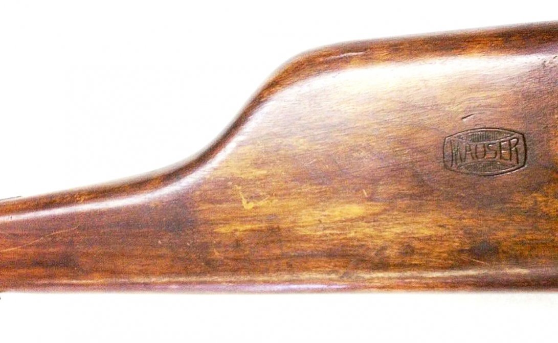

I know you guys have much experience, not to mention class and good taste, so I need educated opinions. I'm looking at a holster stock for my C96. I've turned down others as likely fakes, but this one I'm not sure of. The interior is definitely old. The wood is obviously weathered, The wrist hardware looks to be hardly used/NOS/a really good copy. It fits well to the wood. The hinge plate dimensions appear correct. Safety relief cut in the lid is correct for a later model. The lid latch button is possibly a replacement. So my guess WOULD be authentic BUT.....the wood finish looks iffy. by that I mean German C96 stocks are all walnut, but I can't tell if this one is just not re-finished correctly OR is it a stain over something else. If it is, it would lead me to believe it could be a mix and match Chinese (good copy) with German parts????
Here is a pick of a section of stock. Any opinions on authentic - yay or nay?

A copy. The wood does not look European and the Mauser Banner is very crude..

Thats what I was thinking. Its definitely a better copy than the new ones out there. I was wondering if it might not be an "original copy"...a piece manufactured WAY back when the Chinese started using, and making their own.
The main body is very old/worn looking inside....well used, not like the new ones.....NEW. All the screws, lid spring, hinge hardware appears identical to parts I've see on authenticated pieces.
Its just this darn wood.......walnut is not light orange!

Probably a few more pictures not only of the Mauser banner would help a lot.
Doesn't look like walnut and the stain is a bit strange, the more I look at it the less is convincing me.
Still would look like a pretty good copy.

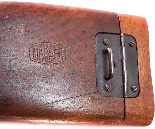

Here at least is an authentic image for comparison. Your logo looks pretty close. It's just that wood that looks stained!

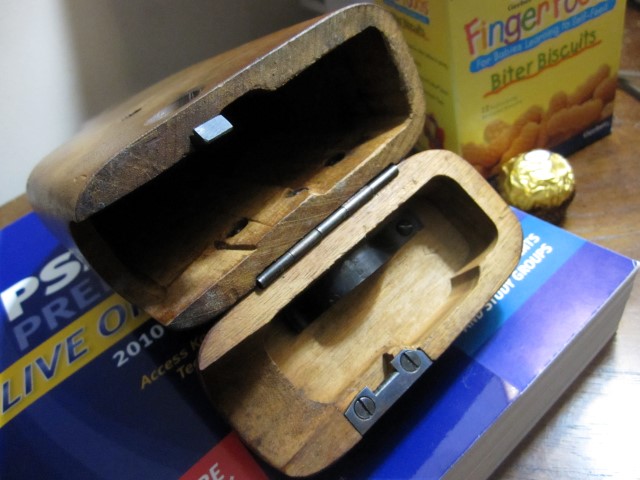

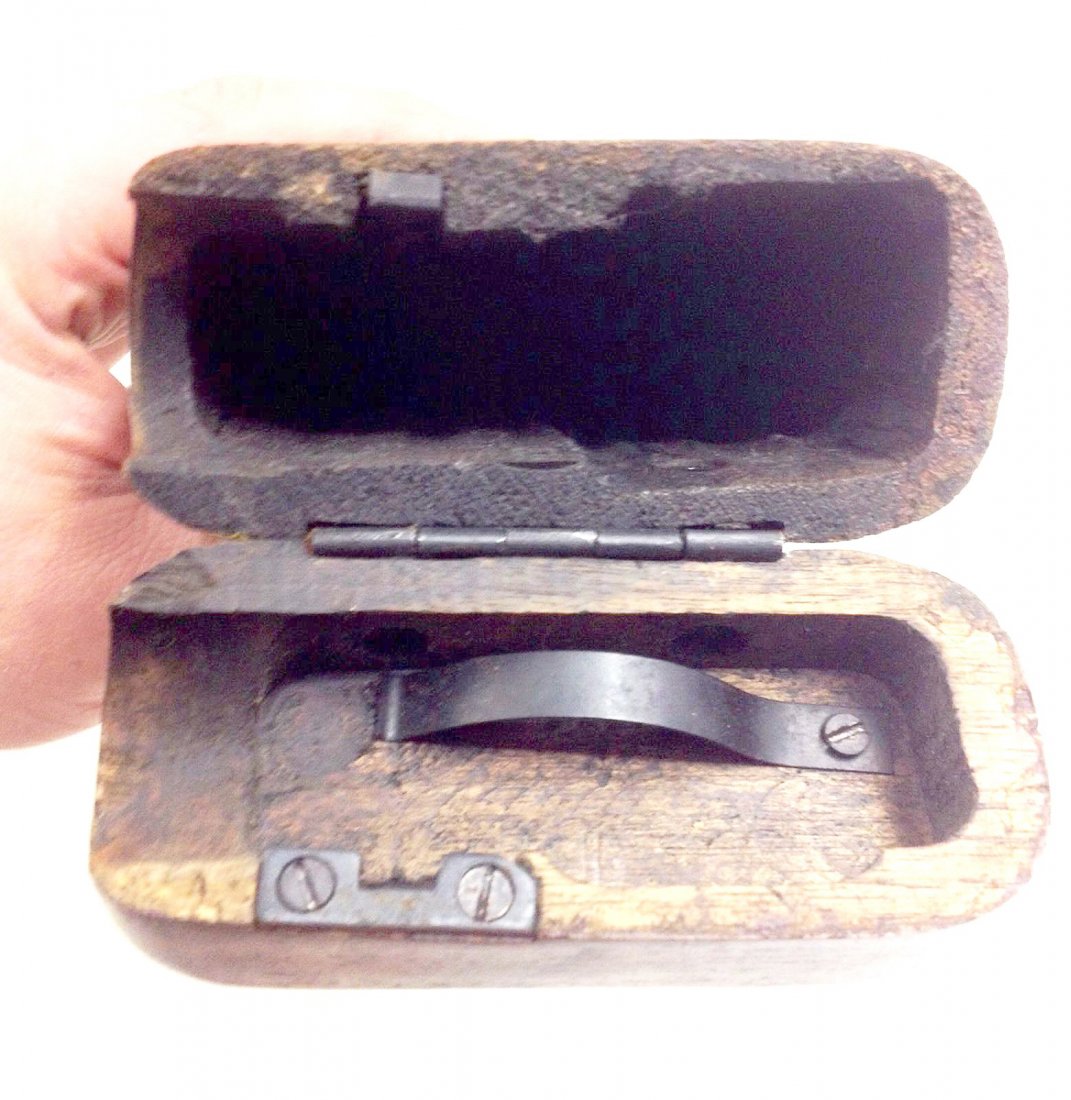

Here is a pic of the lid. I had to manipulate it a bit.......it was quite dark. still is in a way.
Michael D. Berk
SFC, USA Ret.
berkmberk1 is offline   Reply With Quote
Unread 11-14-2014, 08:52 AM   #12
Your photos of the interior clinches it for me. No Mauser product would have ever left the factory with such crude wood routing and lack of polish/finish to the wood edges. This is Pakistani or Asian junk.

Your spring in the lid looks correct, for a Chinese copy, which I believe your stock to be. th

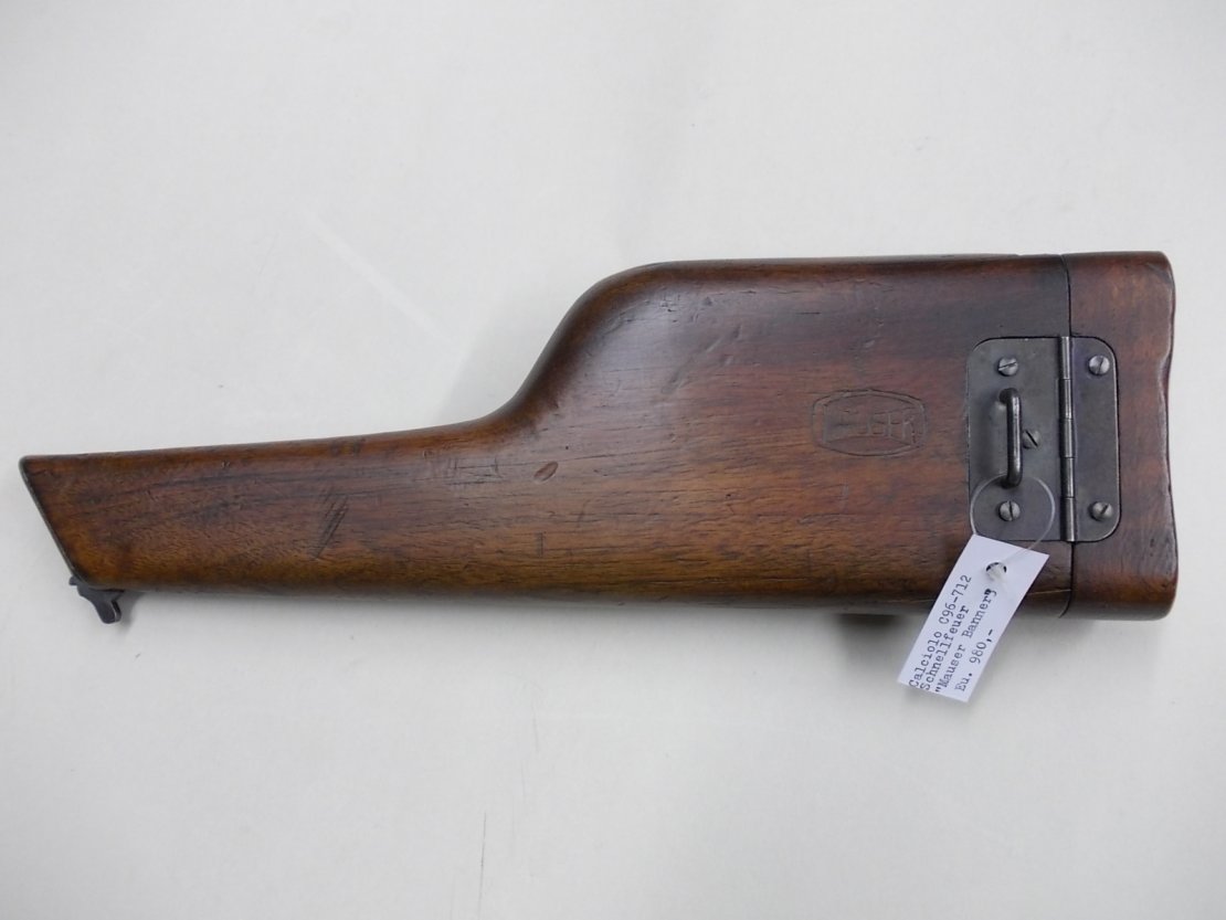

Mauser's wood cut work is much better. Don't have 1930 stock at hand, but got a Schnell one, it's also "bannered", and it's the same period, so it's similar to standard 1930 in quality.
Compare, then, know.
Another common problem with mass produced repro stock is this: it's made as a single product fitting all Mausers variations. So, its internal space is usually bigger than necessary. Put a gun inside, close the door, and shake it -- usually you can feel the gun is moving inside.
