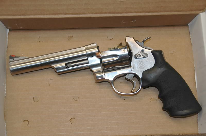

Default S&W .44 Magnum For Sale
Five shot custom; stainless steel; lightened cylinder.
New in box; only fired once.
Slight scratching from being dropped.
Target trigger; target hammer; six inch barrel; target front sight.
Cushioned neoprene grip.
Comes with ammunition.
Tight action.
Priced to sell.

My WAG is that the reloader used just a tad too much gunpowder. It may have been one of those "here hold my beer and watch this"!!
My WAG is a double-charge. Didn't check.

Looks more like wrong powder. If you use the right powder for .44 mag you can't make a double charge cause the case is full.
Anyways. my main comment is:
YIKES!

Guys, this is the new S&W "Open Top" commemorative!
It is a natural progression from their silly hammer/trigger lock system. It allows you to visually inspect to see if the chamber is loaded.

Again the greatest danger is getting your powders mixed up. Imagine you think your using 18 grs of VV n110 (fairly light load .44 Mag wise but a mangun load nonetheless) and you use instead 18 grs of VV n320.

This photo and other views of this revolver have been around on other gun forums for quite some time. The majority of folks vote for overcharge(double/triple) with a low loft fast powder that made critical mass when the primer ignited. A S&W N frame is a rugged revolver, but there are, obviously, limits to it's strength.
