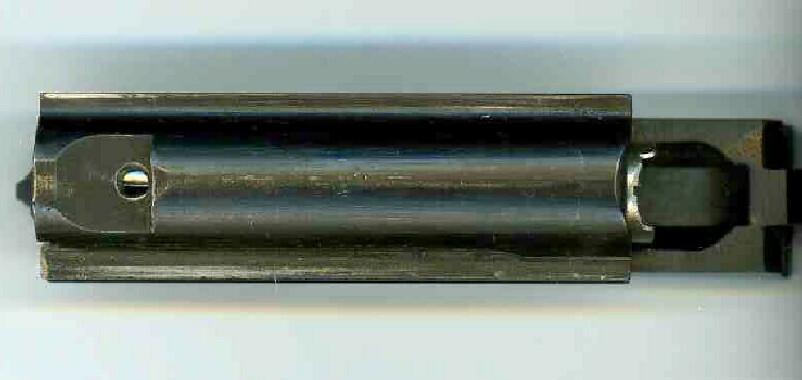

For pressure , in Finland or neighboring country, they do a hole under the breech : that works for this job !

Patrice, does this example have both a relief hole in the breech block and a relieved firing pin? I'm leaning toward pressure relief as the inspiration for the firing pin cuts, and see the relieved bolt as another option for doing the job. That would make longer operation without thorough cleaning an bonus--a not-necessarily-intended side-effect... if the pictured example is representative and does not have a relieved firing pin. If it properly has both, then the scale tips toward tolerance of debris! Since reference material recording such a change is missing--presumably forever--then we will never have a definitive answer.

The hole seems to be on most of the Finland lugers , contrat WWII
Patrice,
Thank you for posting that breechblock modification. I tried to remember what country performed that modification. I responded to a question about a Luger that had two holes drilled in the breechblock like a Borchardt. I thought it might function like the hole drilled in the breechblock for pressure relief that this was done by some country but couldn't remember which one.
