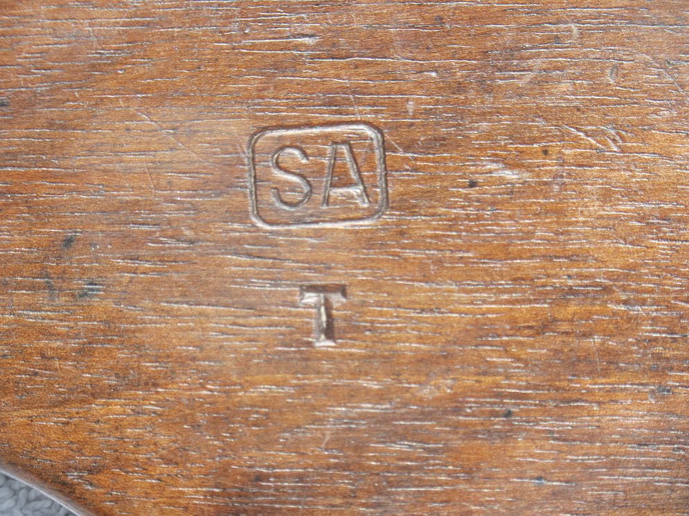

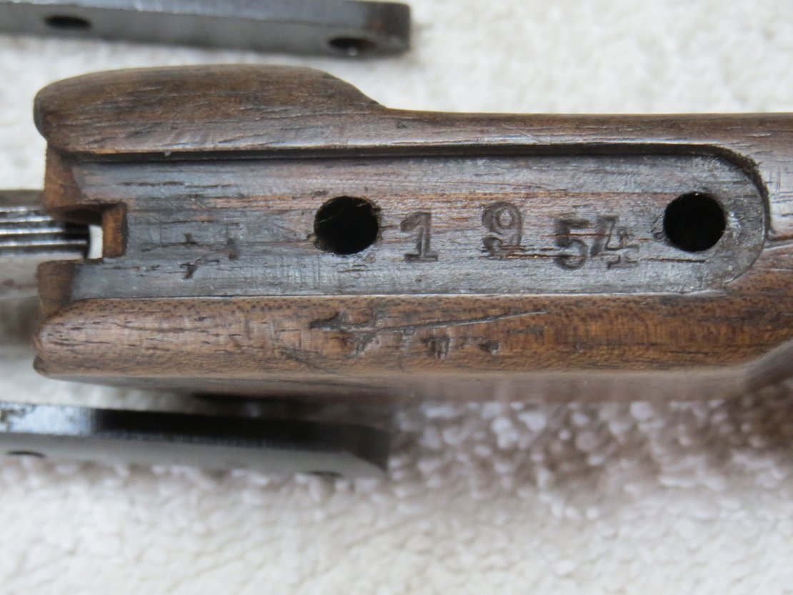

I have a Luger artillery board shoulder stock with the Finnish Army marking in the wood. The SA is a 1/4 inch square box over a block T. Both marks are machined or stamped into the wood. In one of the grooves cut into the wood for the lug attachment device is stamped 1954.
Is 1954 a date or serial number? Has anyone seen this type of stock marking?

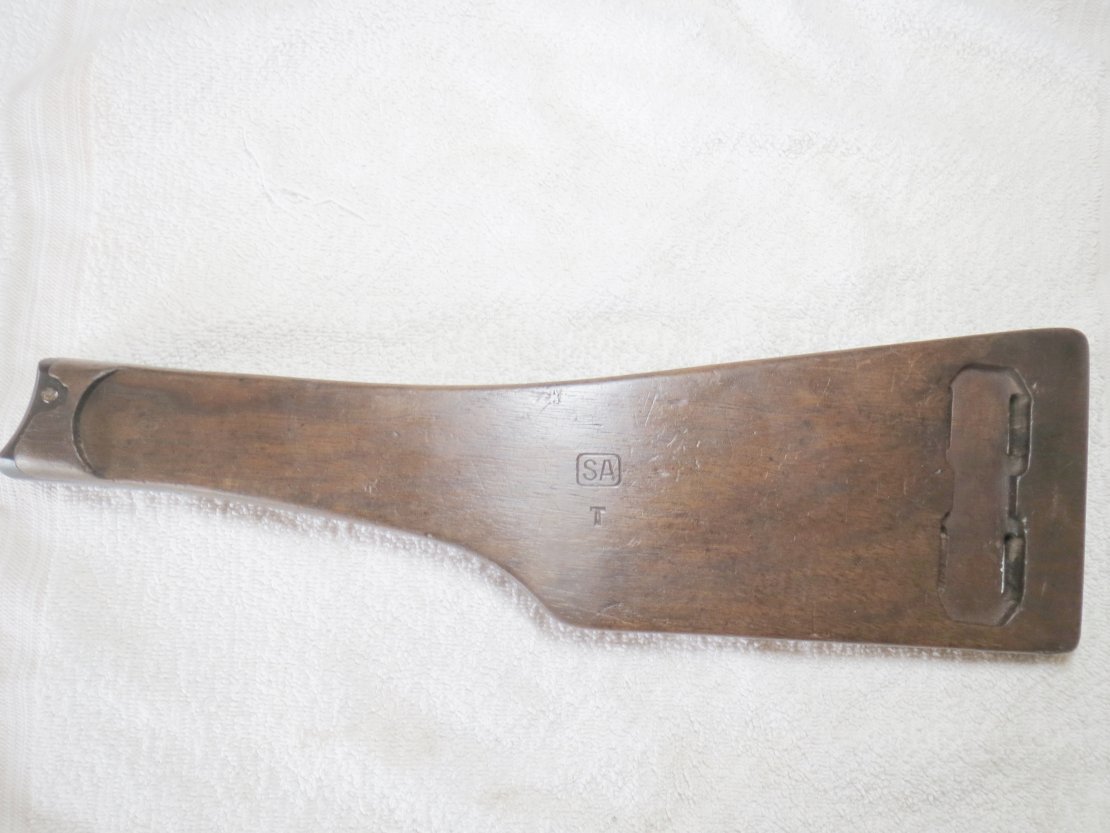

Here it is Jussi,
Seems to be a regular artillery slab stock with Finnish markings. As you can see the 1954 and Y mark are in the groove for the lug connection device. Any idea what the T represents below the SA on the slab side?

T=Talousvarikko. You could translate it as "the Maintenance Depot".

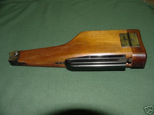

There were only some prototype and test shoulder stocks for the Lahti. To find a genuine is really hard.
Most moving around are repros. And even they are rare.

The stock-holster you have shown is very cool; but I was hoping that Dick had a Lahti board stock that he had no use for...So I could buy it from him and use it with an altered Luger artillery holster for my 'artillery Lahti'...
Making a curved attachment iron is outside my skill zone right now; I'm having a hard enough time making a straight one...

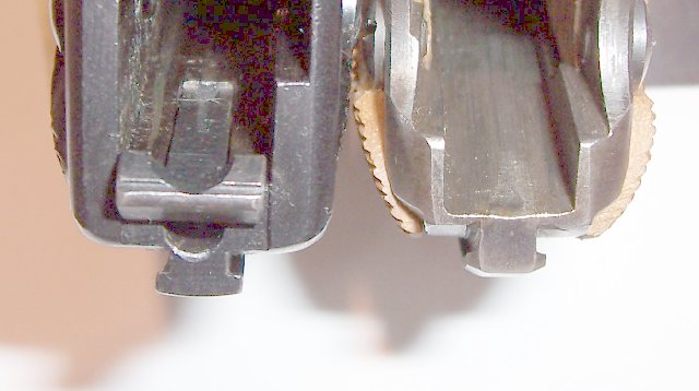

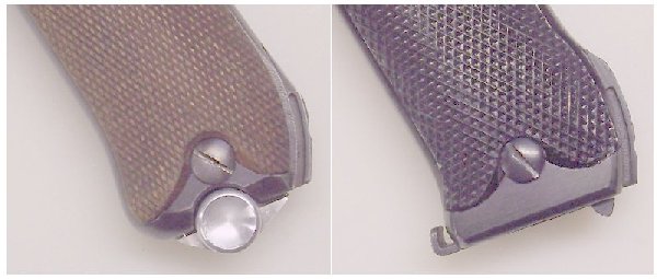

Here's a pic of the two gripframes...I don't have my verniers handy (I'm taking a motherboard to the PO) but except for the locking notch, the curve looks quite close...
I've seen pics of Lugers with attached board stocks that were at a Gawd-awful angle; I'm guessing that the stock was a Finnish board stock, locked at the Luger notch...Lugers & Lahtis are the only gripframes with external "T" lugs...
I have a Mauser stock iron that I'm using as a design aid, but I really need to find a Luger repro stock iron...

Thank you for the pictures. The similarity of the mounting lugs are amazing. The lug lock groove appears to be slightly different. Will a Luger attachment slip onto a Lahti lug?

Dick -
I don't have either attaching iron, but I did just take a couple measurements with my verniers, and I believe a Luger stock iron will fit a Lahti (or can be 'fitted') but a Lahti stock iron won't fit a Luger.
The big difference in dimensions is in the base of the "T" - The Luger is wider. The Luger iron might be a 'sloppier' fit on the Lahti (and the locking notch is in the wrong place) but I think it could be fit. I've been told that Luger attaching iron often needs 'fitting' and repros even more so, but 'fitting' a Luger iron to a Lahti shouldn't be any more work.
