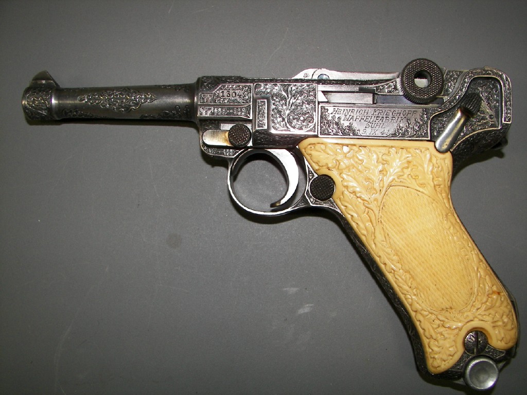

As the gentlemen have stated, it's an Erfurt. For comparison, here are some photos of an engraved Krieghoff.

Nice Germanic-style engraving, but probably not done in Germany and at a later date. The engraving is well executed but far from master engraver level. Ed Tinker's valuation is probably as close as you will get (but more in the $1000 to $2000 range).

Dave, welcome to the forum. That is a very attractive Erfurt Luger. And all matching including the magazine. Sweet...
Now George's engraved Krieghoff... That is something else entirely!
I am not much for engraved guns, but that Krieghoff is a masterwork.
Thank you for posting it, George...
George,
What is the significance of the "9. IX. 41" date on the Krieghoff you pictured?
Unread 06-16-2014, 05:11 PM   #11
Doug, the pistol was bought from Doug Smith by Tom Armstrong. It is one of a cased set that belonged to Gauleiter Bohle who was in control of the foreign office in National Socialist Germany. I have not been able to come up with any significance to the date 9 November 1941 either in the calendar of National Socialist Germany or a brief biography of Bohle.
Unread 06-16-2014, 07:00 PM   #12
Thanks, George! A fascinating thing to further research!
