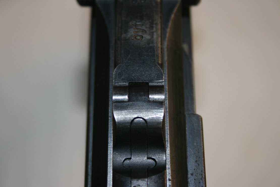

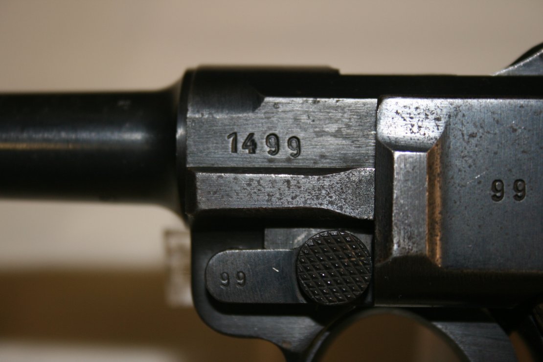

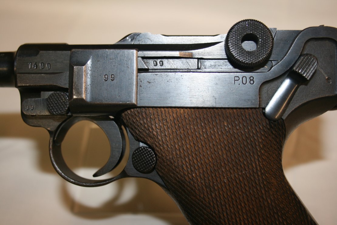

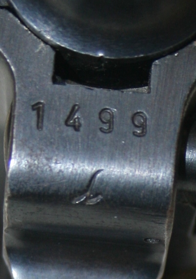

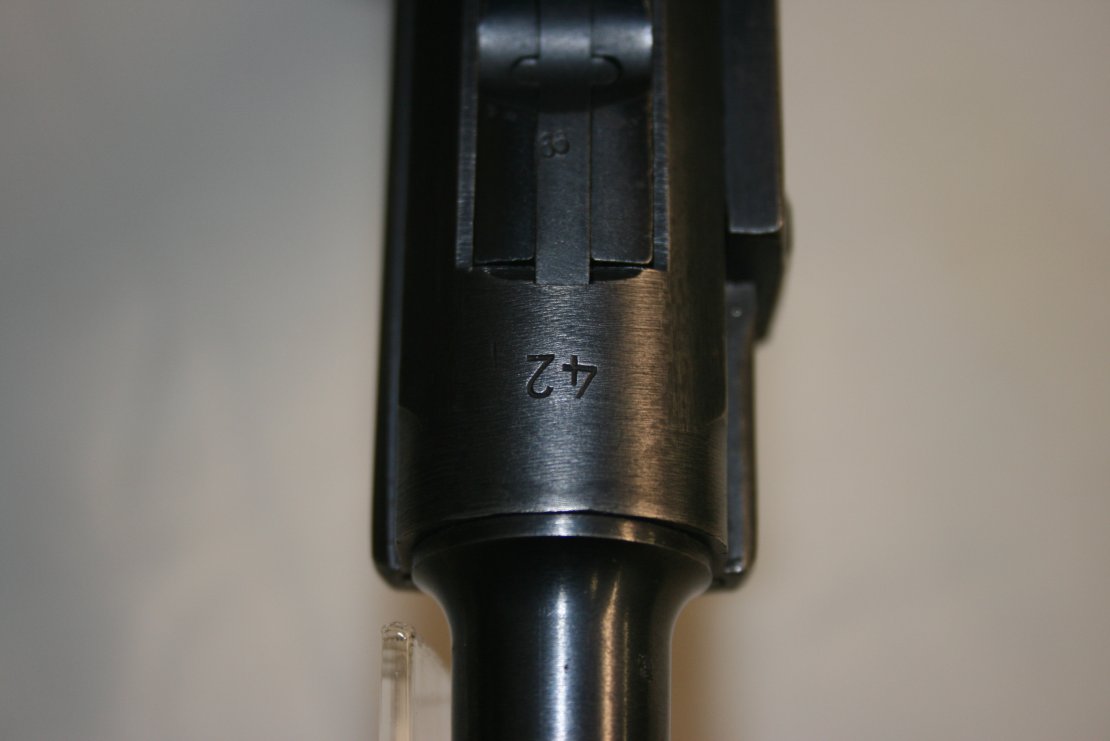

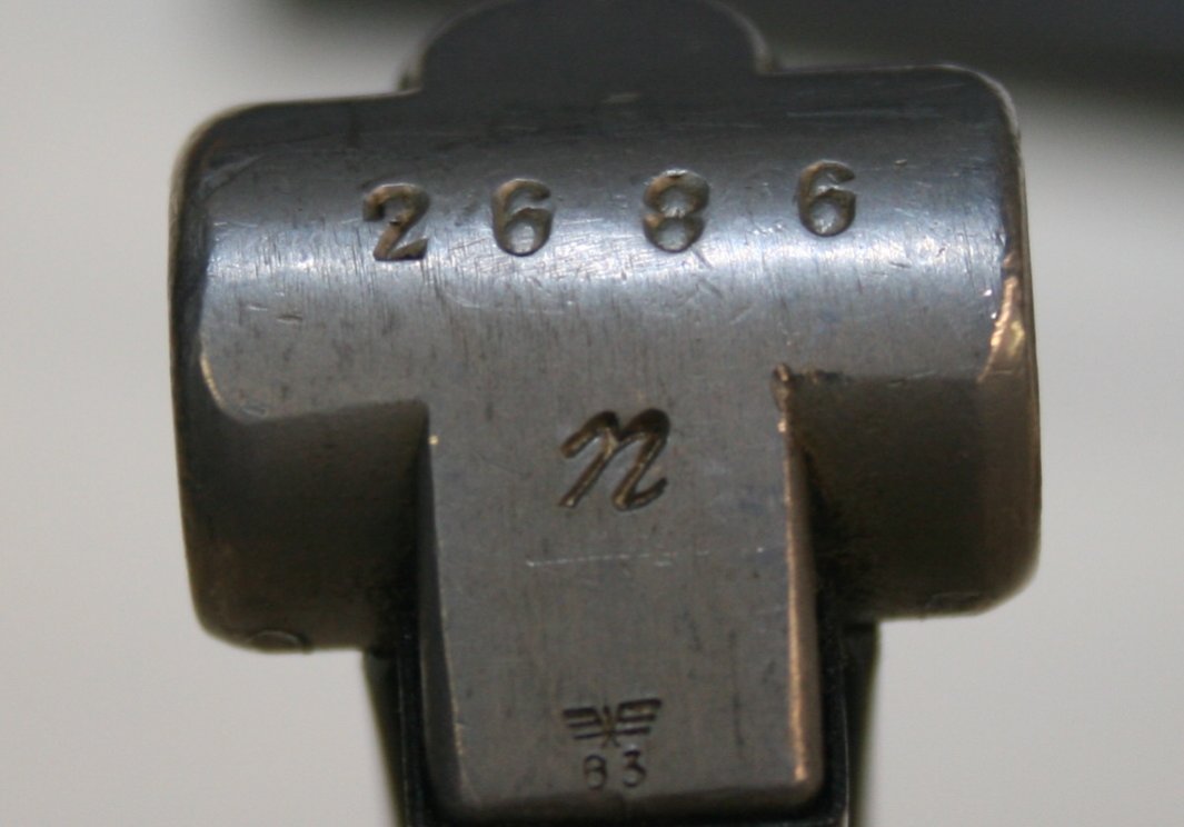

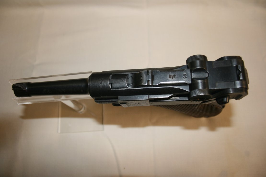

Hello, I am a new owner of a Luger P-08 and would like to know if you could help me with any information on what I feel is a really clean handgun.
Thank you.

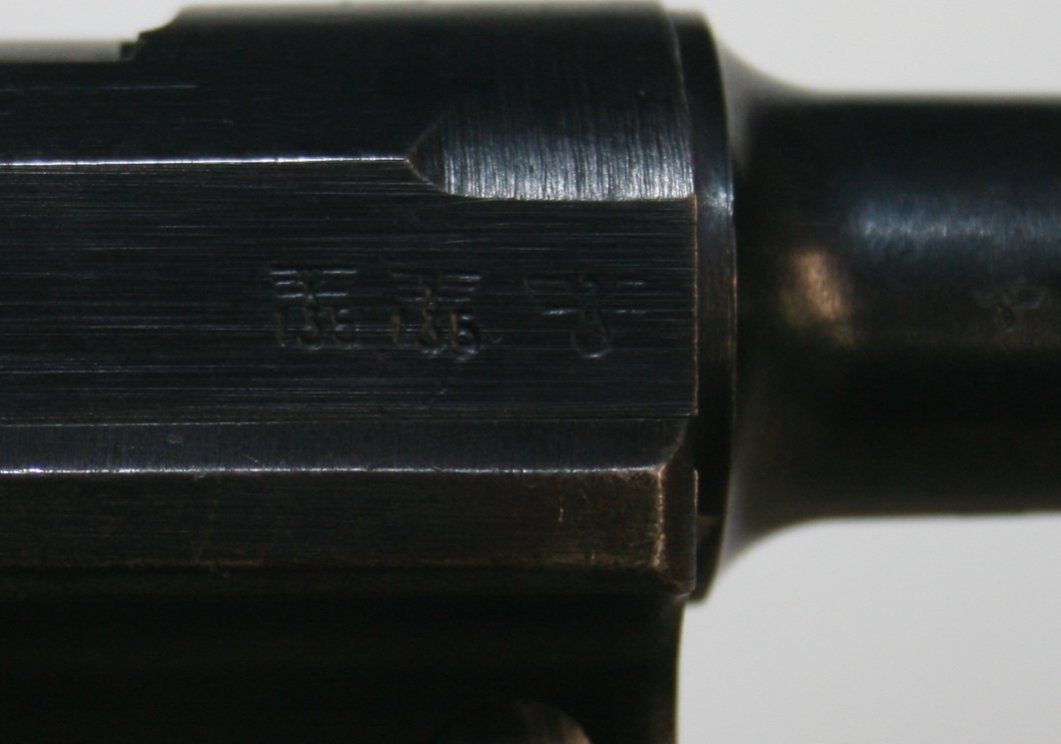

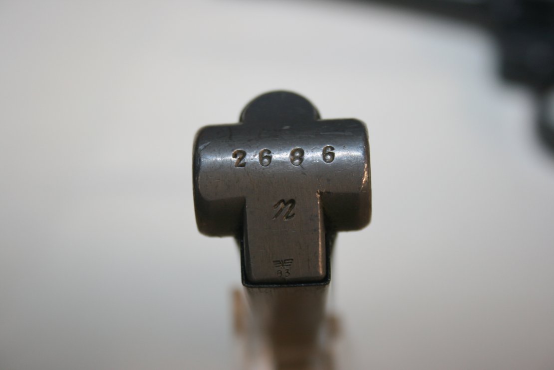

Looks like a nice, unmolested 1942 German military Mauser (BYF) Luger, one of the latter ones made prior to the switch to the P-38. (Others can tell you better just how close to the end it is.) From what I can see it is all matching except the magazine, which is very common. A very nice gun and certainly a "keeper".
I'm giving you the general stuff. Anything specific you want to know?
Also, a light lube will help on the freckling.

Thanks, just picked up today and took pictures before I disassembled and cleaned.

It appears to be in very nice condition. When you break it down for cleaning and lube, you will be able to check all of the numbers "inside". Be VERY careful with removing the LEFT grip.....refer to the sticky. Enjoy!!

Thanks, had a chance to do a good clean job and found all numbers matching, grips seem dry, gun was in a storage locker for more than 30 years before I bought it. Any suggestions on wood grips? Leave as is or is there something I can use to rehydrate without changing value?
