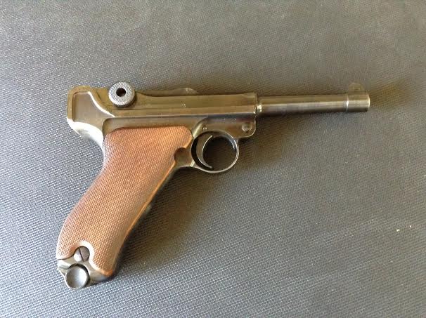

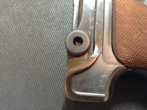

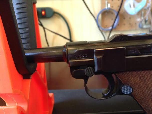

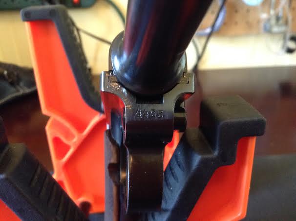

Finally found my first luger pistol and this site was recommended as the place to go. I am not a "collector" but I wanted a "shooter" to take to the range. I believe this is a P08 DWM 'Bulgarian Contract' luger that is obviously a mixmaster and has been scrubbed/polished. You can barely see the outline of the Bulgarian crest on the toggle. 4 digit s/n 4433. There are holes for lanyard ring and safety is reversed. I ran about 40 rds of 9mm thru it at the range this morning, with barely a hickup. I have posted on a couple of site trying to find the year of mfg? If is it possible to estimate the year I would greatly appreciate it.

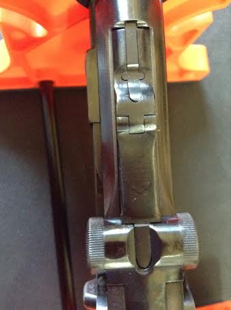

Your frame and toggle assy appear to be from a M1908 Bulgarian contract. The receiver however would have originally been marked DWM on top of the chamber, not seriallized on the left side, but Bulgarian proofed on the right side. TH

I have one of these, a Md 1908 Bulgarian Luger. Mine has been similarly sanitized. The only remaining markings are the serial numbers and the Cyrillic marking on the extractor. The frame and small parts are one set of serial numbers while the receiver and toggle train are another set. The barrel is not marked. In the proper light the shadow of the Bulgarian logo can be seen.
I bought mine as a shooter and have had excellent service. Years ago when I first acquired mine, Ralph Shattuck told me that these guns were sanitized by the Russians for sale and foreign aid around the world.

Ralph was wrong...the Russians didn't do it...It was the good old USA. At the time these Bulgarian Lugers were being imported, Bulgaria was a Communist country so commerce with them was illegal. Importers removed "country of origin" markings to salvage the parts.

if the safety lever two digit serial does not match the frame / receiver last two digits I think it is likely the frame and receiver were renumbered as part of the scrubbing done at the time of importation
it is not unusual that a new barrel was installed when scrubbed
nice find and excellent for shooter !
these bulgarians have many potential battle experiences - lots of strife in that area before 1900-20

Surely it has ben heavily refurbished, but I think it's somehow still visible he Bulgarian crest on the toggle, if I'm not wrong.

I really appreciate your responses and your help. So the receiver was sanitized/scrubbed and could have been renumbered or it may be just a mismatched receiver and frame from a later DWM. Either way all the parts are in good working order and the pistol functions better than my expectations.
