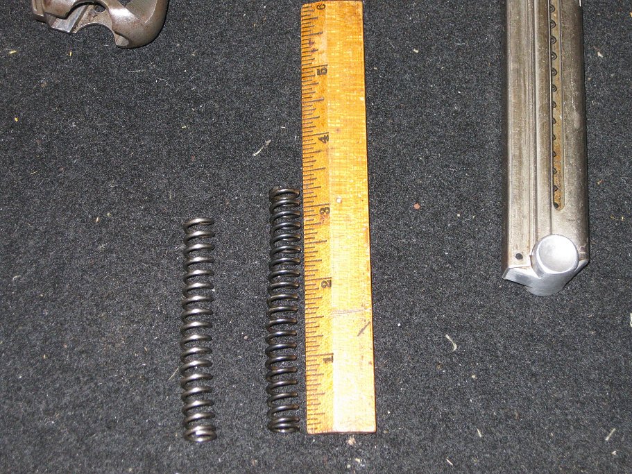

The modified #38 Wolff spring is on the left, the original on the right. Should I cut down the #36 spring? Or is the height difference not going to be a problem?!
-Chris
Curss,
The German name for the recoil spring is the "closing spring".
After your modifications, make sure there is still enough "spring" available to adequately "close" the toggle, putting it into full battery.
Also interesting is the fact that the new spring seems to be made of thicker wire than the original.

How would you check if its in full battery?

The breech blockade will be all the way forward.

Ok, seems like its all the way forward when released. Maybe I'll trim the #36 spring just for the extra "spring" just to be sure. And it gives me a good excuse to get more ammo!
I installed other springs that were full length and there was no difference in the breech block spacing on any of them, including the modified spring.

To be at full battery, the toggle must be, firmly, all of the way down, and; thus, the breach block all of the way forward.
For proper function, you will need: a proper recoil spring; a proper magazine spring; a proper extractor spring and a properly handloaded cartridge, including proper O.A.L..
Good luck with your project!!!
