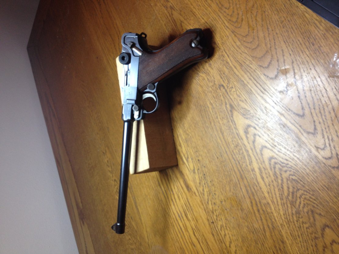

As a new user to this forum, I would like to express my thanks for the information I have acquired. Please review my note and pictures, because this LP08 seems to be unusual. Please help me identify and value this inheritance piece.

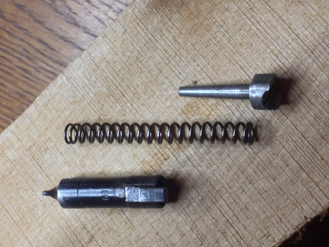

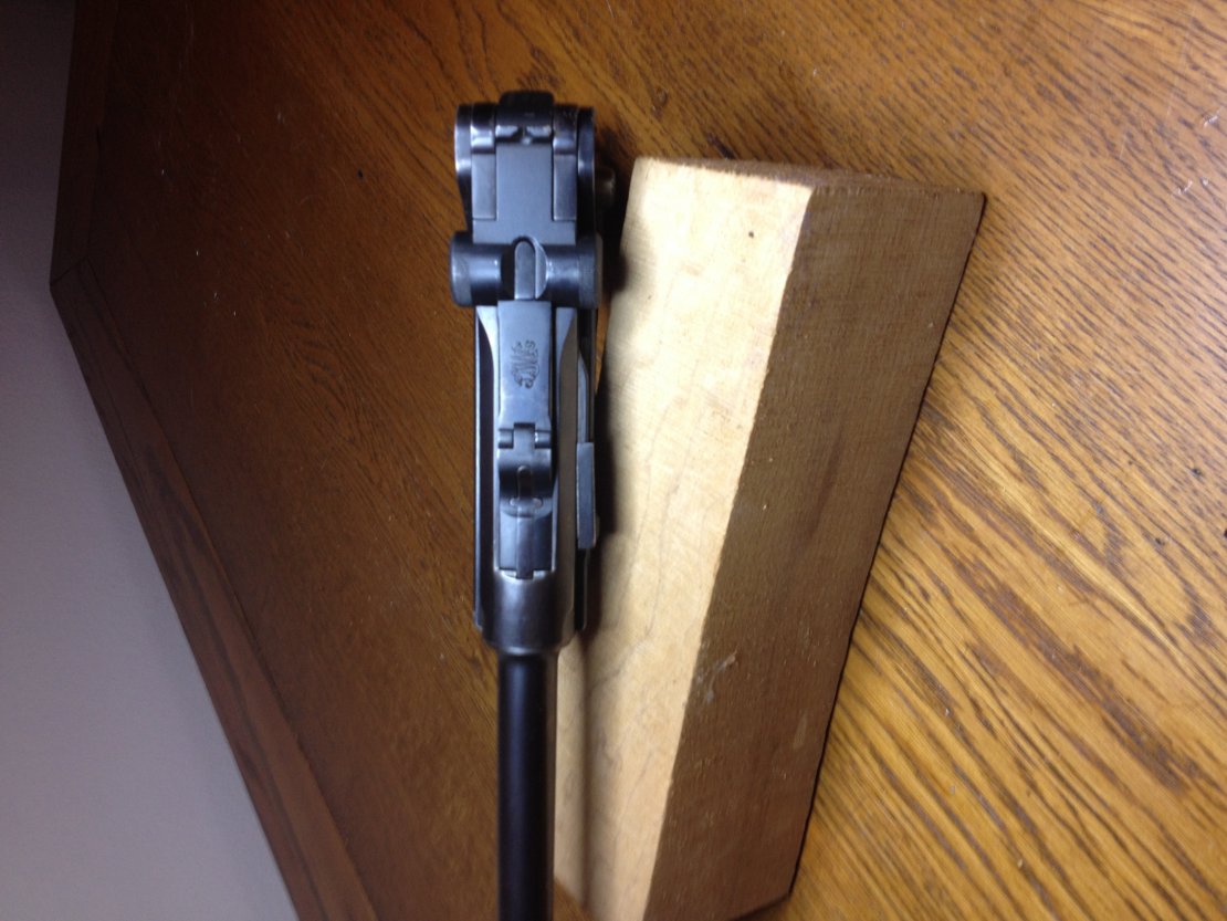

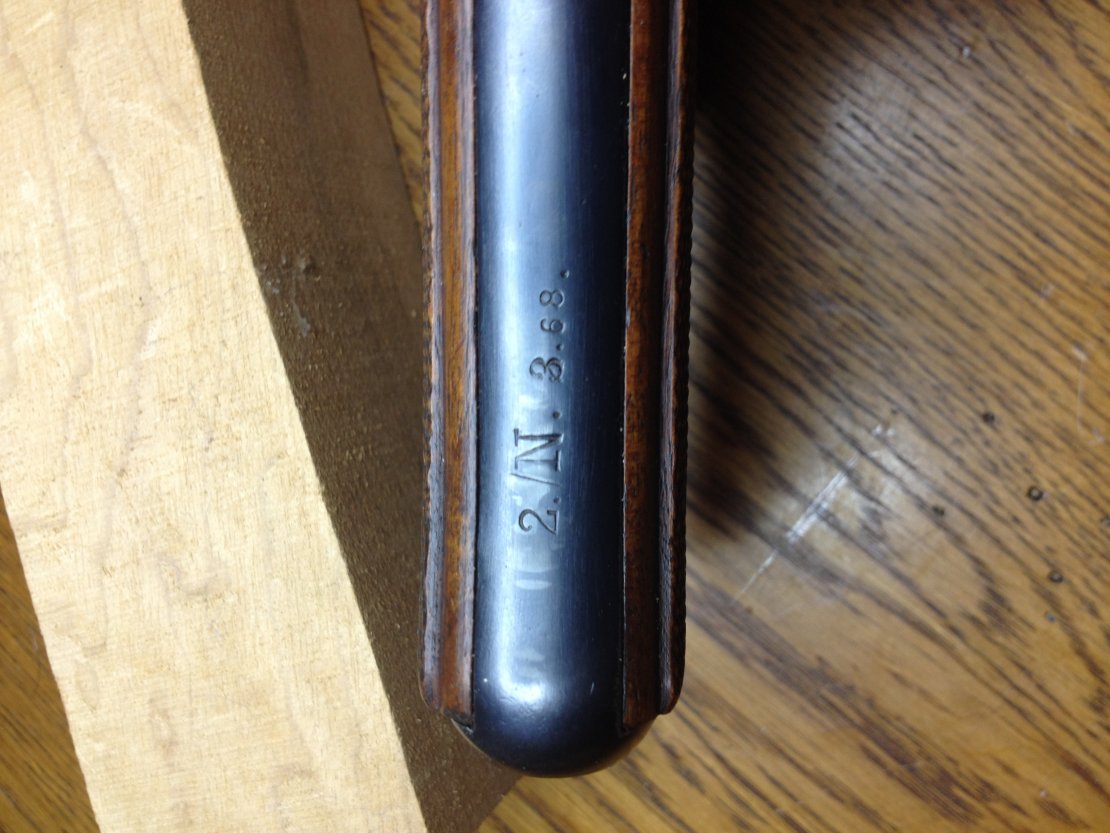

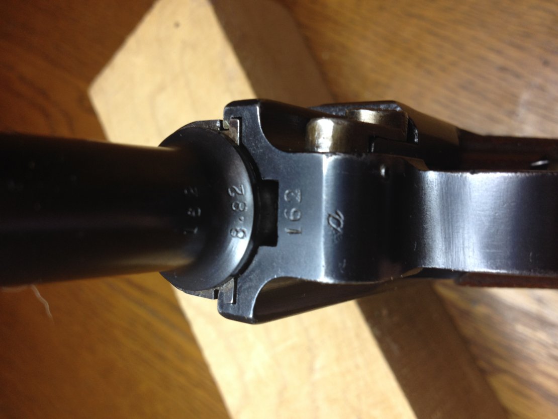

This 8 inch barrel does not have the adjustable sight. Makers mark is only on the receiver, not on the barrel. The chamber is blank on top, side, and stop lug. No Military or Commercial proof marks anywhere. (2./N.3.68) Military issue mark on front strap of frame. DWM on front toggle link. (162 suffix a) serial number on frame. 162 and 8.82 on barrel. 62 on; takedown lever, trigger side plate, trigger, safety lever (GESICHERT), safety bar, sear bar, rear toggle link, breechblock, hold open latch. Fireing pin S/N=66. Extractor has GELADEN on the side, but S/N=90 is on the bottom, not the top.
The following items are straw colored; takedown lever, trigger, safety lever, safety bar, hold open latch, ejector.

First, welcome to the forum. Your pistol is a former DWM manufactured P.08 military gun that has been privately customized by the installation of a long barrel. It has been refinished (because the interior of the frame is also blued, and for the vintage of your gun, it should be in the white, as the gun was originally rust blued by hand). Being refinished may account for the lack of proof marks that may have been buffed off during the reblue process.

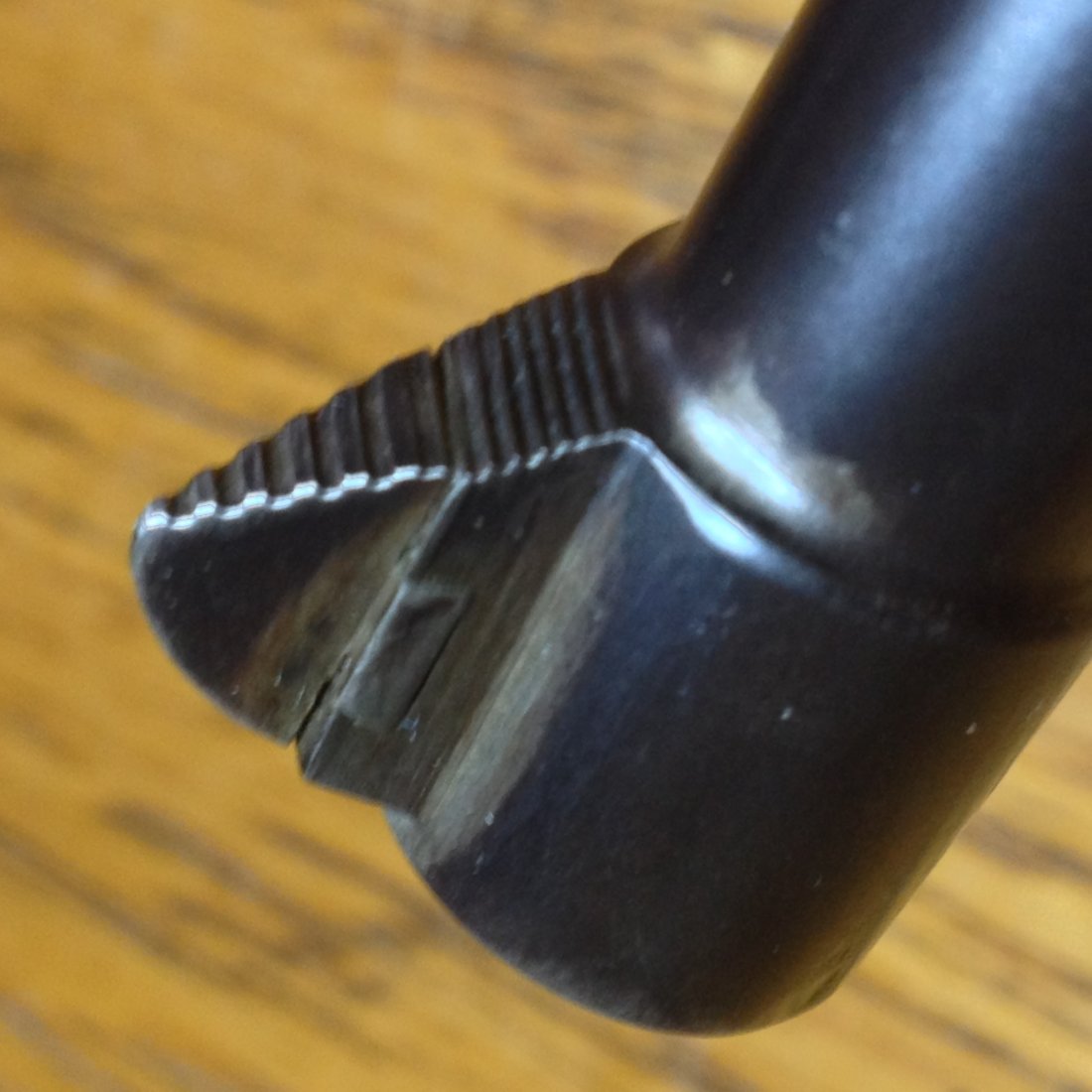

The front sight and sight base are very unusual, but readily apparent as a custom effort. The holdopen is chipped, and I would obtain a reproduction or non-matching part to use for actual firing.
You pistol has markings stamped into the front grip strap, these are Unit numbers. Other may be able to tell you which unit these marks represent. The grips are likely to be Swiss or Italian reproductions in origin.
It should make a fine shooter, but because of the modifications, it is a shooter class gun and not a collectible.
Do let us know how it shoots.

barrel - really nice length and profile - even numbered same serial and also the diameter marking - $200

possible that the extractor and firing pin are different numbers to avoid breakage of original like numbered parts - maybe your prior owner would have those parts somewhere
and maybe the firing pin was selected as a good match to the firing system parts - since overall looks like a case where the mechanic was very luger aware

The unit mark translates to Reichswehr Company 2 / Nachrichtenabteilung 3 ( Signal Corps Detachment 3) weapon #68
The serial number suffix is a. The donor pistol may have been a 1920 or 1921 new production for the 10,000 Lugers contracted by the Reichsheer. All of which are in the no suffix, a and b suffix range.
