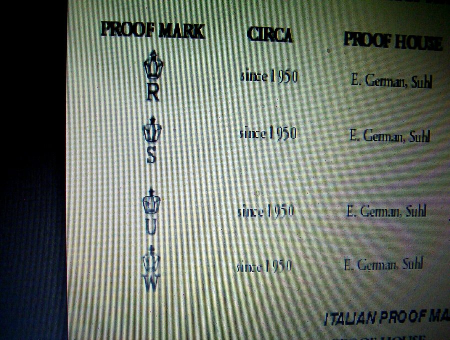

My principle question is about the BARREL It does not have the original Eagle on the right-rear, but a stamp like the ones in the accompanying proof example I have attached...located on the BOTTOM rear of the barrel. They are East German proofs from what I have surmised , and the letter below the crest is an "N". This code follows: "E.C.C.S.A PEN SA"
It looks just like a Luger barrel, but upon close inspection with a magnifying glass, it's obvious it is not the original barrel.
Just wondering if my suspicions are correct..? An East German refurb with a new barrel and new mags..? And the accompanying proof chart indicates early 1950's. (Actually...1950) The chart says.."E. German/Suhl" I suppose they were the refurbisher, maybe this Luger was used in East Germany...police..?

You more than likely have what collectors refer to as a "VoPo" Luger, or an East German "Volks Polizei" pistol. The two magazines were force matched to the pistol at the time it was refurbished. The barrel was changed out due to wear or damage.
The E.C.C.S.A PEN SA is the US importer's mark for a company in Pennsylvania. There is a "U" in front of that "SA", if you look closely.

Cross Roads Gun Shop, Pennsauken, New Jersey, IIRC...
Where did you find that nice proof chart??? All the proofs printed so professionally...I wouldn't mind hanging a chart like that in my shop...
Crown over N is a commercial proof, again IIRC...VoPo's could have re-barreled it with a commercial barrel...

Minor correction to all the good info Doug (alanint) has provided... "E.C.C.S.A PEN SA"
was not in Pennsylvania... the ECCSA was the initials for the company name, which I no longer remember, but I have seen reported on other forums that it was the importer name for the Cross Roads Gun Shop.
The PEN SA portion of the stamp (the space between PEN and SA was probably unintentional during the stamping process)... was a shortened version of PENNSAUKEN, NJ... the actual location for the importer.

Not sure why, but the chart shown is available for download from PIA.
http://www.phoenixinvestmentarms.com...proofmarks.pdf
