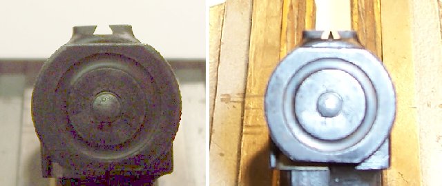

None of the articles I've read mention the rear sight on the Type 14. To my mind, it is several orders of magnitude better than the Luger. To those who don't have one, the front sight is similar to the Luger (a pyramid) but unlike the Luger V-notch rear sight, it is a dovetail...So you see space around the entire front sight when sighting it...
I'll try to get a pic, if I can... Here we go -

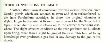

I browse through Nonte's Pistolsmithing book frequently, and he had this to say about caliber conversions on the 8mm Nambu...(scan attached)...
No mention about boltface or extractor modifications...So I stripped my bolt down [removed firing pin], stuck a couple Fiocchi 7.65 Luger cartridges in the mag, and cycled it a couple times...Fed & extracted OK...
Further examination convinced me that if the extractor was removed, I could measure headspace from the ejection port...
I'm not contemplating converting to 7.65mm or 9mm in the near future, but barrel replacement looks do-able...For caliber change purposes...
You mean cutting the barrel off and boring/threading the receiver for a new one? Makes me wonder if a Luger barrel can be retrofitted, an artillery Nambu would make a very interesting conversation piece, or maybe even a carbine...

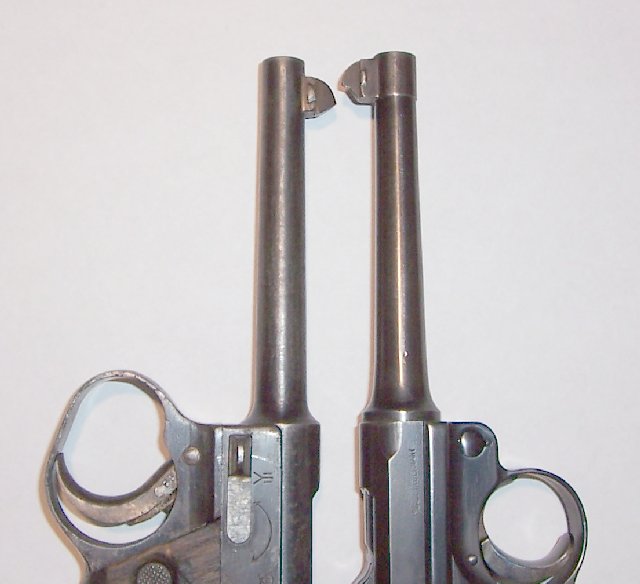

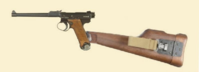

Here's a pic showing the external barrels, the Luger is the 120mm 'pencil' 7.65 cal barrel...Almost exactly alike...The flange/shoulder could be turned off or left...
Unread 01-30-2014, 02:25 PM   #93
OK, I took some Q&D measurements...The Luger receiver is .941" minor dia; the Nambu is .858"; the Luger barrel thread is .714" OD...That leaves a .113" wall on the Luger receiver, and if you were to tap the Nambu receiver to Luger barrel thread size you'd get a .072" wall...That's kind of thin, I think...
The Luger barrel/breechface is .628", I'd re-thread the Luger barrel (or make a new barrel) to 5/8" x 18 and saw/tap the Nambu receiver to the same thread...The Nambu has almost no feed ramp, so that wouldn't be a problem...
I'm thinking 7.65 cal...If you did 9mm and wanted a similar profile, you'd need to thin it down quite a bit...Like Ithacaartist did with his 120mm barrel...

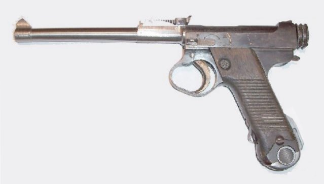

An Artillery Nambu??? I dunno...
OK, tell you what...There was a Type 14 barrel on GB last week for $76 start; nobody bid on it...It's relisted; I put in a bid today; if I win, I'll sacrifice it for a longer/different caliber barrel...

Rich,
That picture is exactly what I had envisioned. The ultimate bastard that will turn both heads and stomachs.
It sure sounds like the Nambu receiver will be a bit thin, but you might be able to get away with it if you re-tread it like you described. Just keep in mind that the steel quality in the late war versions is said to be a bit iffy. I don't know if that's true, but I wouldn't take any chances.

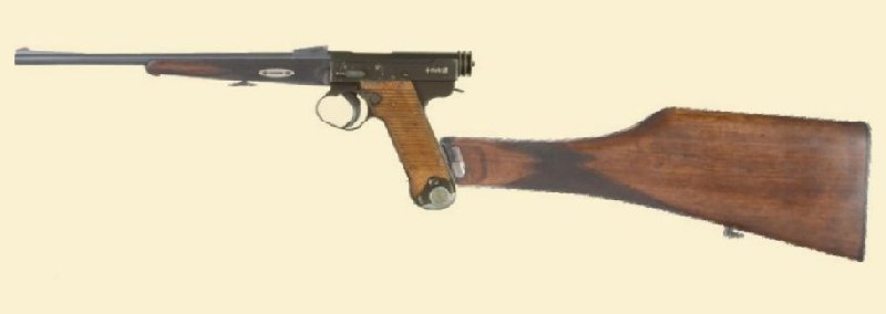

Rich,
You sure??? I'm thinking, maybe we can get Eugene to shelve Ed's Luger carbine and do a Nambu carbine instead...

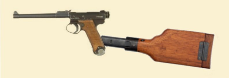

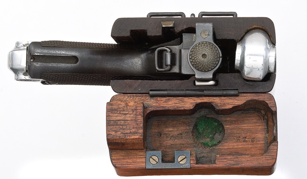

Great discussion on the Nambu!
Here is a couple of pics of a real stocked Nambu
Its the early Papa Nambu. Notice the holder in the wood stock for a spare magazine! Never realized that before. Pretty cool and very rare. Wish I had one.
