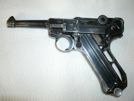

Well, thanks for the thoughts, but if I buy another Luger is another issue I guess. This one has sentimental value and I would like it to be "all that it can be". If that means it cannot be shot, I will still install the two missing pieces so the action functions when handled, and that's fine. Not sure they will help much as they show a Luger with a hole drilled through the barrel, but here goes:

Mainspring & mainspring guide missing...that's kind of odd; if you were going to make it 'unfireable' then the firing pin, spring, and guide would be more accessible and reasonable to remove...
But I suppose you could replace them and have an 'operable' pistol...Now, the barrel...yes, it's [fairly] easy to replace...But then it's not matching, but should be 'fireable'...
Hmmmm...Could you shoot it with the holes in the barrel??? that's an interesting question...gas would vent and probably drop bullet velocity/travel down considerably...Possibly even 'squib' [bullet never leaves barrel]...And there would be lots of debris from burning powder, maybe some bullet jacket slivers, vent out the holes...Dangerous to anybody to the side...But revolvers function with openings before the barrel, so it's possible...
Strange way to demil a Luger...

Another possibility is to have the holes welded back full. If the weld stops short of the internal lands and grooves, it would shoot as well as a revolver, anyway, without a path for extranea to escape the barrel to the sides. One could theoretically go all the way with the weld, but then take care that the lands and grooves are re-established properly. One might also have the existing barrel bored out and sleeved, then fill with weld down to the outsidde of the liner. Either of the last two methods would retain the matching number state of the barrel. It might need a little touch-up of the finish in the area repaired.

Welding is an idea; the lands & grooves could be left untouched by putting a copper rod down the barrel and then TIG/MIG welding it (the weld won't adhere to copper). But then you need to dress it and re-blue it...
A new barrel is probably the best idea, if you don't care about matching. I've had the thought that 'pulls' [removed used barrels] should be right at $100, but I paid more than that for one a few weeks back and looking at GB/eBay I'm seeing up to $200...

I would swap the barrel, keep the old barrel and then replace the parts - then have it checked by a gunsmith who knows lugers to see if they can get it firing safely - personally I would think yes. I would not have just anybody swap out a luger barrel unless they have done it before...
sounds like a easy way to have made it seem unfireable by someone - you see some guns used to have holes in the barrel to show they were demilled
this suggestion is strongly and definitely NOT recommended.
If you want to shoot this one, get the missing parts AND the barrel replaced. There are plenty of folks on this forum who have the tools and expertise to change the barrel. Changing a Luger barrel is not a job for your local gunsmith who doesn't know much about Lugers. You will likely end up with a twisted upper receiver. When you are ready to change the barrel, post a request here, and someone who is knowledgeable and tooled for the job will help you.

My guess is that the holes were drilled to be able to place and weld a slightly smaller diameter bar across the bore so that you could not chamber a round. The positioning of the holes would tend to bear this out. For some reason, it was never done.

Another vote for: Do not repair the damaged barrel. Replace it. Acquire the missing parts and you should end up with a nice shooter and family heirloom.
An experienced Luger gunsmith should also take a good look over the rest of the Luger to make sure that there hasn't been further damage. It's likely that the hole is a result of an amateur attempt to demil the gun. Perhaps a family member that didn't like "something dangerous" being around the house. Of course, this created something more dangerous... at least until properly repaired.

Very simply, to me it looks like a "homemade" deactivation.
In any case I would not weld back anything, keep as it is, full stop.

Yes, not for the faint of heart, and probably cost-prohibitive compared to the swap. Numbers match, but it's already a shooter due to this issue. Best case, restoring the original barrel, would result in a restored shooter, but a shooter nonetheless. The approach I detailed is extreme, and fraught with liability issues for anyone who would/could do it professionally. This is something a qualified tech/smith might do for a personal pistol, but perhaps too risky a job otherwise take on.
Sorry, didn't man to take suggestions into la-la land, but I'm happiest when no stone has been left un-turned. Didn't want to leave out a feasible possibility...but, bottom line, it's best to consider the caveats!

The barrel is ruint and not fixable. Replace it and the other parts and you got a nice pistol.
I have seen guns DEWATTED by drilling and putting a rod in place as mentioned.
You never know what former some former owner got inspired over to do this.
