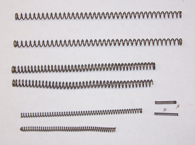

My Wolff spring kit came today...First pic...
I trial fitted the recoil springs, mag release spring, and the firing pin spring. But first I compared them to my old springs...Second pic...(New springs are above old ones)...
After racking the bolt 20+ times, i took the Wolff recoil springs out and inspected them...They had 'bent' just like the old springs...
I counted the coils...The new springs have 38 coils; the old ones had 42...The new springs measure .026" wire dia; the old ones are .028"...
This is the kit with the 'standard' weight recoil springs...
So the old ones are thicker wire and have more coils...
I'm disappointed...

Thanks: 777
Thanked 527 Times in 290 Posts
In Wolff's defense - the material the springs are made of also is a factor. Whether or not its "enough" of a factor, I dunno! I should mic/count my old springs to see if they're the same as your old springs - Goddess only knows where either of them came from...

Yes indeed. There is also no way to know if I don't already have a Wolff 5% stronger spring set...And ordered a 'softer' set to replace them...
You can also see that one coil of one of my recoil springs has been clipped off...
I plan on ordering the '2 extra power recoil springs' when I place my next spring order...

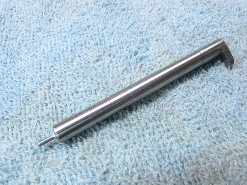

Just got a new/repro firing pin from Don Schlickman in today's mail...Don doesn't have a web site but he can send you his price list...
New pin looks right, fits & works great!
I've read posts/articles over the years about the Type 14 firing pin breaking...(Don also repairs original firing pins)...Mine is still intact so I'll store it away where it's safe...

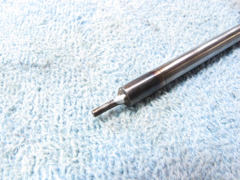

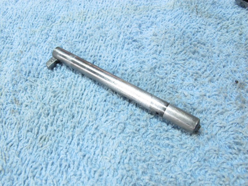

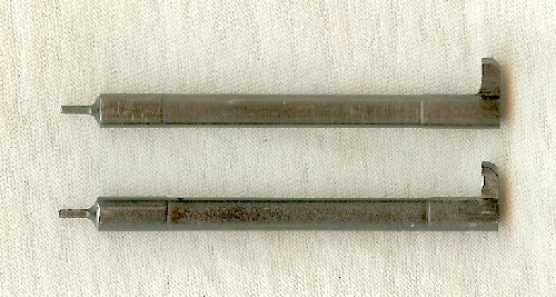

The last T14 I bought had a broken firing pin, so I retipped it myself. It was fairly straightforward, I faced it, drilled it and silver soldered a slightly oversized tip in the hole, then I turned it to the correct diameter and trimmed to the correct length. It's an easy procedure, the only thing you need to watch is the depth of the hole. You don't want to go all the way through, you only need to drill deep enough to hold the tip straight while you're soldering (maybe 1/2-3/4 of the way trough).

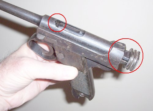

That last article [above] had a couple of interesting points in it; specifically about the magazine having it's own 'hold open' so that rounds could be loaded more easily. I tried depressing my mag button down to the bottom of its travel, and one of my magazines does have this feature [pic attached]. The magazine friction spring [on the frontstrap] is supposed to release the follower when it's inserted in the pistol, but mine only half-released. I didn't have any rounds in it, maybe it needs a full load to function correctly.
My matching magazine does not appear to have the 'hold open' feature, but it's pretty gummed up with old grease & crud...
Cool idea, though.
