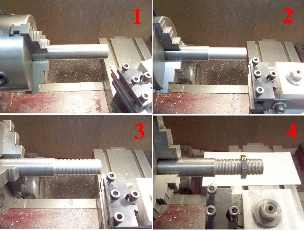

I also made up some 38 Special cases without cutting the extractor groove. But I needed to expand the cases, as the OD was [IMHO] excessive for the 8mm chamber - Something like .030" smaller. I've been told that unexpanded 38 Special case used for 8mm Nambu could/would split when fired. To counter this I made up my own 'expanding die' out of 1" steel rod.
[pic 1]
Turned down to ~ 7/8" diameter. The die body was also drilled & internally threaded to 1/2" x 20tpi for my 'ram'. The die body was also drilled for 3/4 of its length to 27/64" to contain cases expansion.
[pic 2]
Threading the die body OD to 7/8" x 14tpi.
[pic 3 and 4]
Turning the 'ram' out of a 1/2" x 4" SHCS.
[pic 5]
Expanding die in RCBS press, cranking out expanded 38 Special cases.
[pic 6]
Close-up of expanding die.
[pic 7]
Some expanded cases.
[pic 8]

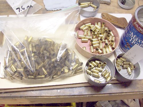

One of our members mentioned having reloaded 8mm Nambu ammunition that was made from 40 S&W brass. I was able to filch some once-fired 40 S&W cases out of the brass barrel at my local club for conversion.
Using the fired cases, I de-primed them using my 44 Special sizing die with the 22-250 decapping pin. I left the case rim and extractor grrove alone.
I've read of extraction problems with the 40 S&W case conversions. The 40 S&W case is oversize for the 8mm Nambu specs, so I swage these cases. These cases were all right at the ~.415" base measurement; I want .407" - .410". I use the 30-30 Winchester sizing die again to resize the cases, same procedure as described previously for oversize cases.
My 40 S&W cases are now ready for neck forming.

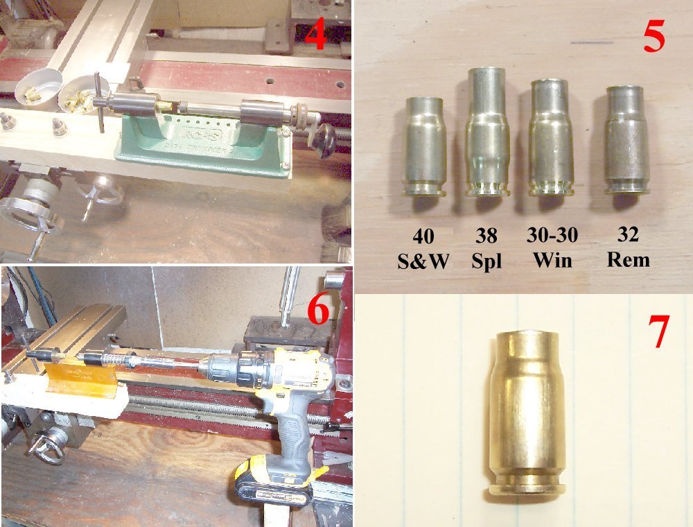

Here are the cases that have been swaged or expanded. They are -
38 Special
375 Winchester & 30-30 Winchester
25 Remington & 32 Remington
40 S&W
These are now all straight-walled cases. The next step is to form the case necks in the RCBS 8mm Nambu sizing die.

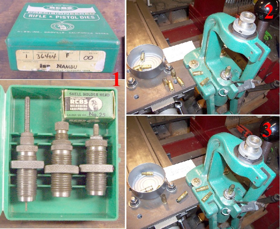

Forming the neck.
RCBS 8mm Nambu 3-die reloading set. This is an older set, and the seller included an RCBS #25 shell holder. Nothing special here; lube the case liberally and run it through the RCBS 8mm Nambu sizing die with de-priming pin removed.
[Pic 1].
40 S&W in press.
[pic 2]
38 Special in press.
[Pic 3].
Trimming OAL to ~.862".
[Pic 4]
The various cases neck-formed but not yet trimmed.
[pic 5]
An experiment using a suggestion by a member in another thread (which I can't find now; sorry!), to power trim the cases.
[pic 6].
Finished 40 S&W case converted to 8mm Nambu and ready to reload.
[pic 7]

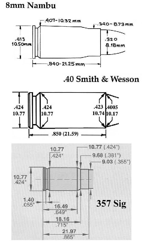

Just reading on another forum about some Type 14 Nambus being able to use 357 Sig and 40 S&W cases without turning down the rim (or swaging them using the 30-30 Winchester sizing die)...My Type 14 will not take any rim over .417" and at that size it is tight...
Here is a comparison of the three...

Edit: Checking my 27 'test' 40 S&W cases, I'm seeing .052" rim thickness. The print I have shows .055". I'll rig up my parting tool bit and see what I can do to get it down to .042"...
Pic of the bag my gun club president dropped on me. I should be able to get several hundred out of these.
I forgot to mention that the conversion process does have a failure rate...About 1 in 15 or so is crushed or split during the neck forming operation...

I'm going to use the Red Dot first. Right now I'm trying to figure out this 3-die set, as it has no instructions and there is one die that I'm puzzled by...

One would suspect that the first die oversizes the case, then the middle die first portion sizes the interior of the neck, then the option to bell is available.
That is what most of their 3-die sets do. This one is different...
Brass thickness would not affect the expander; it's going to expand it to .321" ID no matter what the case wall is...
RCBS may have made these dies for a larger bullet; say .322"-.323"...But besides Lebel & Nagant there haven't been any .322"-.323" 8mm pistol cartridges...According to COTW...
Could entertain taking the inside sizing plug, the first area, and knock it down a little for grip on the bullet in hand.
I expect I will end up making another expander ram for my home made die body and try to get it right around .320"...Make the first 3/16"-1/4" @ .320" and then a quick taper for a slight bell on the case mouth...
I'll try emailing RCBS and ask if they still have instructions for this die set and maybe find out what they intended...
Edit: HMOCC recommends using "Lyman bullet #32362 sized .321"...Maybe RCBS made their die set for this one bullet??? Maybe it was the only one available back when the 36404 die set was offered???
Edit2: This site shows the Lyman 32362 as a .325" cast bullet...
