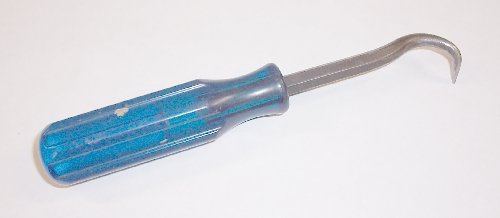

Edit: I took my grip off to look, and now I remember that I used an old needle-scaler needle (they're 3mm x 7" long and exactly fit in the hole) to use both hands to get the spring compressed, with the frame in a vise.
BTW: I use this tool to pull cuttings off my lathe work, but it should work on Luger mainsprings as well as its primary purpose - Cotter Pin Puller. Should be available at any auto parts/tools store. Handy thing to throw in your toolbox.

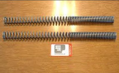

Zorba - The Nambu recoil springs go with the 'loose' end toward the front. You want the spring to compress fairly rapidly until it reaches full compression, when it rebounds. Pic below.

The Luger spring looked equidistant between the coils to me - but I'm not seeing a picture of the Nambu springs, although I A) Didn't know that, and B) Its pretty obvious from your description - provided that I can see a difference!
ETA: Now I see the picture, I don't have gigabit at home...
ETA2: I'll have to examine my Nambu springs next time I disassemble, I don't recall them looking like your picture at all. But my old brain is starting to miss all kinds of stuff - fortunately, the Nambu isn't going to the range with my wife and I this weekend anyway. If my springs are something like that, they'll either both be backwards, or there'll be one each way!

Here's the rule of thumb - Put the tight coils at the fixed end of the spring. On the Nambu, that'd be the back end, where they sit against the frame, and the slide pushes against the front. On the Luger, I think the tight coils go up, because that's where the spring abuts the frame, and the long hooked piece with the triangle at the bottom pushes up...
