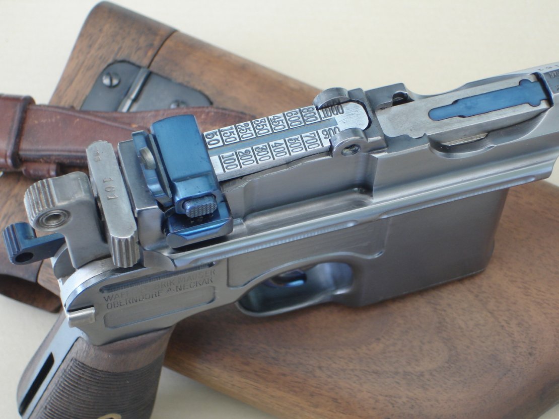

They can be very accurate; stable platform especially with stock attached.
ATF Ruling:
Q: If a person has a pistol and an attachable shoulder stock, does this constitute possession of an NFA firearm?
Yes, unless the barrel of the pistol is at least 16 inches in length (and the overall length of the firearm with stock attached is at least 26 inches). However, certain stocked handguns, such as original semiautomatic Mauser “Broomhandles” and Lugers, have been removed from the purview of the NFA as collectors’ items.
[26 U.S.C. 5845, 27 CFR 479.11]
http://www.atf.gov/firearms/faq/nati...r-stock-pistol

I was under the impression that broomhandles were exempt from the purview of the NFA requiring registration as an SBR provided that they were fitted with an original stock. As such, the wooden part could only be a reproduction as long as the iron attachment piece was an original.
By the way Jager, that is an absolutely gorgeous pistol in the photo!
Is that yours? Original finish?
