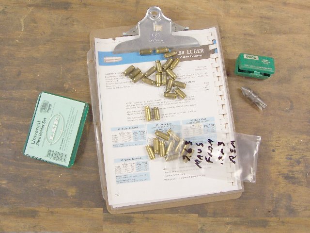

I had some spare time today, so I ran a small number of .223 Remington and 38 Special brass cartridge cases through the conversion process. (These are for 30 Mauser/30 Tokarev, but 30 Luger is exactly the same process). So, here we go again!!!
First is the .223 Remington cases -
Raw fired cases; cutting them to length with a parting tool in the lathe; Short case parted off; raw short 30 cal cases...
Sizing the short cases to form the bottleneck; trimming them to final length; chamfering/breaking inner & outer edges; finished 30 cal cases.
Cases can also be cut to approximate length with a mini-pipe cutter -
I next did some 38 Special cases, to 30 cal -
Turning the rim off; finished rim; Cutting the extractor groove; chamfering the groove. I didn't want to spend the time grinding a cutoff tool to the correct profile, so I just ran the wide cutoff bit in at an angle.
Sizing in the full-length 30 cal sizing die; chucking the sized cases in the Forster case trimmer; cases cut to final length; comparison of .223 Remington/38 Special/30 cal Starline finished cases.
I chucked the cases in the lathe using a drill bit for a mandrel and set the tailstock/live center to the required length. I also used the drill bit/mandrel while parting. There were a few steps I didn't bother photographing, such as lubing before sizing; de-priming; measuring length; etc.
Finished cases are now ready for reloading!
Here's the specs on .223 Remington vs 30 Luger cartridge cases.
There are other cases close enough to work, but (like the 38 Special) may require extra work.
I generally fire mild loads in reworked cases the first time, to 'fire form' them to final configuration.

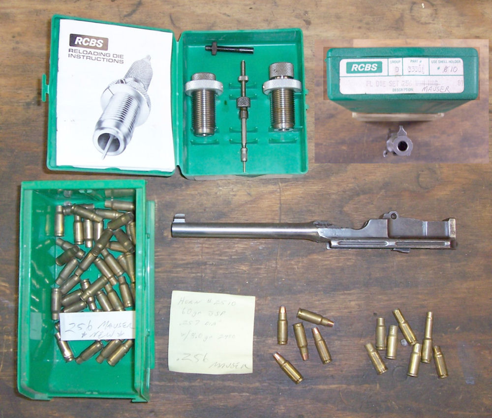

I been digging through all my old boxes (I moved 18 years ago; not everything is unpacked yet) and found a conversion I did many years ago...A C96 Mauser re-barreled for a .256" wildcat cartridge...
My usual .223"/5.56mm cartridge cases cut down so that OAL will be the same as a 30 Mauser (which this once was). .256 Winchester Magnum chambering reamer in a .256" barrel blank turned down & threaded into a 30 Mauser receiver. It was much longer originally (I posted a pic of it back then) but I shortened it for convenience. Also to retain what little hearing I have left - This cartridge made a really loud crack...
RCBS .256 Winchester Magnum die set cut down to '30 Mauser' size...I fired off most of my reloads, had a couple left over...
