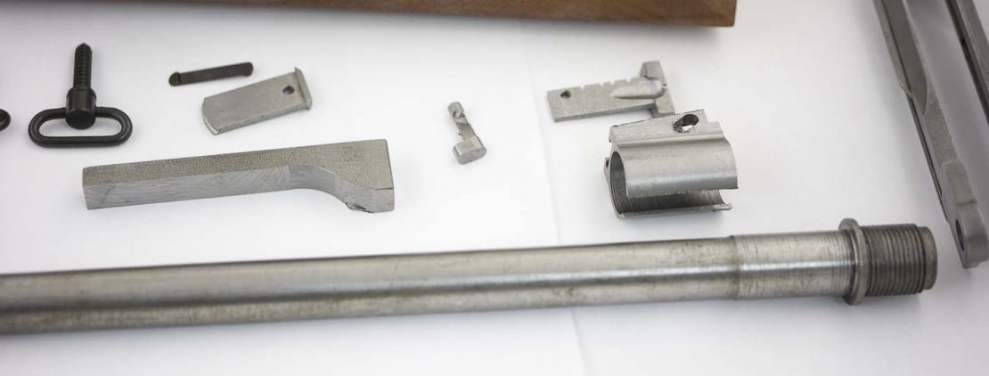

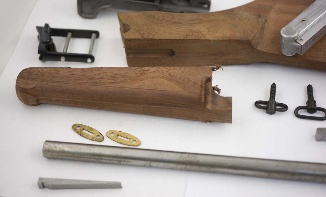

Default Carbine Parts set - Step -1
Here is a parts set that will go in to making a carbine.
If you have any questions on what's what let me know.

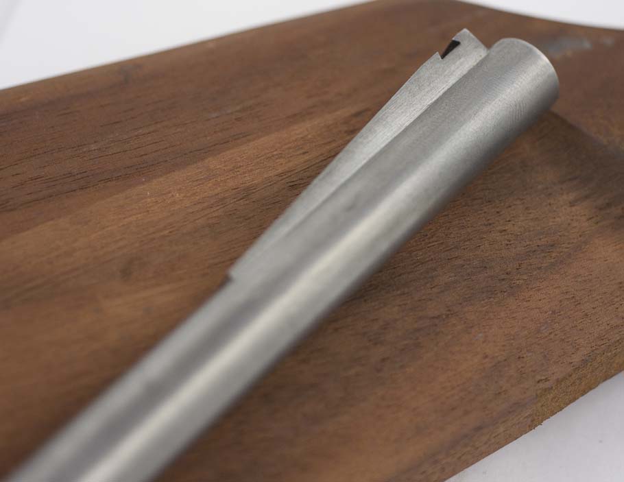

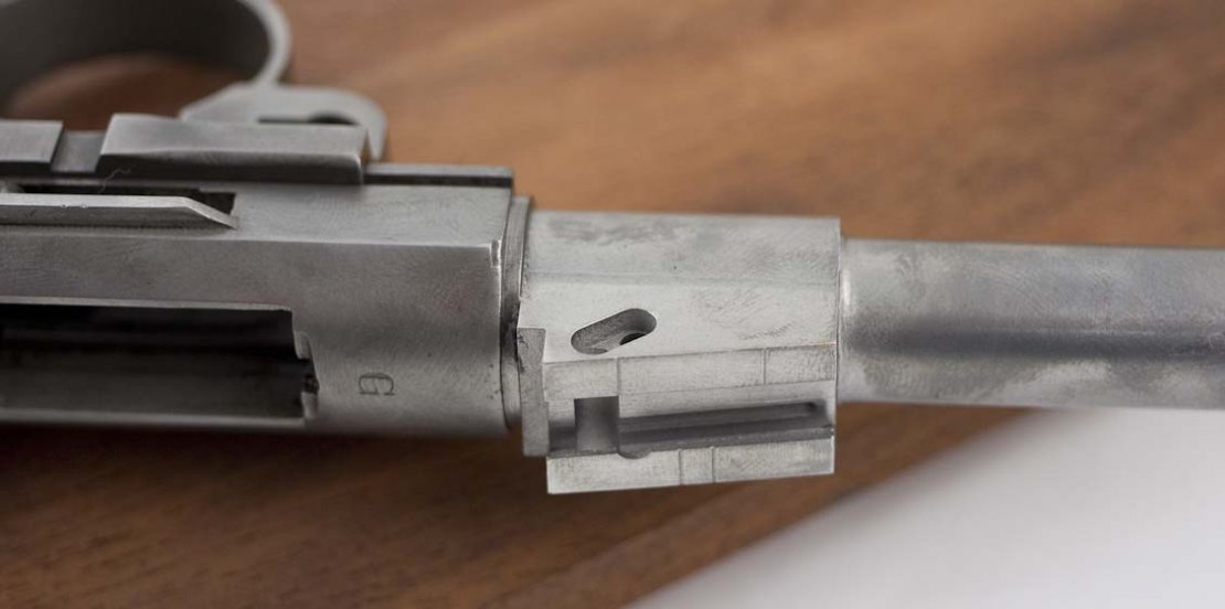

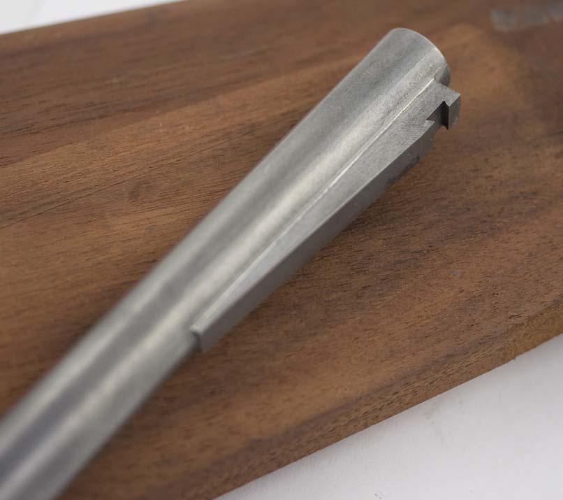

Default Step 2 Barrel work
Front sight silver soldered in
Rear sight silver soldered in
Barrel installed

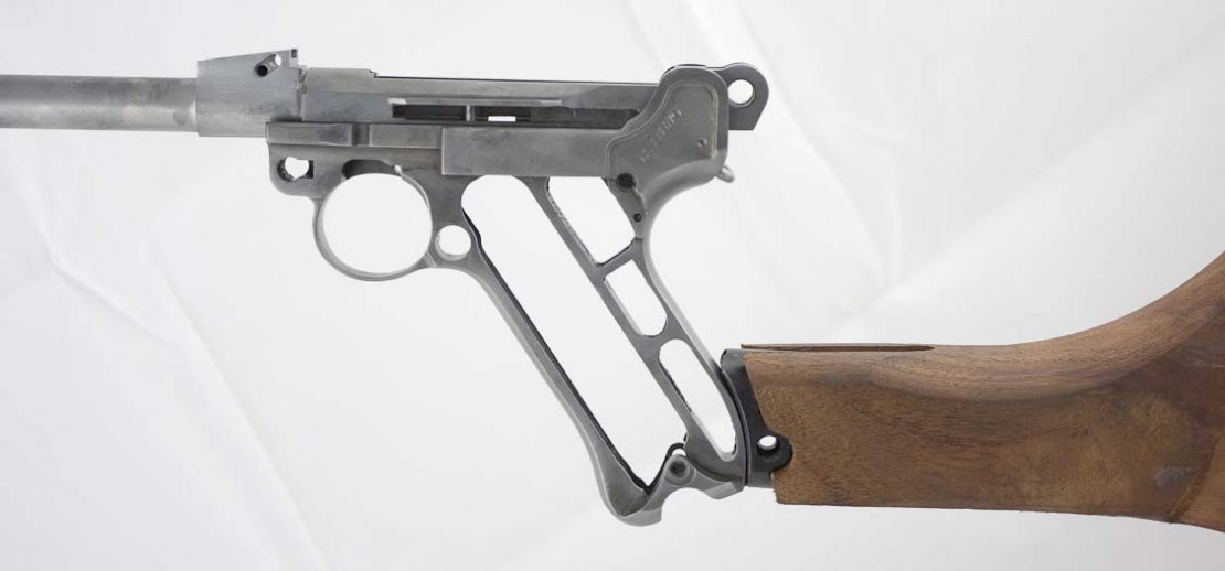

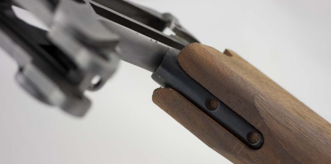

Default Step 3 Stock work

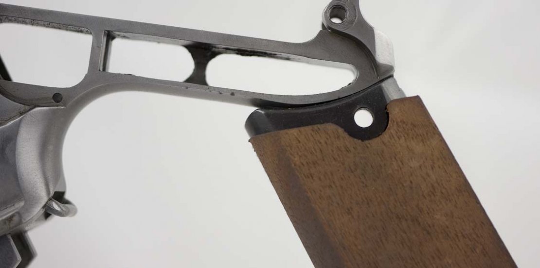

Rear stock iron fitted to the frame
Rear stock iron fitted to rear stock

Unread 11-09-2013, 03:04 PM   #12
Excellent!!!
I love watching a piece of art evolve!!!
Interesting that the rear sight base on this carbine is of the 'split' type...
I don't recognize the wood, but it reminds me of a story I heard at the last gun club meeting...There is a small Amish community nearby, and they offered to clear some local land of trees...The trees were 'black walnut'...An Amish work crew spent a weekend felling and cutting up the trees and hauling the wood away...We assume they plan on making furniture from the lumber...
sheepherder is offline

Eugene you keep adding and I'll make a sticky (unless I am too prejudiced, then folks just tell me).
Rich, lots of guys who fell trees or cut up the ones from storms harvest the wood, I am ok with that. We have tree cutters coming out this monday for my neighbors and some of our big branches, I am tempted to ask the logs be cut into reasonable pieces and I would finish up the rest for next years firewood (no oak or the like)

Rich, the wood appears to me to be black walnut. There's an area that was freshly shaped or sanded, and its slightly pinkish appearance leads me to this opinion. It would finish up more of a warm brown, like current Thompson semis.
