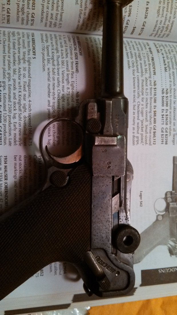

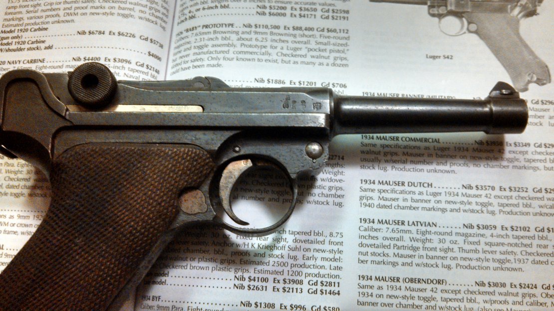

I have the opportunity to buy an Erfurt Luger 1918. I have been having issues trying to find values and here is why.
The pistol is not functioning and several of the parts that are supposed to move either do not or are very tight. The barrel has obvious rust in it and not sure about pitting or not didn't have the correct light to see the whole barrel. All serial number match except for the two magazines but both seem to be of german decent. The gun is currently owned by an 85 year old widow who has the p/w to show it came from the war in 1945. Also she has had it stored in a Ziploc bag in the dresser for the last 50 years so I am guessing that is where the rust is from. Also I thought that these Lugers were 9mm but in the magazine there was original or close to original ammo the read Peters .30cal or I believe 7.62mm. Is this rare or what?
Gun has heavy pitting and can not be fired in its condition. So what I am looking for is a fair value backed by someone or a book that I can share with this lady. Can anyone help? I have pics but not sure how to load them as I am brand new to this site.
Wes

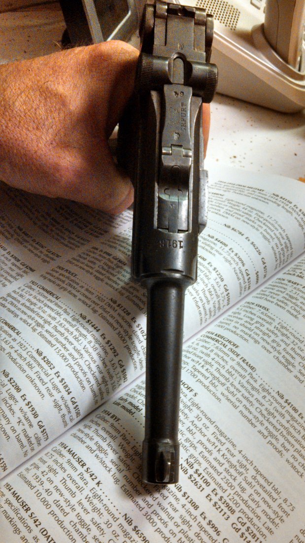

here is the third pic

I know they are not that rare but what I was asking is this is not a 9mm but a 7.62mm that is why I was asking about what is rare or not as most have said the lugers are 9mm.
weslo1969 is offline   Reply With Quote
Unread 10-31-2013, 12:13 PM   #6
Welcome to the Lugerforum.
This gun is pretty common and not a rare specimen. If a standard #2 pencil will fit into the bore, then the gun is 9mm. If it doesn't fit, it is .30 caliber and that would indicated that the gun barrel at the very least has been replaced after the war (World War 1, not 2) and is made up of parts, and not as it left the manufacturing process at Erfurt. Erfurt was a German military arsenal that never produced any .30 or 7.65mm Luger pistols, or any commercial pistols. The original manufacturer of the Luger was DWM, and they were the only one to ever produce commercial pistols in 7.65 caliber until the Mauser company made a new batch in the 1970's.
CAREFULLY remove the grips and soak the gun in PBlaster penetrating oil for a few days and all the parts will slowly begin to move with some exercise. This should also stop the active rust process.
BTW, there was no such thing as a ZIP lock bag 50 years ago, or for that matter, I don't think they even had polyethelene bags back then... so it probably spent some of its storage time in some other place or wrapped in something that attracted moisture.
Parts guns are classified here on the forum as "shooters" because they have little or no collector value since factory original parts have been replaced.
In it's current condition with rust present all over the gun, I would rate it's value at less than $500.00 and possibly lower.
I doubt you will find a book that will quote you even a passing value for a gun covered in pits and rust.
This forum has been in existence for over 10 years with thousands of members world-wide who are Luger enthusiasts and historians, some of whom have authored internationally known books on the subject. I have personally been studying Lugers for over 50 years. You can use this forum as your reference. Let a few others comment on what they believe is the value, and then just show this discussion thread to the present owner.

But thank you for the info as these pistols are very new to me and all the info is AWESOME!!!! So would an original barrel then have the serial number on the bottom of it? This pistol has no serial numbers on the bottom?
Unread 10-31-2013, 12:30 PM   #8
The original barrel would have had the serial number on the bottom close to the frame. There would also be a bore diameter stamp in millimeters like "8.83"
The serial number would appear on the front of the frame under the barrel and on the left side of the upper receiver as shown in your photos.
