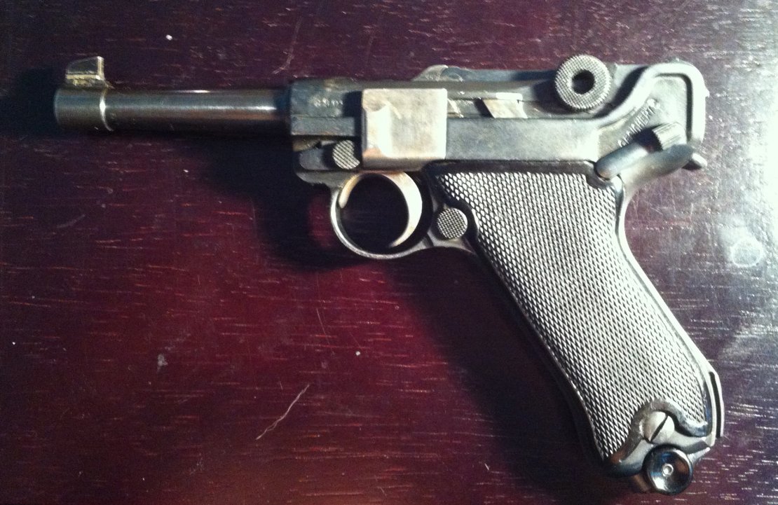

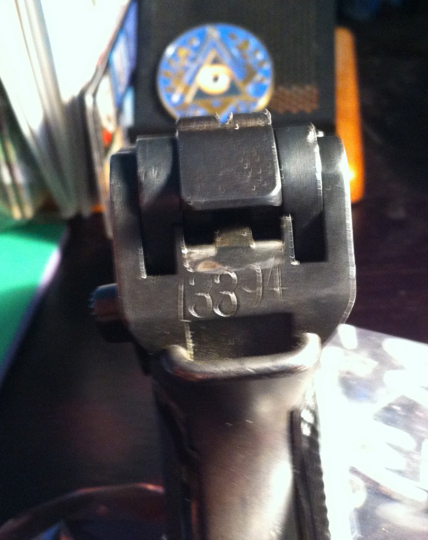

Hello,
Just acquired my very first Luger pistol from a collector in a barter for other items. He did not have any provenance on it, only saying he had purchased it for around $800 and that is was a mass-made "shooter" as opposed to coming from a specific original owner. I do know the manufacturer is Deutsche Waffen und Munitionsfabriken (DWM) and it's a Luger P08 (Parabellum). Basically that's about it. I have no idea what all the other markings and numbers are and would really appreciate tapping into all of your expertise on this forum to help me date this pistol and learn more about it.
If you cannot read any of the #s on the photos let me know and I'll tell you.
Photos follow:

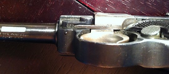

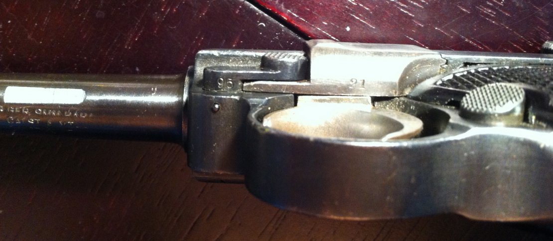

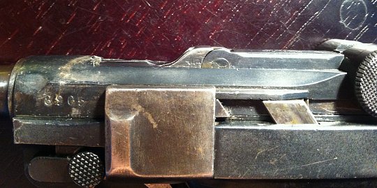

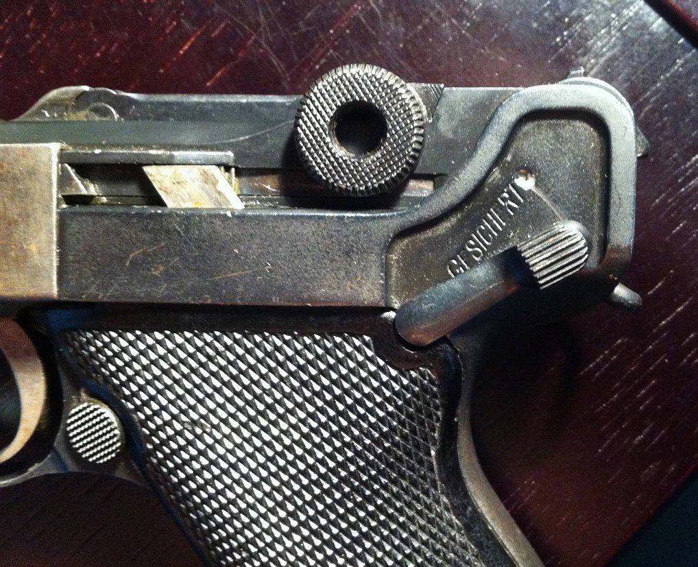

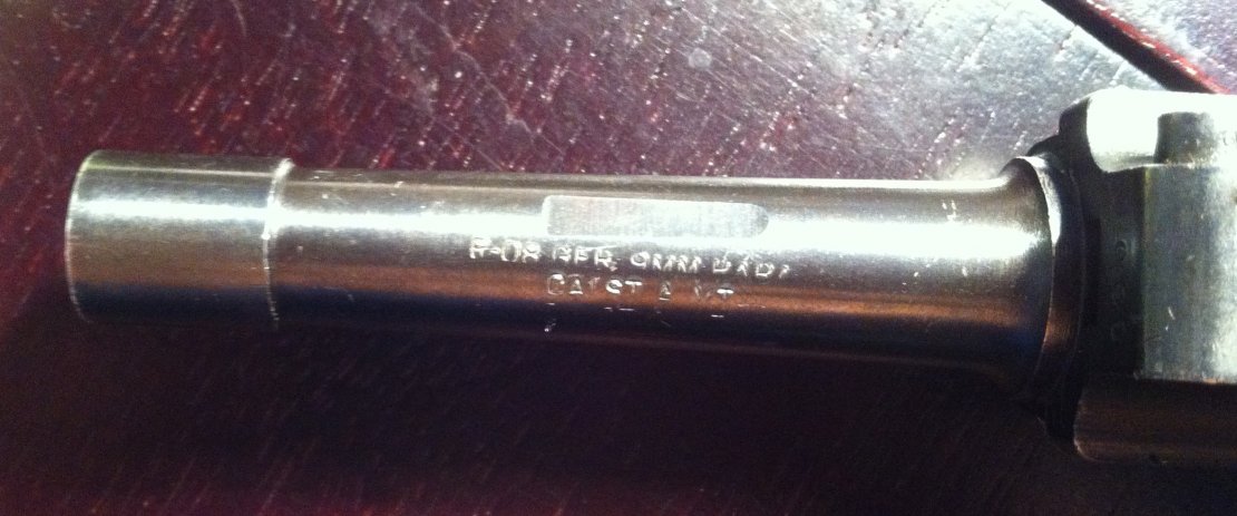

Interesting gun. Mismatched sideplate and maybe safety, originally a commercial marked gun. The markings under the barrel are the required info. for import into the USA. The front sight makes me think of a Finnish Luger. Not clear about the numbers on the back.

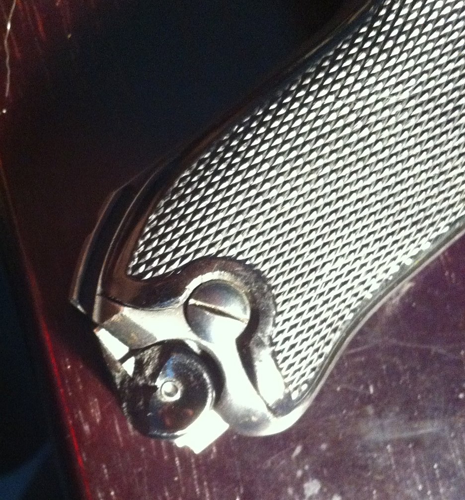

It would be interesting to find out if the grips are orig. WW2 German, and the magazine, although chipped, is also good property.
Welcome aboard.
Unread 10-14-2013, 04:44 PM   #3
Your Luger is made of a mix of parts from different eras. The grips and magazine are late WW-II (1941-1942). The crown/N marked receiver is a commercial gun's receiver. My guess is that it's from a very early DWM Luger because of the proof mark's position. The extractor looks to be from an Erfurt. The side plate and take down lever are numbered in the commercial style from different guns. Barrel looks replaced and perhaps aftermarket, or Finnish as mentioned by David.

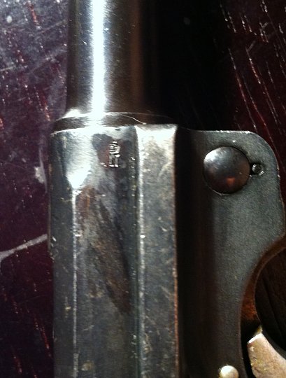

Is something ground off the barrel above the import mark? If so, you might have a problem. I believe that CAI sometimes serial number marked their imports, and that could be a ground off serial number (which is illegal in the USA). Is there a serial number and suffix letter on the barrel, and on the front of the frame?
My guess is that you may have an early Finnish or Russian Capture import made up of parts from several guns.
Unread 10-14-2013, 04:55 PM   #4
Does it has a serial number on the front of the frame?
If it does, then the thought of a ground off serial number on the barrel is a moot point, the barrel is not what is considered the frame (receiver for most guns).
I have had lugers without a number on the front of the frame and the number on the side was considered okay - so, again, it would be okay, heck, you don't know what might have been ground off...

I believe the grips are genuine original German grips and in an of themselves are worth a few hundred dollars... Since this gun is a shooter, offer the grips for sale and get yourself a nice set of reproduction walnut grips... you will make some collector happy and will probably profit even more from your barter.

Thank you very much so far for all the replies. I'm assuming the front of the frame is the area just underneath the barrel if it were pointed at me. Just above the front of the trigger guard, correct? I did not photograph that area because the number there is the same 8905 that appears on the second photo down. So, is 8905 the serial #? Also, your guess is as good as mine as to what that flat area is on the barrel above the wording.

I think accurately dating this pistol is pretty much impossible, due to the mix of parts and grinding done on it. I was going to say you have a real frankenluger, but I see you just indicated that the upper and lower serial nums match - that means at least the frame and barrel extension (what you might call the receiver) are matching, so tis' not so bad.
Ed is correct, a missing serial num on the barrel is no big deal in the USA, but maybe you are not in USA?
The headspace and front of the breechblock looks funny to me and chipped up. Have you shot it?
If not I would only load one round for the first few a few shots just to be safe - However it may interest you to know that a Luger cannot seriously injure the shooter if it fails, even in a catastrophic failure. Can't say that about an Orgties or a Steyr-Hahn.

I believe that the nitro proof on the right side of the frame could be East German.
