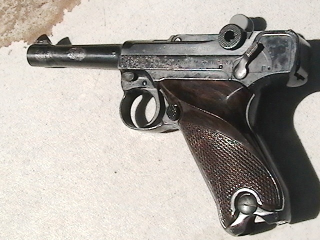

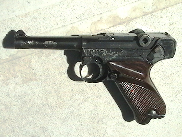

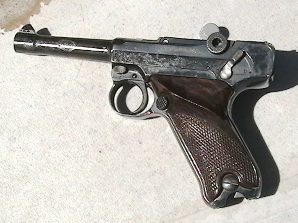

Good Morning all you nice people out there in Cyberspace...Just picked up this "Baby Erma" 380 KGP68A yesterday for a good price. Seems to shoot ok and function properly....as the picture shows it has a little cancer on the receiver/alloy frame. Is there a fix for this or a way to restore it and have the serial number re-stamped? I have thought about the new MuggyWeld Alloy #1 low heat weld filler or even a type of epoxy?? and then sculp the frame back to shape...can anyone tell me exactley what kind of alloy this is and/or anyone has completed with any success a repair...
Thanks and have a great Day

Hi Henry,
The alloy is called Zamak, an acronym for "zinc, aluminum, magnesium, and copper". Theoretically, it can be repaired by TIG welding with proper filler material, but working with this diecast stuff is always a crapshoot. Repair/refurbishment of the actual finish on the frame will also be problematic. (I've acquired a quantity of commercial zinc blackener which I will try out on a couple of mine, if the trial run of broken toggle parts turns out acceptably.) I think if you found a competent engraver who would deign to work on Zamak, that the numbers could be re-established after the surfaces are worked down enough to look good again--but you may wind up paying more for this part of the restore than the gun is worth. The Barrel is the regular dip blue finish, so no problem with refinishing it or other parts in the upper--it's just the grip frame on this model that is Zamak
