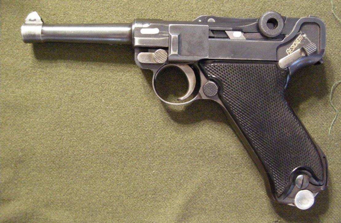

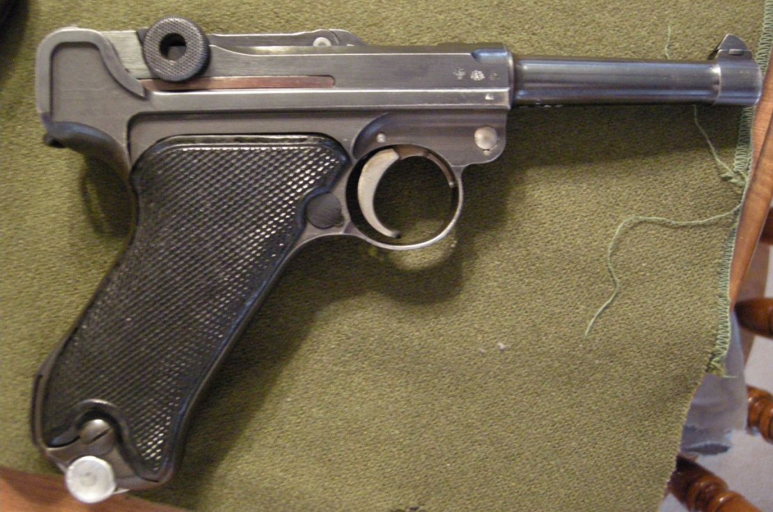

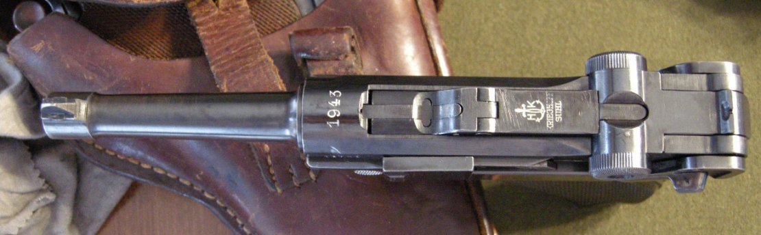

I have a 43 Krieghoff that I intend to sell but it has been years since I was active in Luger collecting and am not even sure what all of mine are anymore--breaking out the books now.
I have found very little price information about post-40 Krieghoffs and would like some guidance.
Pictures are not the best, my Nikon coolpix is probably not very adiquate, at least in my hands-seems like past 70 they shake a lot.
As far as I can tell all numbers match. There is no number on the fireing pin or the finreing pin retainer or hold open device. Did not check the extractor. Magazine has a Krieghoff marked Al bottom, different SN and looks like the body is of a earlier era-folded steal.
Thanks in advance.

Gary..There is no number on the fireing pin or the finreing pin retainer or hold open device.
Is there any markings on these? Eagle 2? Is the firing pin fluted? Have you looked at the sides or the underside of the hold open?
Is the serial # between 11.300 and 11.800?
Is the barrel and frame serialed?
Is the underneath of the sideplate serialed with last 2-3 digits?
Is the lever on the inside plate Eagle2?
Is the extension of the sideplate numbered last 2-3 digits? and Eagle 2?
RIA can have very fanciful descriptions..Not often accurate. Most of the 9MM Lugers for the Luftwaffe went to AA crews. Officers did not carry many although there were noteable exceptions as you indicate!
Good point Jerry, I did not remove the hold open or the sear to see if there were numbers in unseen locations. Hate doing anything with those leaf springs.
The fireing pin is fluted and I did not see any proofs on it or the retainer.
Also, is it normal to have a strawed take down lever on these? Seems like most everything had gone to bluing by this time.
Oh, and another question, the SN on the take down lever, though it matches, is on the upper side of it so it can not be seen when the gun is assembled. I don't recall seeing that before--but this is the only Krieghoff I have owned.
Gary

Gary - In the 6th Edition of Military Firearms (2011) your 1943 Krieghoff the price listed is - Exc. $4500 - V.G $3750 - Good $2200 - Fair $1500 - Poor $950. There were approximately 9,000 manufactured within the 4500-14000 serial number range.
At a gun show you can expect a discount of at least 40% from these prices from a dealer that might not know what a Krieghoff Luger is.

Bill are you sure? I am looking at page 182 of The Krieghoff Parabellum by Randal Gibson, 300 made serialed between 11,300 and 11,800 You must have some serious misinformation. There's no way 9,000 1943 Krieghoffs were made! That would have been half their entire production! Check again.
Also, is it normal to have a strawed take down lever on these.. Yes, Krieghoff was not normal!
Gary, A good Friend bought your normal run of the mill 1937 Krieghoff, well, OK it was close to mint, I think he paid $6800 for it but I could be off a few hundred. During his inspection period he brought it to me for a thorough take down and authentication. At my bench I took it completely apart..most people would not do that to almost any Luger but if you want to actually authenticate a Krieghoff it is absolutely necessary to get a look at all the hidden numbers and Eagle 2 markings. Leaf springs, tiny drift pins, the works. The markings and numbers for the extractor are underneath necessitating taking it out..drift pin and spring. In his case everything checked out and I happily authenticated his Krieghoff.
I mention this because you need to know if your pistol is authentic and complete in order to know what an even ballpark price might be. Knowledge is power. If you know..you know. If you don't you may very well lose thousands of dollars that are rightfully yours.
Jerry; I missed this post. It popped into the thread above a post I made and i didn't notice it till today. sorry for the delay in answering.
Yes to all the above except #1 The FP is fluted and there are no proofs on the pin or retainer, the HOD is proofed.
Thanks
Gary
mystical_tutor is offline   Reply With Quote
Where are you located and what gun show do you plan on going to?
Hope this helps.
Thanks much for your efforts. I am not familiar with that work but will look it up. The Blue Book list prices as:
98% 95% 90% 80% 70% 60%
$10,000 $8,000 $6,000 $4,150 $3,350 $2,750
I am not sure how the comparisons between Poor-Exc. coralate to percentages--even after reading the grading guide in the BBoGV
I live in Colorado and am planning on going to the show in Colorado Springs this weekend and the Denver show next month.
