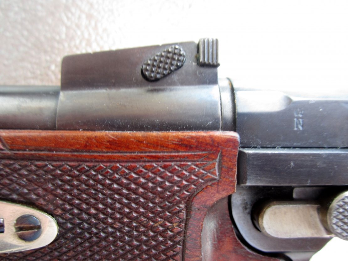

I realize I know nothing about the proper use of artillery sights. How do they work? What was their correct use? What does the numbers mean? How are they properly set? How accurate are they? Etc..~~~Eric

I can give you a start, Eric. The numbers are gradations in hundreds of meters. The say that the 800 meter mark is a bit "optimistic". I guess you'd push the button in to slide the keeper up to however many yards away you thought you were from the target, then start blazin' away. Before 1917, they were adjustable with the proper tool with two prongs on the end which fit into the two holes in the "snake-eyes"-head screw. I forget if this is for windage (side to side) or to fine tune the elevation, but I'm leaning toward elevation. Yeah, that's it--and the front sights of the earlier ones adjusted from side to side, using the same tool. With this combination, you'd be able to dial it right in. IIRC, the fine-adjustable business was phased out towards the end of WWI. Perhaps it was found by that time that one didn't usually have time to diddle around with fine-tuning the sights during combat!?

Just to give some flippant answers: 1) They work well; 2) They were used to inflict damage or suppressive fire on opposing forces; 3) The numbers are increments of 100 meters in range to bring point of impact of a fired round to close to that range; 4) They are properly set when the point of impact is at the range of the opposing force
Now, to be more specific: The cross bar with the button is a yoke that engages the curved ramp on the sight base and slides on the ladder bar (the shiney part with the numbers on it). As the cross bar moves forward on the base, the curved ramp elevates the ladder bar. The ladder bar has a series of notches on it side that serve as a stop for the spring loaded pawl activated by the button on the cross bar...when you push the button it disengages from the notch it is currently in and re-engages a notch at the range you wish to set. The "hinge" on the front of the ladder bar is not set perpendicular to the bore but rather at a slight angle. This causes the rear of the sight to move to the left as the sight is raised...at long ranges this compensates for the drift of the bullet imparted by the right-hand twist of the rifiling.

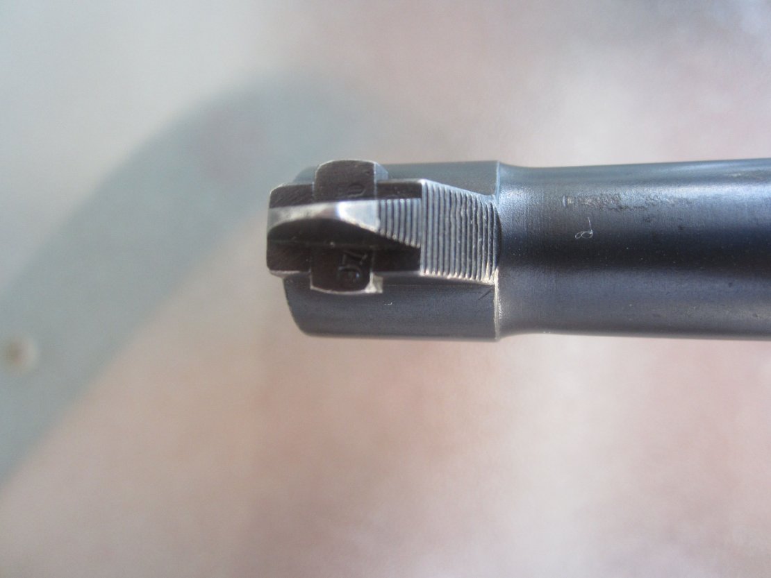

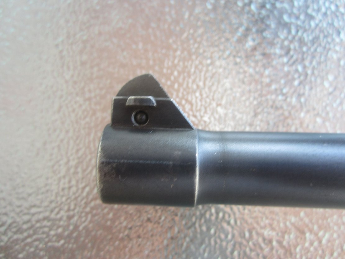

How were and why were these foward sights adjusted?

Unread 09-01-2013, 11:23 AM   #14
Eric, only certain years were 'fine tune'. darned if I can remember which years, early ones i know
Unread 09-01-2013, 11:41 AM   #15
The fine tune (ft) sights started to be phased out in 1917 and you can find that year examples with various combinations of sights, e.g. ft on front and rear, ft on front only, ft on rear only, front and rear without ft.
Unread 09-01-2013, 11:43 AM   #16
The "fine tune" adjustments on both the front and rear sights were accomplished with a two-pronged spanner tool that fit the adjustment screws on both sights. The front adjustment was for windage and the rear adjustment was for elevation.

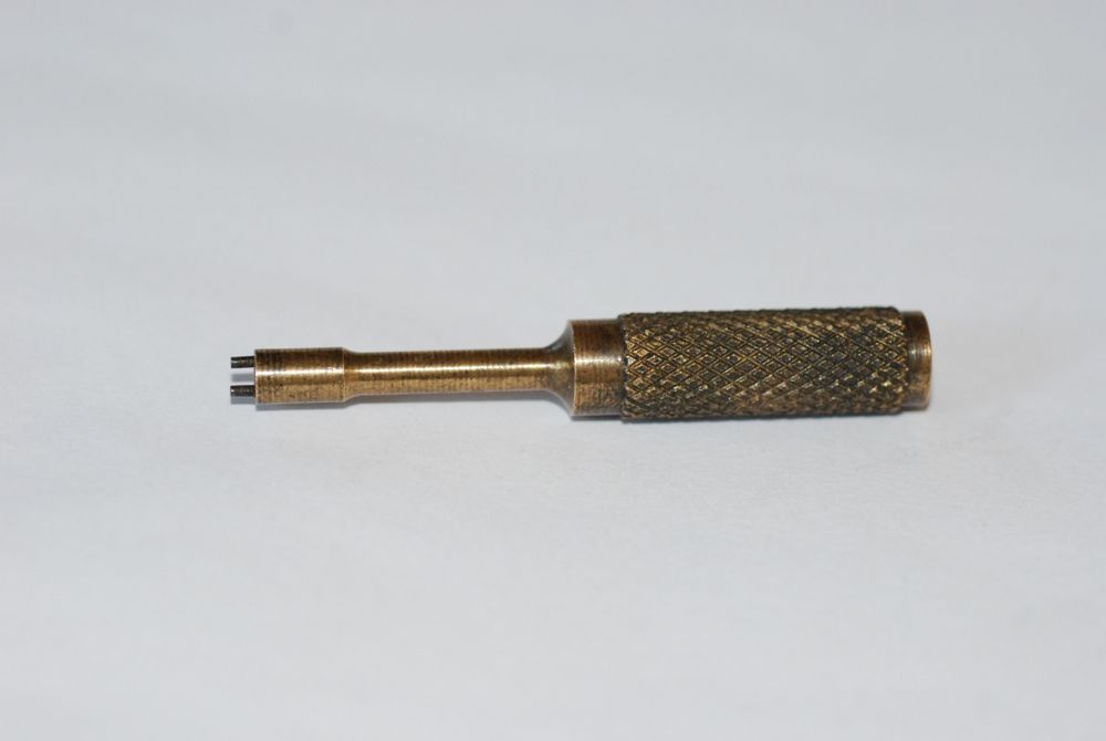

How often would there be a need the need for a sight adjustment tool? Once correctly set would it remain ok??
Unread 09-01-2013, 11:58 AM   #18
Eric, As Ron has said, both front and rear sights could be adjusted with a tool like this one. However, they were not intended to be fiddled with by troops in the field, they were set at the factory, but could be readjusted if necessary, by unit armorers.

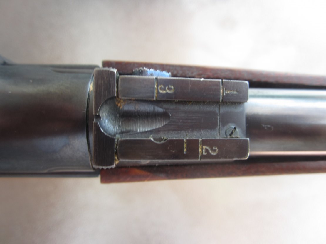

1920 Carbine 4 position adjustable rear sight assembled to rear portion of barrel. See page 188, 'Lugers at Radom' PS nice wood work!
