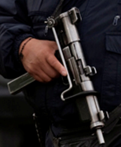

This photo was used by foxnews.com today related to the capture of a drug cartel leader. I am ususally pretty knowledgeable about small arms, but I do not recognise this gun... can anyone else identify it?
Thanks, -John S.

I believe it's a variation of the UZI.

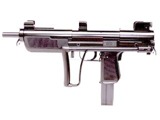

Unread 08-30-2013, 10:54 AM   #3
My WAG is a Mendoza HM-3...
Seems to be several variations...
Unread 08-30-2013, 11:22 AM   #4
It IS a Mendoza and they are supplied in various configurations. Mall cops have semi auto only versions in Mexico.
It is a much closer copy of the Czech VZ 25 than it is of the UZI;
http://world.guns.ru/smg/chex/sa-23-e.html

On the Mendoza...It has a lot of similarities to the UZI and VZ...Bolt telescopes over the barrel, fires from open bolt [auto version], magazine in grip, 9mm, sheet metal/tubing construction, collapsible buttstock...the stock in the Foxnews pic is interesting as it folds over the receiver instead of the usual under-folding wire stock...

John..gives real meaning to the term "open bolt" The bolt is NOT open in this photo. A little difficult to tell but if it were the mag and cartridge would be seen so it looks closed to me.
Unread 08-30-2013, 02:42 PM   #10
Jerry I was talking about the open bolt operation of the sub gun... it appears that when "open" you could easily get a lot of things caught in the open action...
not to mention the bolt handle moving so violently in your line of sight!
and not that these guns had their bolts open... sorry if I confused you...

The Mendoza HM-3 submachine gun was designed by Hector Mendoza, son of the famous Mexican small arms designer Rafael Mendoza. This compact and modern weapon was subsequently adopted by Mexican military. Because of strict Mexican laws, it was never officially exported outside the country. In late 1990s Mendoza company began manufacture of an improved weapon, with modern polimer furniture and different cocking arrangements. This weapon still is known as HM-3 and is available in two basic versions - selective fire HM-3 for military use and semi-automatic only HM-3S for police and security use.
Mendoza HM-3 submachine gun operates on simple blowback principle, from open bolt. It can shoot semi-automatic or in bursts, with combined safety / fire selector switch being located on the right side of the gun, above the trigger. Mendoza HM-3 submachine gun features "wrap-around" bolt which is exposed for the most part of its length, with cocking serrations machined on either side of the bolt in front of ejection port. Feed is from detachable box magazines, which are inserted into the pistol grip. Buttstock folds horizontally to the left side of the gun, and forms a forward grip when folded.
The Mendoza HM-3S semiautomatic carbine is different that it fires from closed bolt, has a polymer furniture and an U-shaped cocking handle (instead of the serrations) above the still exposed bolt.
