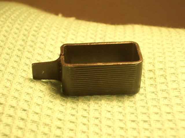

Unread 07-12-2013, 04:22 PM   #5
kpf
Join Date: Oct 2012
Location: Finnøy, Norway
Posts: 75
Thanks: 78
Thanked 36 Times in 10 Posts
Some pics of the tool!
The back of the tool i totally different!
Regards
Kai
kpf is offline   Reply With Quote
Unread 07-12-2013, 04:25 PM   #6
Is that really a Luger tool??? Seems to be missing some machined reliefs...
Unread 07-13-2013, 07:54 AM   #7
klaus 3338
Join Date: Jun 2009
Location: Germany
Posts: 524
Thanked 432 Times in 165 Posts
Kai, it is the Lathi tool. The Luger tool looks like the one on the picture.

Unread 07-15-2013, 03:57 AM   #8
jussi16
jussi16's Avatar
Location: Finland
Posts: 250
Thanks: 77
Thanked 53 Times in 31 Posts
This is Lahti L-35 tool.

Unread 07-15-2013, 06:42 AM   #10
jussi16
jussi16's Avatar
Location: Finland
Posts: 250
Thanks: 77
Default Tool
Hello Kai.
I have a tool like yours. Hard to say, but they are propably fakes. Almost all I have seen look to be in unused condition. And that stamp is not the hardest to fake. And the back side is not milled.
One of mine has the SKY stamp too.
They work with some magazines.
jussi

Unread 07-15-2013, 09:46 AM   #11
Milled relief on backside of Luger tool should look like this one...(Which is a Sarco copy/fake)...
