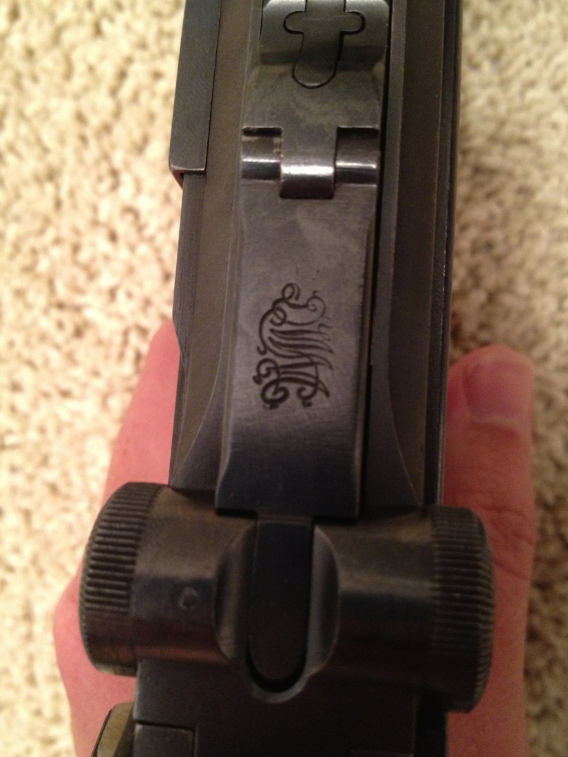

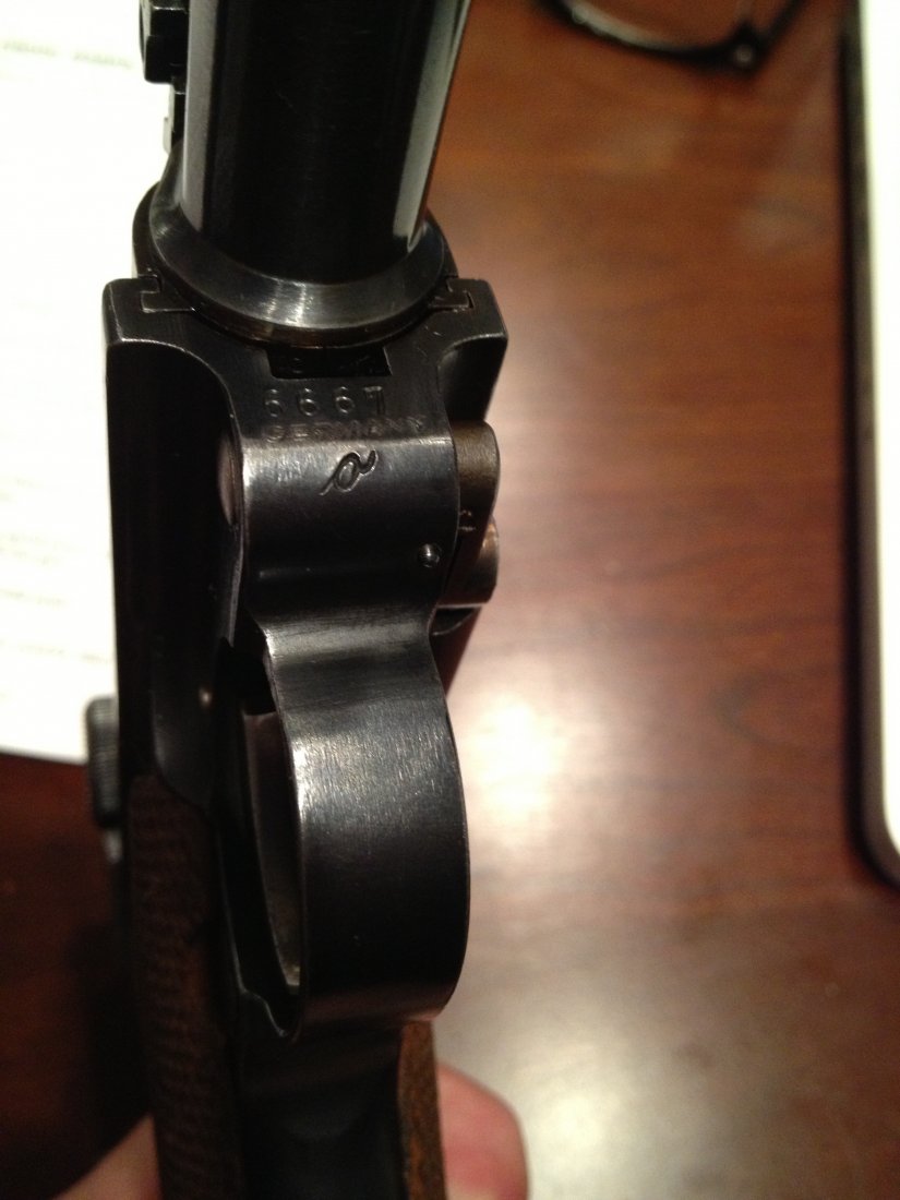

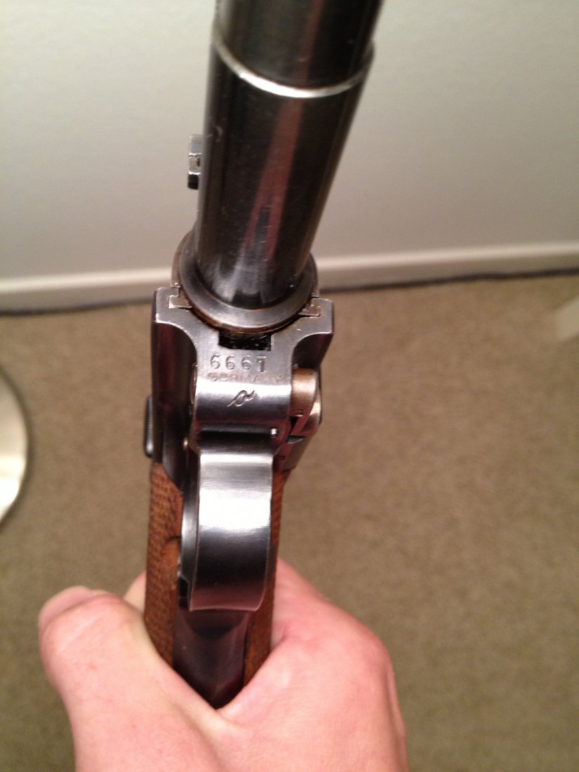

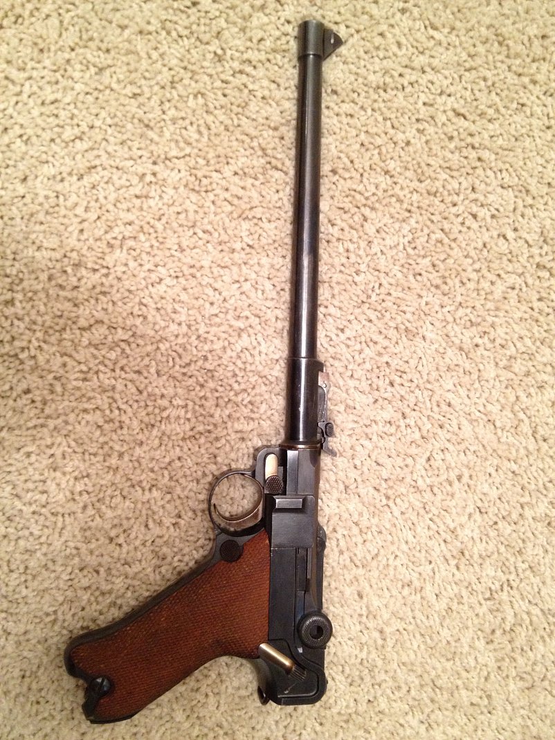

Hello!
I am the owner of a P08 Luger with a 9" barrel, however I'm not 100% sure about the value of the gun as the previous owner had only limited information about it.
It is a 7.65 caliber and I think it has a replacement Stoeger barrel of its approximate vintage, though I'm not certain of the year it was made. I know that the previous owner purchased the gun in '52 and he identified it as 'a 1925 commercial model and the barrel had been/was replaced at that time.' My gut feeling is that it may have been a 4" barrel originally, but I was hoping someone could shed some light on that matter since I have no confirmation of this. I was able to identify the lettering on the leading edge of the trigger guard as a "o" and as a German Luger.
I have attached several photos of the gun with the markings included. You can see in two photos the 'o', along with a serial number and a 'DWM' crest on the top of the gun. Additionally, there is a '26' stamped on the sight, which cannot be seen in the photos.
I'd appreciate any information anyone can give me on this gun. I've searched online and through several forums, but because of the uniqueness of this Luger, answers have been hard to come by.
Also, I'm wondering if anyone has an idea of how much it's worth. Please let me know if you have any ideas!

OW, I would bet that if you measured the barrel back to the rear of the chamber area, it would be a nominal 10 inches. Stoeger & Pacific arms both offered these long replacement barrels in 2" increments from 8 to 24 inches in either 7.65 or 9mm with the tangent rear sight. Since yours appears to have mismatched parts (frame, rear toggle link, tangent rear sight, etc. I'd call it a long barrelled shooter and worth whatever an interested shooter is willing to pay. TH

Very nice! A long-barreled DWM Luger, in 30 cal, with the 'artillery' barrel sight. It also has the toggle rear sight, which detracts from the overall effect somewhat.
I would love to shoot it. Might take a while to work up an accurate load.
Value is relative; appearance is everything in a mismatched shooter. It it was offered locally, with no FFL fees, no sales tax, no S&H, I could see it going for ~$1,000...Maybe a couple hundred more...
The real selling point [to me] is the artillery barrel w/rear sight. Rare to find a long barrel with the arty sight and the barrel base for it (other than an 8" artillery barrel). I am wondering if it is an original artillery sight or a repro...
Does the pistol appear to be buffed/re-blued???

I agree w the above, around a $1000-$1200

Hi RJ, and welcome to the forum.
You've got an interesting Luger. Thanks for posting pictures.
Tom, the frame s/n is 6667o and the rear toggle is "67". There is the "GERMANY" stamp on the front of frame.
I also can't see a Crown/N proof mark. It is likely that these were shipped incomplete to the USA; the long barrel installed here and the tangent sight recycled from an ARTY?
The "O" suffix block does correspond to manufacture of DWM Alphabet Commercial Lugers in 1925.
These Lugers with modified barrels were advertised extensively in the Weimar era. Here's a reference from the Chicago based Peter Von Frantzius catalogs of 1923-4:

suggest you take the upper off and look for serials on underside of the dwm toggle link, the side of the breechblock, the recoil lug on underside of the slide near barrel mount and also underside edge of the sideplate and the takedown lever - these would be unmarked or #67 if original 192x commercial
your luger looks very tight mechanically and so appears not fired much in its lifetime
and looks like excellent reblue was not overzealous
is the inside of barrel bright shiny with sharp edge rifling ? ie like new ? and chamber also sharp and clean ?
can you add a picture of the rear sight on barrel from the top down view ?
it looks like nice reblued salt blue probably when barrel was installed - interesting that stoeger might still have sold parts built lugers in 1952 - did prior owner say gun purchased directly from stoeger ?
added info will help identify value - Im thinking $1500 as I like the unusual / custom lugers

Pacific Arms barrels were made for the mass market, this necessitated that the rear sight be such that the back of the rear sight rest on the barrel flange and not the receiver as many lugers did not have the notch.
Your barrel shows this feature, please take a very close look for anything that might tie it to Pacific Arms. It's not likely you will find any markings but it's worth looking for.
One of the features of the PA barrels is that they were made for interchangeability.
Hmm, I didn't notice that...Good catch!
I did notice that the barrel flange does not curve smoothly into the taper, but is cut/turned at an angle (rather than curved)...I don't have an old Pacific catalog with a good picture of their long barrels...Do their barrels have the angled transition to the taper rather than the curve???
