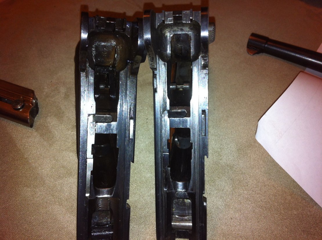

Default Hold open Question since on the subject
As I have read some lugers have the hold open and some dont. I have an early 1900 AE SN 8372 which has a hold open latch, and a couple other 1916 and 1917 which also have the hold open latches.
Seeing that the AE was one of the early versions and it has it, what vintage and contracts didnt have them
these are side by side pics of my 1900 AE and my 1916 shooter. They pretty much look the same with little differences in thed frame itself.

Luger patented the hold open in May, 1900. An angled cut improvement was patented 7 years later.
In 1901, a weapons commission complained about the number of parts in a Luger, and the hold open and it's spring were two of the parts that were eliminated.
If I remember correctly, the first issue P.08 military Lugers deleted the hold open.
Some time between 1909 and 1911, the army determined that eliminating the hold open had been a mistake.
In May, 1913, the Prussians issued regulations to restore the hold open device. They also ordered that all existing stock be retro-fitted at the Erfurt arsenal. The majority of existing pistols without hold opens were retro-fitted.
