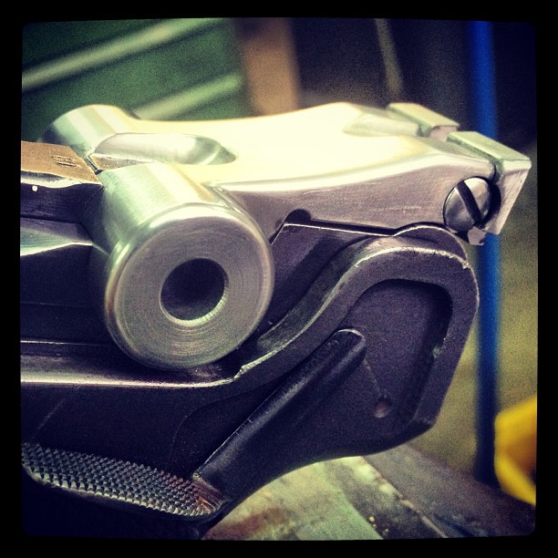

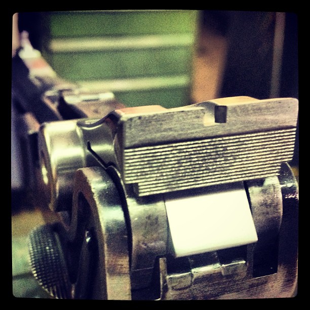

I really wanted an adjustable sight, and previously I have seen that no adjustable sights really seems to survive the violence on the rear toggle in the long run.
So here is the new manufacured toggle.
Starting with a piece of Uddeholm Calmax steel hardened to 50 HRC.
Hardening is done in a furnace in 960 degrees celcius.

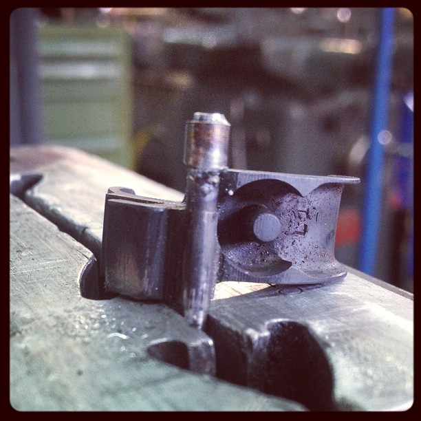

Triggerpull.
Many lugers have their triggerpulls destroyed by wrong adjustments.
So I usally weld up the sear and the firing pin with hardened steel and blueprint them to specifications.

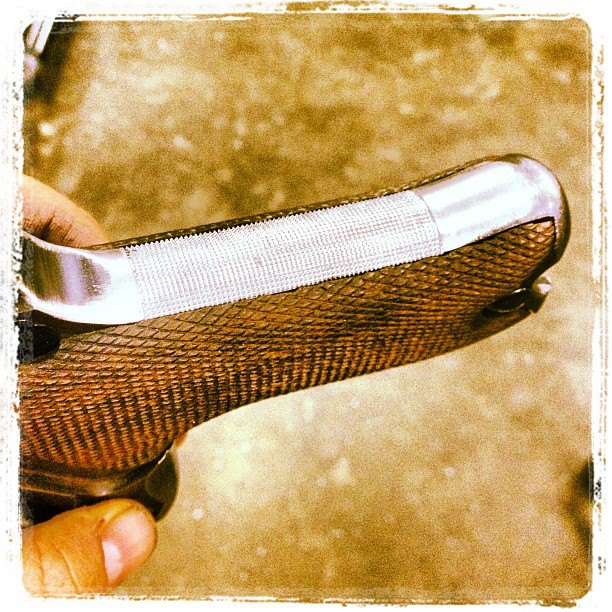

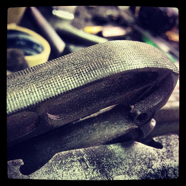

The frame with it's stocklug is much nicer if the stocklugg is removed. So here is the stocklugg removed and welded shut.
Frame gets 30 lpi checkering on both front and rear strap.

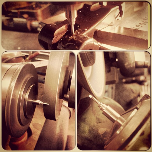

I needed to drill a couple of holes in the rear toggle, and as it's very hard my HSS drills wouldent do it.
So I made some simple cannondrills and that worked rather well.
