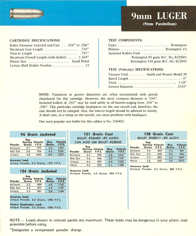

Here's a table from the 1970 Lyman Reloading Handbook 45th Ed. I like the older books because they were loading for the early pistols, not the +P+ pistols of today...
