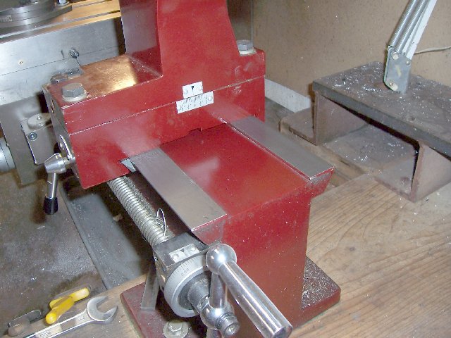

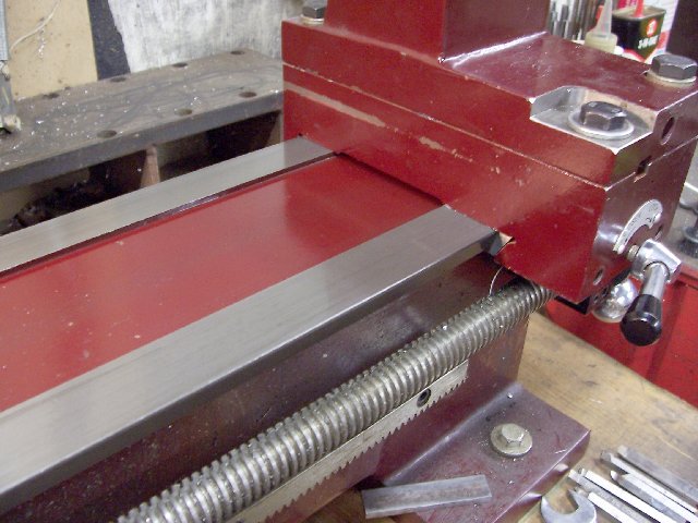

My tailstock rides on two flat ways, with the locking ways (the ^ shaped ones) underneath...If the ^ ways were on top, gravity would center the tailstock even with the lock unlocked...But since the flat ones are on top, that won't work...
That's a weird setup... My ways are on top, so pushing the tailstock down/forward held it centered. As a matter of fact, it felt like the reamer actually centered itself once I got that far.
It's a cheap setup...But it's what I got...
Flat on top and angled at the sides...It has to be clamped to be centered...
