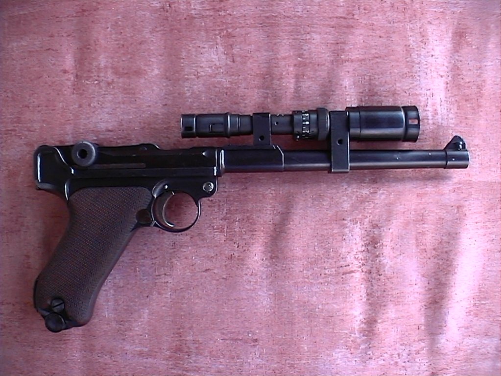

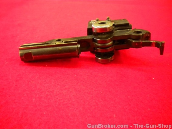

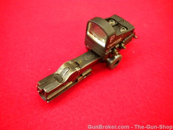

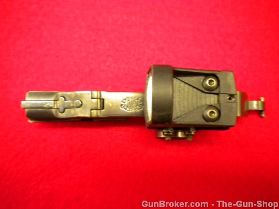

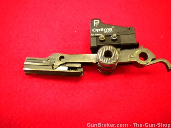

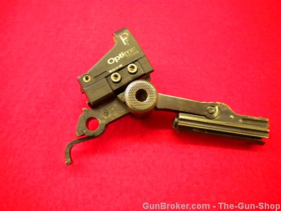

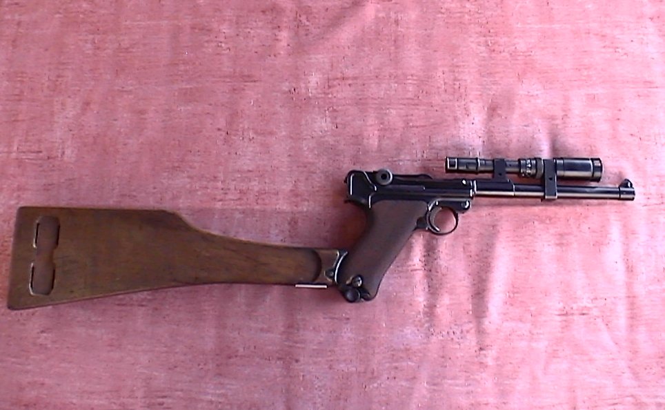

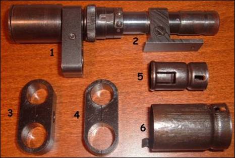

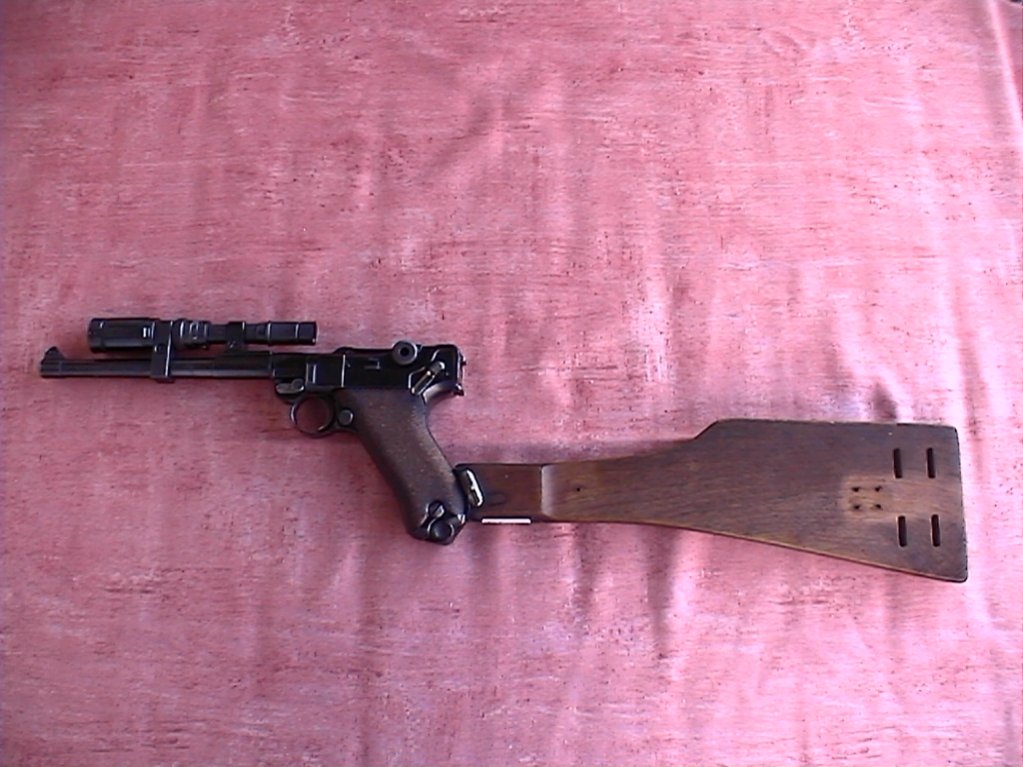

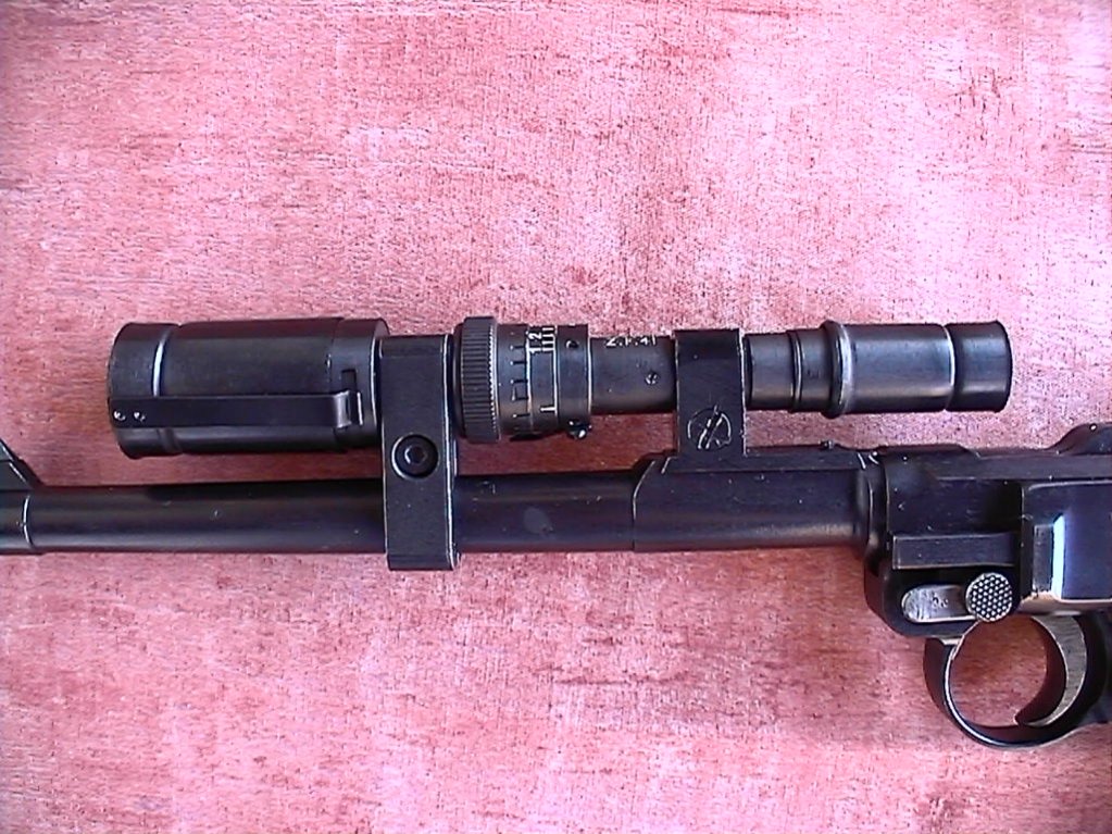

Just to re-ignite this thread with some scoped pics.
I'm currently in the process of re-barreling a target Luger, built on a re-blued 20s commercial, and am toying with the idea of machining a barrel that would accept an Ultra dot. Not quite sure how it would mount, but I'm not quite there yet anyways.

That is very interesting. I can't imagine the sight is very happy about being violently launched around though. It would be interesting to see how well sich a setup works, and how long the sight lasts for. I'm going to save and re-post these images if you don't mind. Gunbroker likes to purge all the fun stuff.
