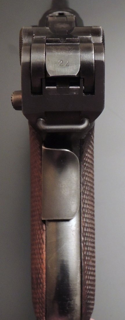

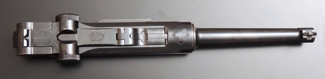

This is a 1900/06 DWM dated 1920, cal. 7,65 Parabellum, with all matching numbers, in excellent conditions, probably built for the Swiss commercial market. At the moment owned by another “serious” Luger collector. Two things above all intrigue me most about this gun: 1) Although it was built under the conditions imposed by the Treaty of Versailles on post war Germany this Luger has got a 150mm barrel, probably only because was supposed to be for the Swiss market? 2) The serial number is displayed on the side in the “military” style but it’s correctly proof-marked with C/N.
I assume is one of those Lugers made from military surplus and stock of parts that DWM had at the end of WWI. Maybe this 150mm barrel could be an interesting collectible piece? Would be nice to know somebody’s else opinion, not about price but about its historical meaning.
If original, I'd think so. Commercial Lugers made in the 20s have lots of variations, either built as such at the factory, or later customized for their clientele by the resellers...

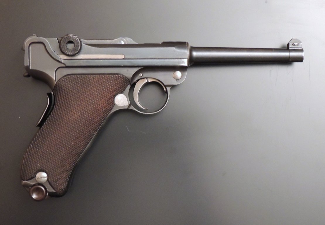

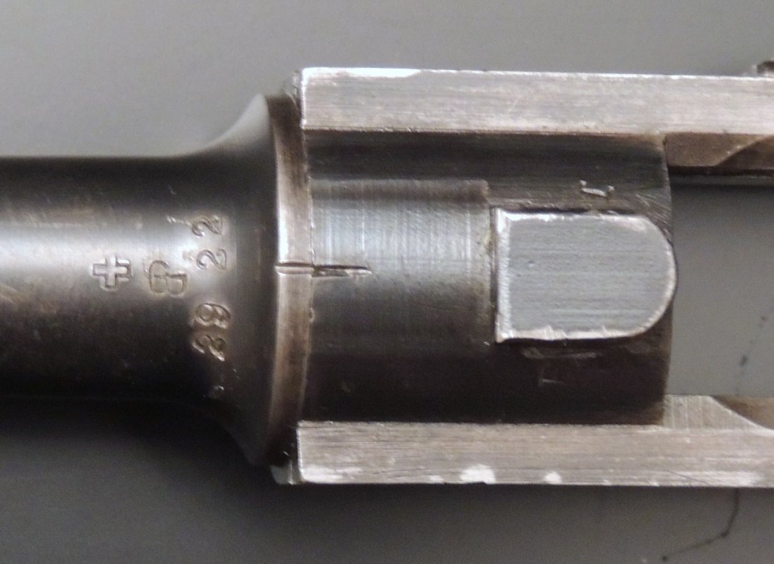

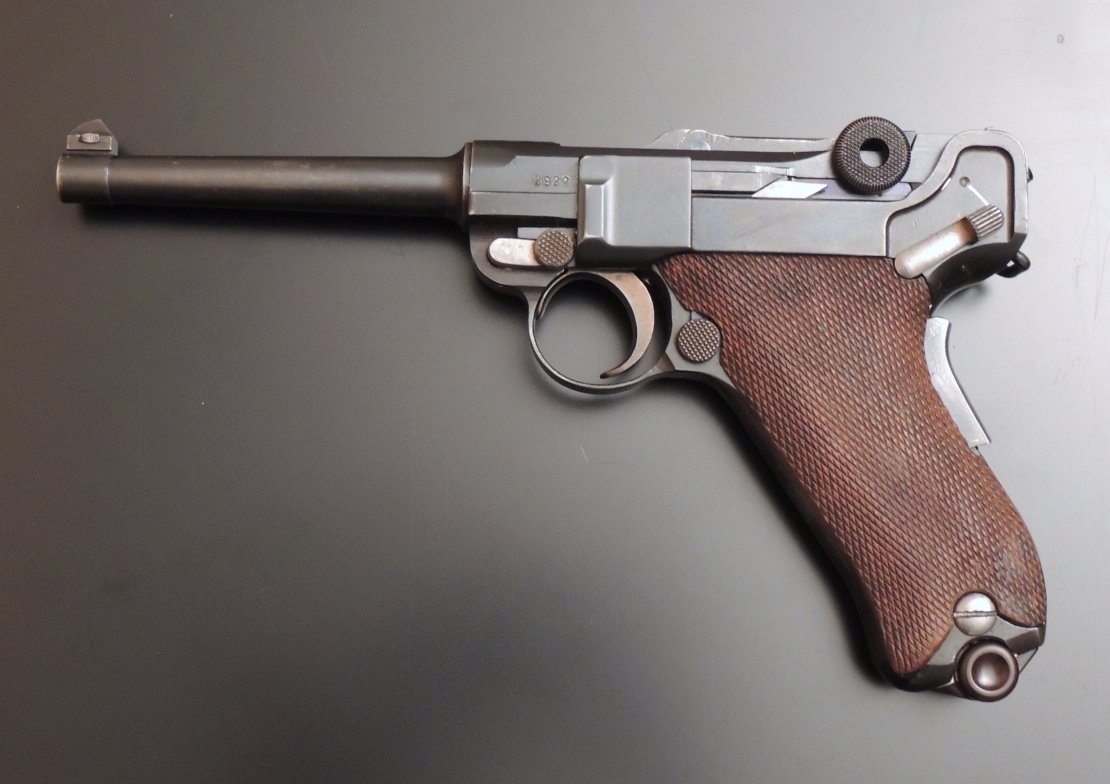

Stucki
Stucki's Avatar
Posts: 84
Thanked 130 Times in 34 Posts
here is another one: Swiss 1906 Commercial, 7,65mm, 120mm barrel, SN 2922i. Probably delivered after 1930 without barrel. Unusual is, that there are no German proofs (C/N), only the Swiss Bernerprobe/Beschussprobe is on the barrel. The front toogle is not numbered and on the breechblock you can find a number 12 on an unusual place (is it the SN?). The gun was reblued somewhen (the blank spot under the safety lever is blue). The magazin is Swiss origin.

The i-suffix DWM alphabet commercial pistols were made in 1921. A few long-frame, grip-safety examples are known. Most have the Swiss cross-in-starburst chamber mark, conventional wisdom has them marketed in Switzerland. A couple are known without chamber marks, these would be simply called commercial.
By 1930 DWM was out of the Luger manufacturing business.
Judging by the witness mark in the photo above, this pistol assuredly left DWM with a barrel intact. The present barrel was installed in Switzerland, proofed with the Swiss Bernerprobe.
The absence of the German c/N commercial proof is puzzling. It would be interesting to see very close-up pictures of both the right and left sides of the receiver, and the left breechblock and center toggle.
