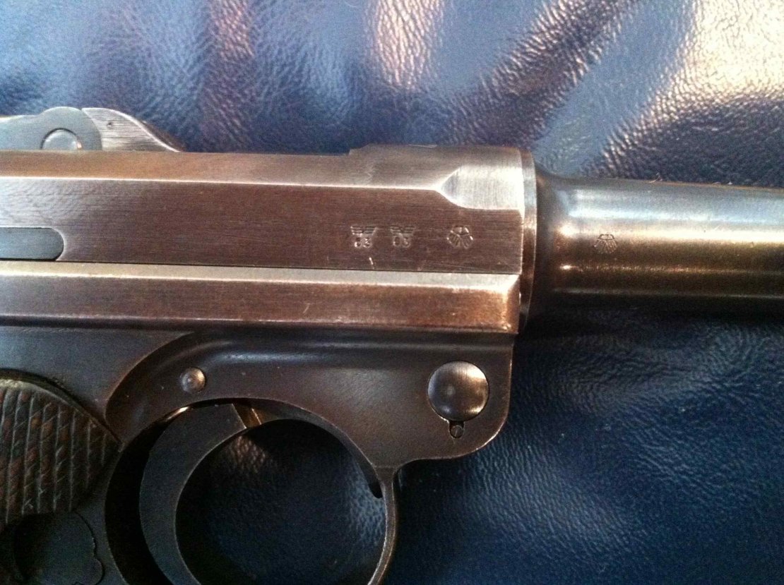

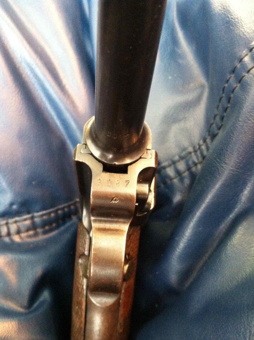

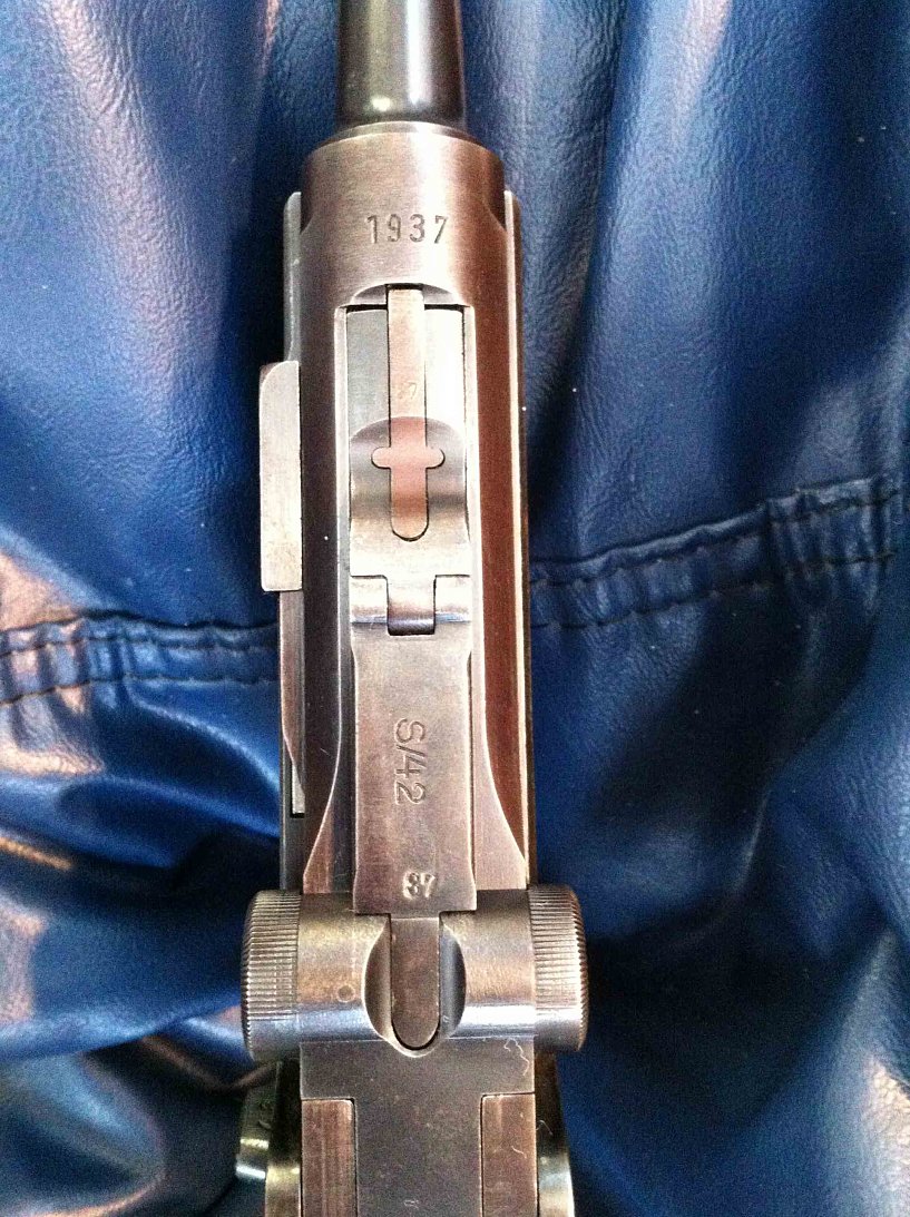

Here are some more pics. It is a 1937 Mauser (S/42). It has 87 on everything. On the front part of the trigger group (not sure what that part of the gun anatomy is called) under the barrel is a cursive "a" and 3087. 3087 is also on the bottom underside of the barrel. No strawing. I was told the magazine did not go with the gun but was of a similar era. The markings that I can not identify on the barrel have 63 under the eagles (I think that is what they are) and I am not sure about that mark to the right of the eagles and there is the same mark further right on the barrel.

You have a military accepted 1937 Luger manufactured by Mauser.
The SE/63 SE/63 DE (Stick Eagle over 63 Stick Eagle over 63 Droop Eagle proof mark) markings on the receiver are inspector acceptance markings and the proof marking. Same thing with the DE on the barrel.
Your Luger is s/n 3087a. The letter is a suffix and part of the serial number.
It was made late in 1937, perhaps November, and is one of 38,212 in that variation.
S/42 indicates manufacture by Mauser in Oberndorf, Germany.
This pistol is most likely all salt blued, including the small parts. It looks to me to be in the original finish.
