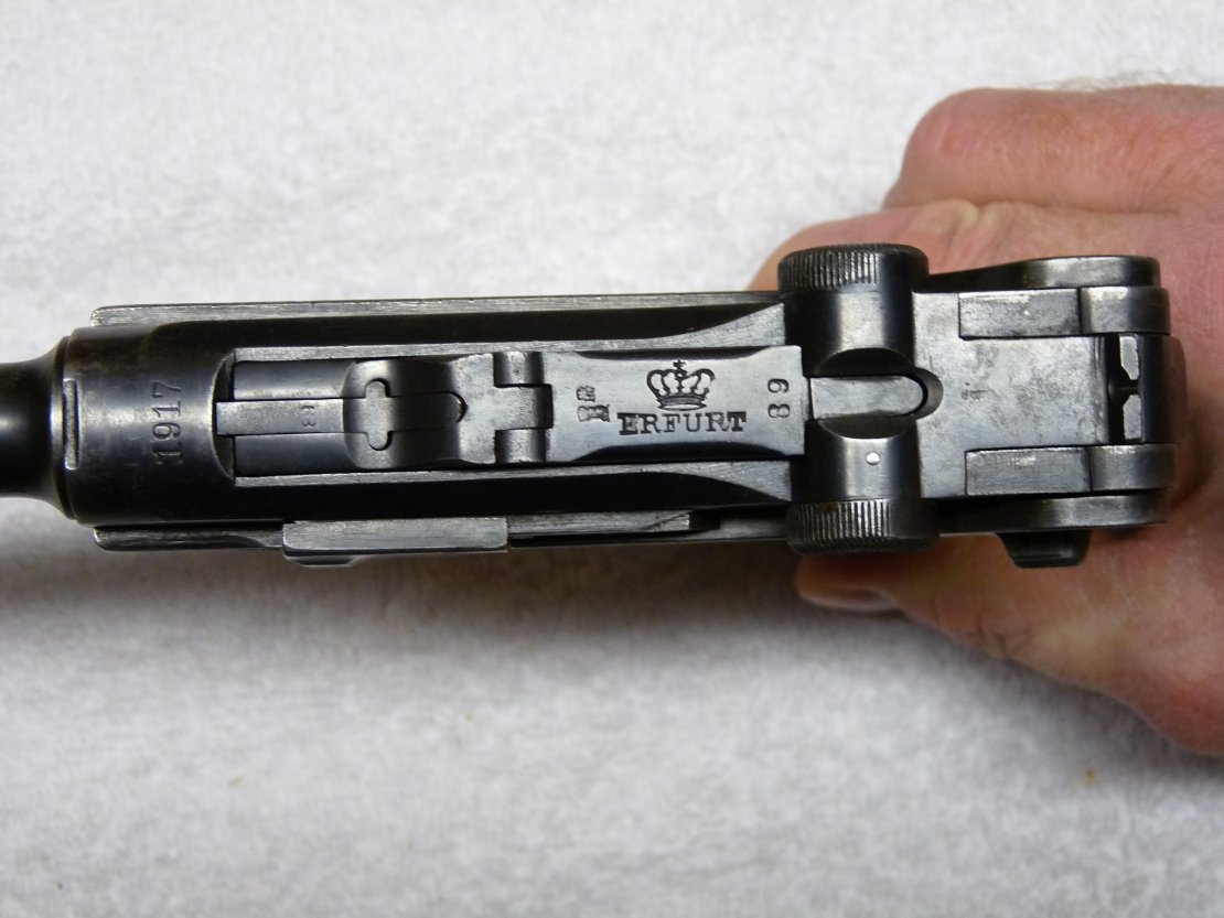

I’ve acquired a Luger from my Grandpa and would like any information you can give. By using the technical information from the forum was very helpful. But, still seek more. 1917 is stamped on the chamber and the ERFURT is on the toggle. The serial number is 6789 with suffix “j”. The proof marks are what are throwing me. I think they are #16, (German military receiver proof. Found on Erfurt Lugers produced 1908-1918). Grip type seems to be checkered Walnut and the word “GESICHERT”. Under the safety. The last two numbers of the serial number appears all over the gun as well as one of the magazines. Under the barrel is 6789 with “8,83”. The plate has “J” with a crown above and “89”. There are several other makings on the barrel top, an eagle and small “X”. The only issue it seems to have is that the toggle won't stay up when magazine is empty.
Do you think I could shoot the gun? What would be a good load for it? How about replacement magazines? Could you suggest someone that makes them? On some links I see a reloading tool. He didn’t have one and the holster that he has doesn’t have a space for one in the flap.

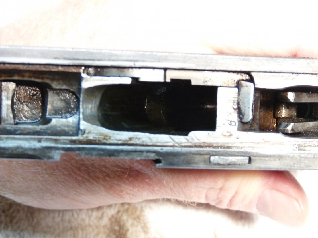

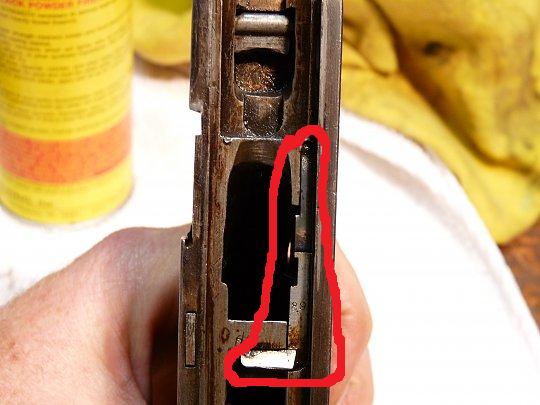

Howdy, your gun might be missing a holdopen device or it could be a little out of whack or they didnt produce that gun with one. If you take a pic of top of the frame without the barrel and receiver on it looking down into the trigger and magazine well this problem could be solved. If you could take a picture of the eagle and x on the barrel too that would be great.

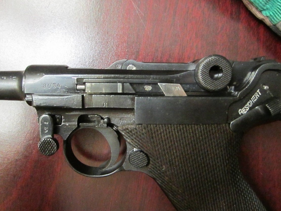

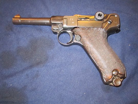

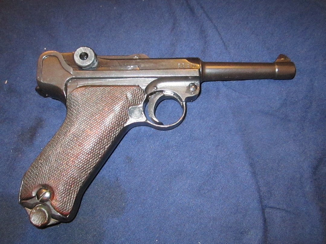

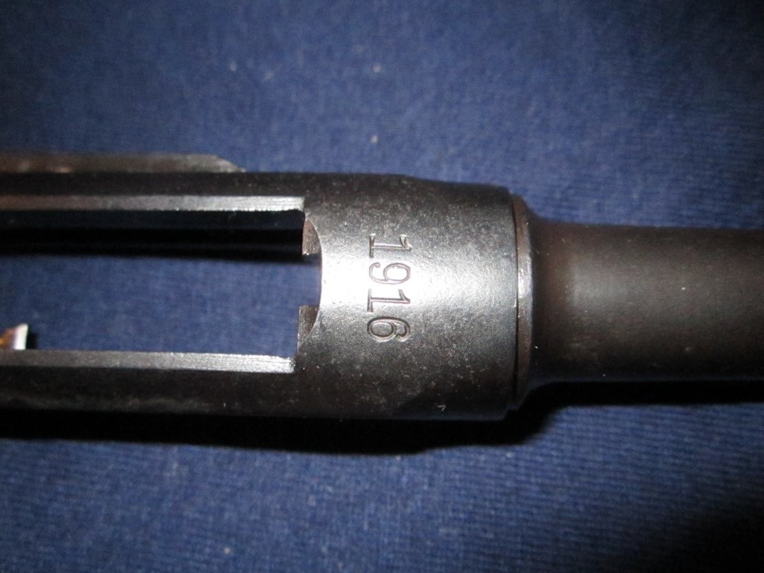

Nice luger there. I noticed the alphabet letter on your "j", which I also have a "j" letter luger. Mine has a miss match toggle though. I just dont a whole lot of "j" model lugers.
Maybe some experts out there can help me out with the years on them. My serial number is 8034j with the year 1916 stamped on top of the receiver. I noticed this one to be a 1917 vintage luger with a lower serail number.
Did they make the same letter suffix having two different years on them? and the serial numbers, his being lower than mine but mine having an earlier date. Is this possible?
My barrel and receiver and all the lower part of the gun seem to match. So... Im just curious.

I’ve uploaded some pictures of the barrel and the frame looking into the magazine well. Thanks for your help.

Looking at the markings on your barrel, mine have the exact markings.
The crown/RC on the barrel represents that at one time the part was found to be out of spec in some minor way, but still servicable. The part was sent to the Revisions-Commision for inspection and certification. This stamp was applied to the part for its usability and makes the inspector not liable if the part fails.

Hi , the mark on the barrel is an erfurt proof mark typical. The yellow on your letters is just oxidized or the like. You can buy a new stick of machine marker and reapply if yant to.
You have a hold open on your gun it may not be bent at the proper angle you will have to pull it out careful of springs or parts flying out and gently manipulate the bend and reassemble repeat until action stays open. It might be that your magazine spring is worn and the follower doesnt have enough power to apply sufficient pressure to the hold open. A new repro or other mag or replacement spring may be required but try cleaning and tweaking the holdopen first. heres a pic of the holdopen. looking closer it might even be broken. should be a solid piece. woudnt hurt to clean with hoppes and q tips then a good coat of oil in there either.
