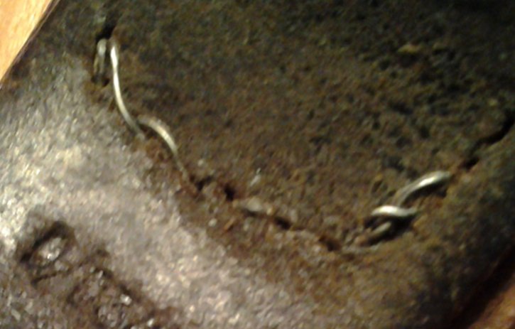

I am not an expert, but I do think the holster is orginal. On the backside, on the right loop, appears to be a field repair with metal wire? I have a old orginal Heer belt that also had field repair with metal wire...The P08 looks as though it was done after leather was darkened...the proof marks look good to me. Possible the P08 was added by West germany, or DDR...Austria?

Here is my wire repair...
