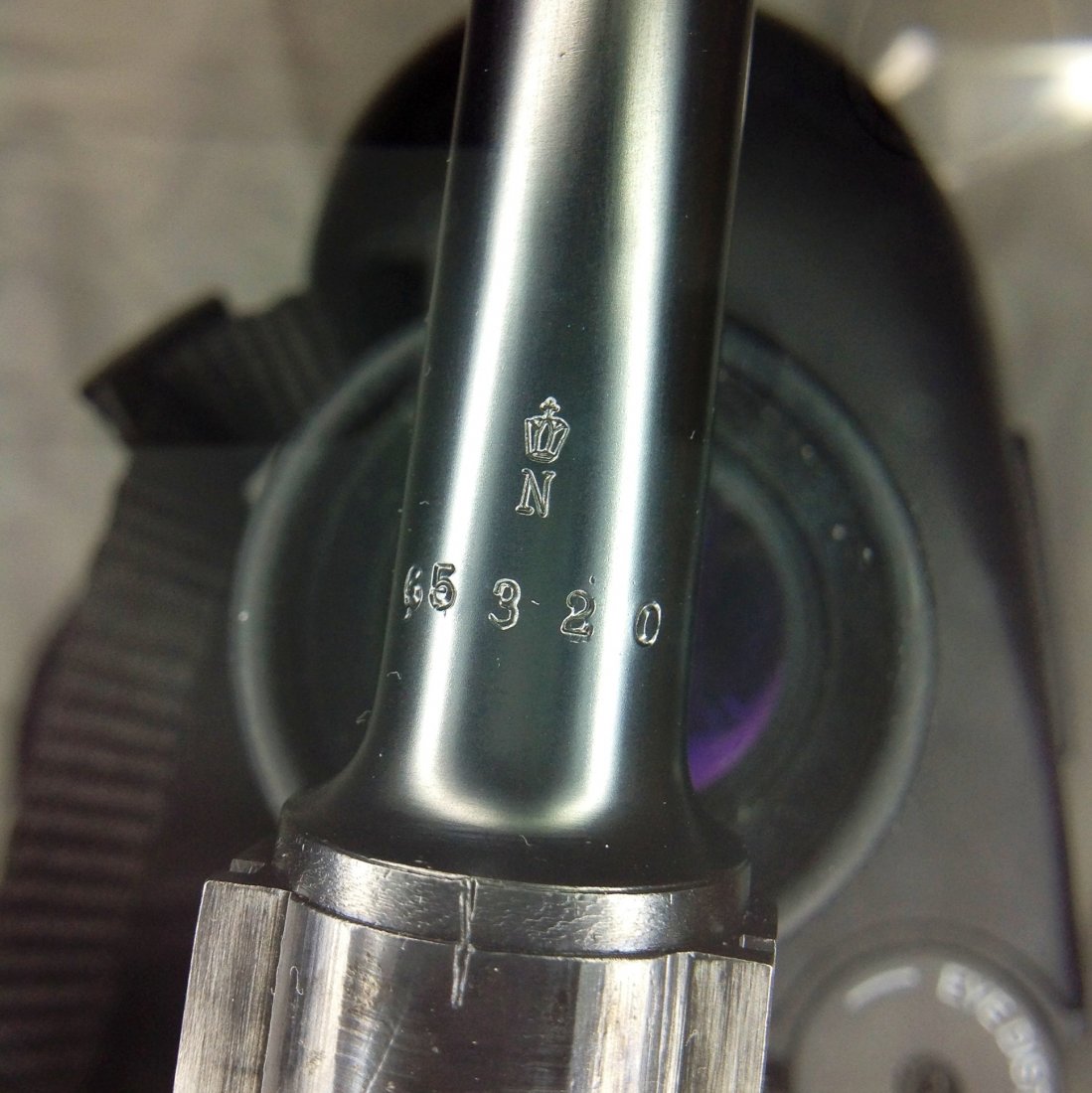

Default Best I can get
B close up

Unread 01-23-2013, 06:01 PM   #42
If you can find a friend with a closeup lens on a camera it would be very helpful. We need to see fine enough detail to determine if the c/N is stamped, engraved, or pantographed.

Default Try this
See if any better

Unread 01-23-2013, 09:13 PM   #45
Very much better, thank you. Good enough to see that the c/N and barrel serial numbers are clearly pantographed. Authentic proof marks and serial numbers are stamped, without exception.
Also glad to see the witness mark, notice that the barrel flange is slightly smaller than the receiver, and the witness mark itself is a hash of strikes, neither characteristic of DWM "fit andf finish."
Unread 01-23-2013, 09:37 PM   #46
Classic Captain
Join Date: Dec 2012
Posts: 56
So what do we have here?
A re barreled p08 short frame , value?
Classic Captain is offline   Reply With Quote

Unread 01-28-2013, 01:51 PM   #48
Ben M.
Ben M.'s Avatar
Posts: 499
Thanks: 112
Thanked 157 Times in 98 Posts
is seems like the barrel shoulder flange is very thick. is this normal or an indication of a replacement barrel?
Unread 01-28-2013, 02:13 PM   #49
Ben,
This is an aftermarket, not quite finished barrel that someone placed on the gun and force matched with spurious barrel markings.
You are correct in that the flange is too thick.
