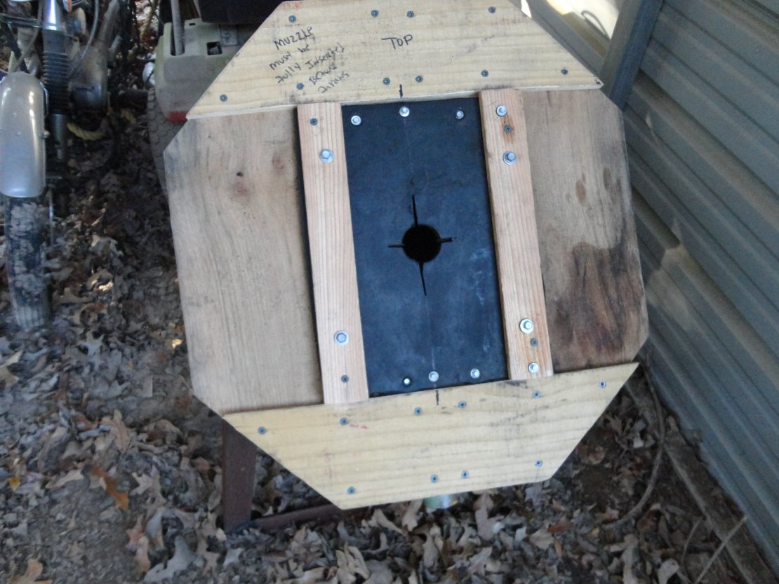

anyone care to take a guess at what this is or is used for?

Bullet Catcher ?

Looks just like the clearing barrels we used in the army
Except for the muffler!

bingo

you are both correct, now my neighbors won't be so startled

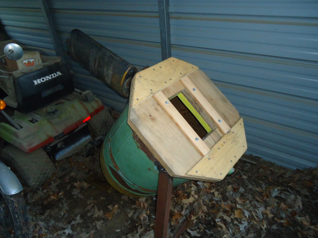

this one will contain the muzzel blast and noise thats why it has a muffler attached to it.

I thought perhaps the muffler was a joke...Or part of the Honda ATV...But it's actually part of the clearing barrel???
How effective is it??? Is the entrance aperture curtained, maybe by a thick rubber sheet with a slot in it???
Some years ago, when I was working as an automotive mechanic, I was impressed by how quiet a Cadillac I was working on was...Over the years, when working on rifles or handguns that needed testing (but not accuracy), I thought of that Cadillac...and its muffler...
I have enough land that shooting into a berm wouldn't be any hazard to neighbors...But the noise might be offensive...I've thought of fastening a Cadillac muffler to a bench and firing through it into a berm...Using some kind of rubber sleeve to protect the muzzle......
I've used handgun clearing barrels (usually 55 gal drums full of sand) and even a ceiling mounted clearing barrel for M16's...But a 'silenced' clearing barrel is a new one...
Thanks for posting! Please expound further on the silencing qualities!

it is not completed yet, but it will have the thick rubber over the firing hole as required, it is a bit over built using heavy wall 22 inch high pressure pipe as the structure , the muffleras stated was attached to reduce the noice of the muzzel blast, here are a set of directions the military uses for construction of a clearing barrel. http://www.usarak.army.mil/policies/...20Encl%203.pdf

test firing a .22lr is just a whisper or pfffft, ..38 spl and 9mm a bit more , 762x 39 the loudest but greatly reduced , since it will be used for live firing and heavy calibers ,it is built to heavier thickness than normaly would be required ,

since it will be used for live firing and heavier calibers beyond the 9mm m9 and .223 m16 it is somewhat over built. better to be safe than sorry.
