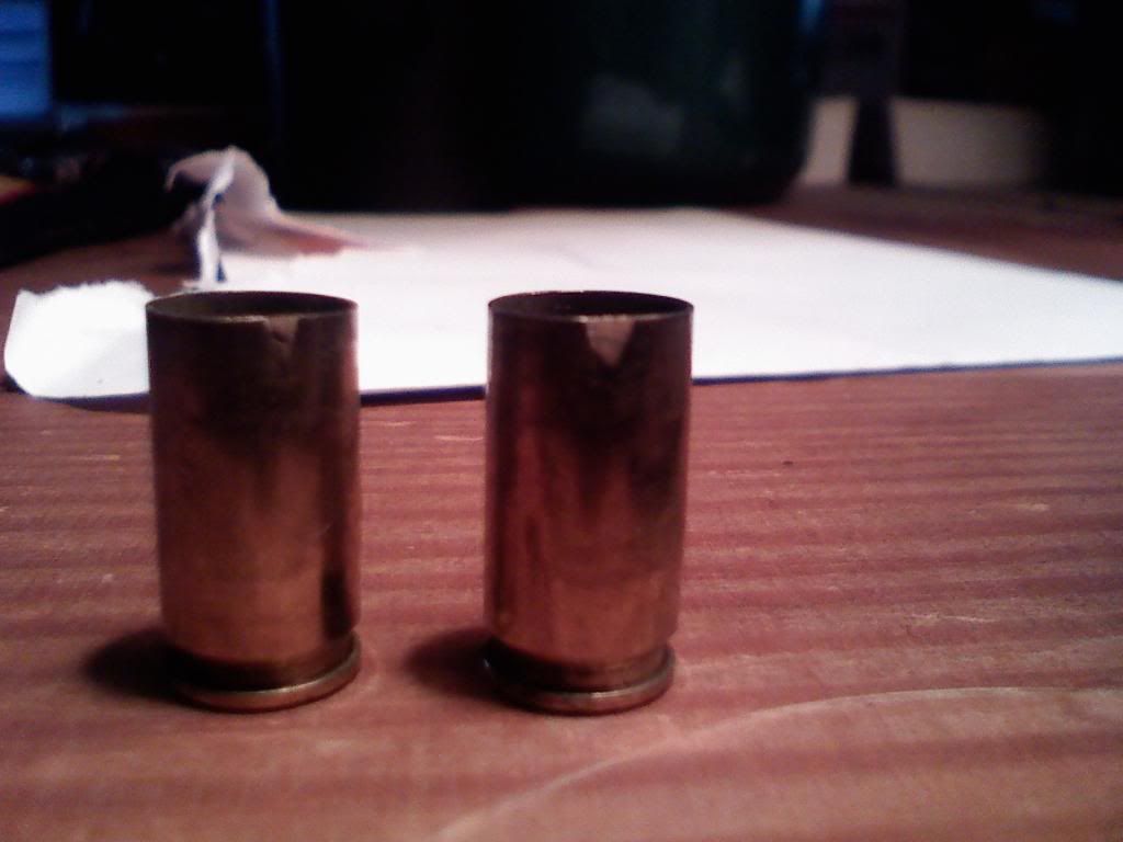

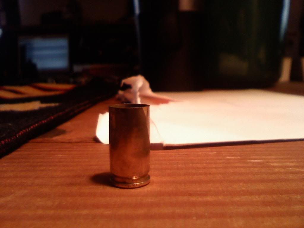

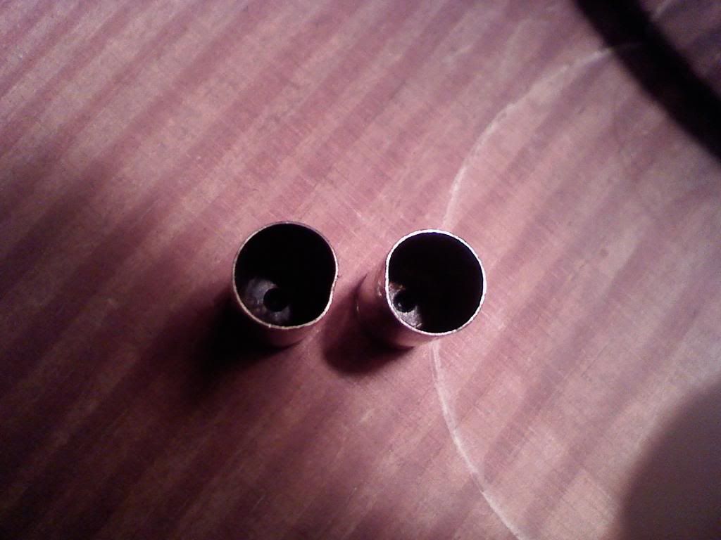

So it seems to me like my spend casings are crimped/dented on the side after ejection. I noticed after shooting a bunch of rounds that the crimped part/dented part is actually having pieces of brass being shaved off of it at some point in the firing/ejection process and it's spreading those shavings all over my Luger. It gets everywhere and it's scratching my finish I thought I read somewhere else on this forum that the crimping of the rounds is normal, but lugerdoc said it wasn't. I've been using WWB but it does this for all ammo, honestly.
I stopped using the original mag once I got my 2 new mec-gar magazines but those don't seen to help this brass shavings problem.
Also, 50% of the time the action doesn't like to stay open after shooting the last bullet. about 40% of the time the action stays open with 1 bullet remaining. What's going on with that? It's happening with my 2 new mec-gar mags and my original mag. Here are some pictures. Sorry for the massive size and bad quality. I just want to get this fixed!
it does this to all the ammo, although sometimes it's not that crimped/dented. Most of the time, however, it's pretty dented.
as you can see here, the casings are pretty dented. Not sure if this is normal

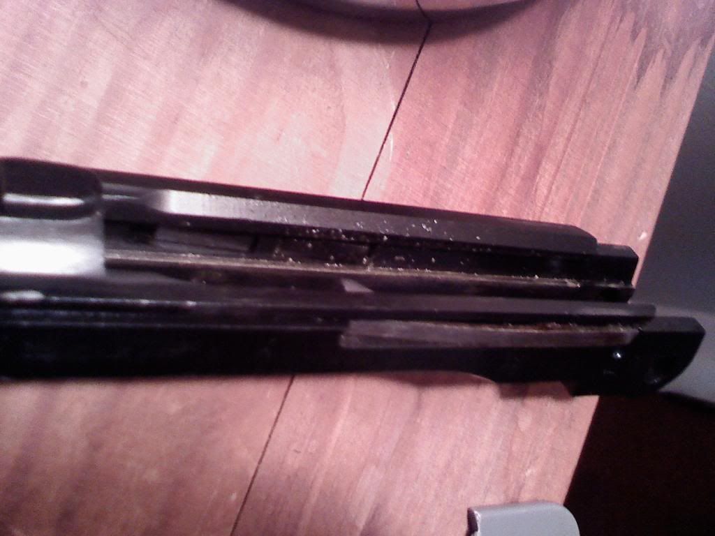

this is where the majority of the built up is. The brass just grinds in there and scratches everything
As said earlier, this stuff gets everywhere including all down into the grip area.

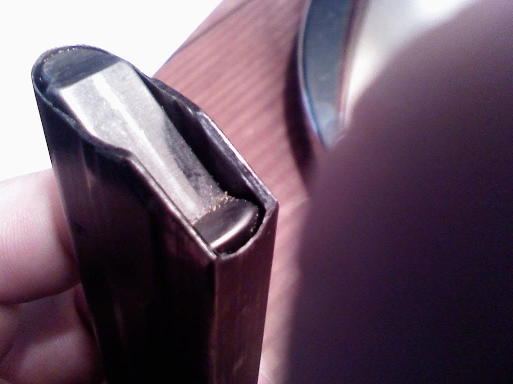

here's some of it on my original magazine.

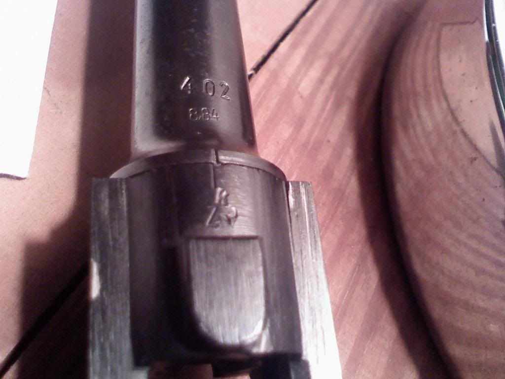

What does the breech throat area of your barrel look like?
Unread 10-30-2012, 05:36 PM   #5
I agree with Marc that I would be looking at the breech throat or the feeding ramp for a sharp edge or anomaly. I think this is more likely happening upon ejecting so there is little danger of overpressure, but the spent shells are clearly hitting something upon ejection with considerable force.

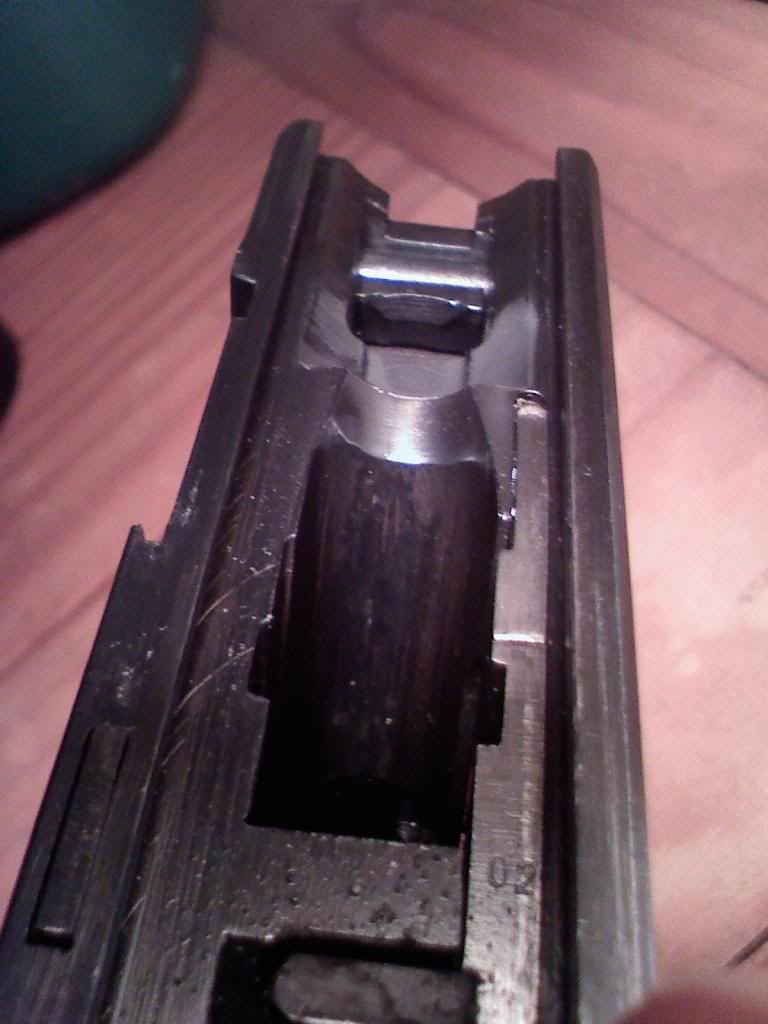

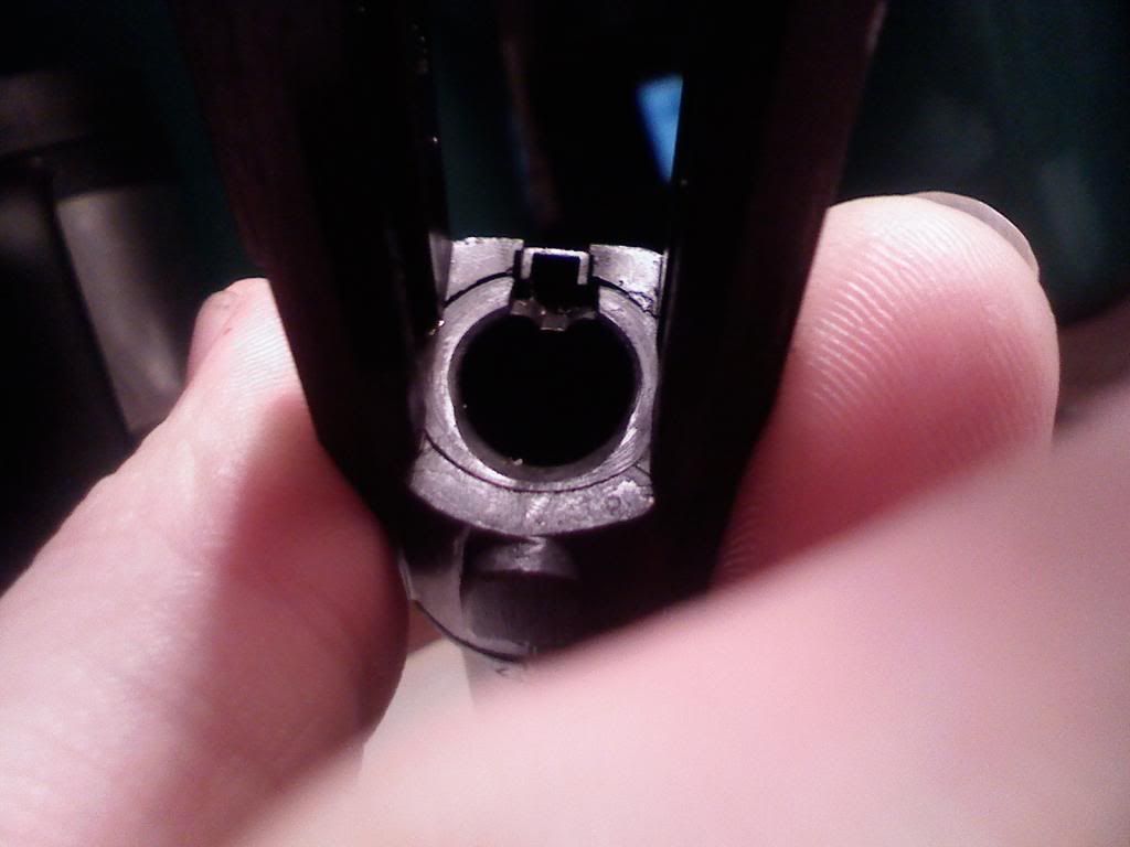

Here's the breech throat as best as I could get it, as well as the feedramp (I think...)

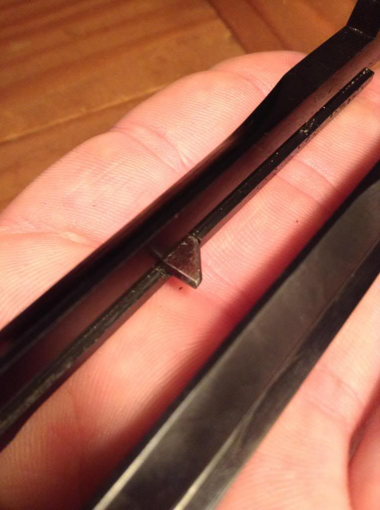

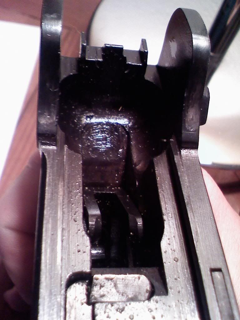

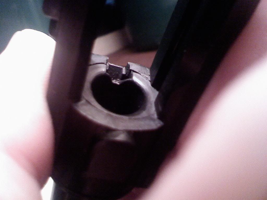

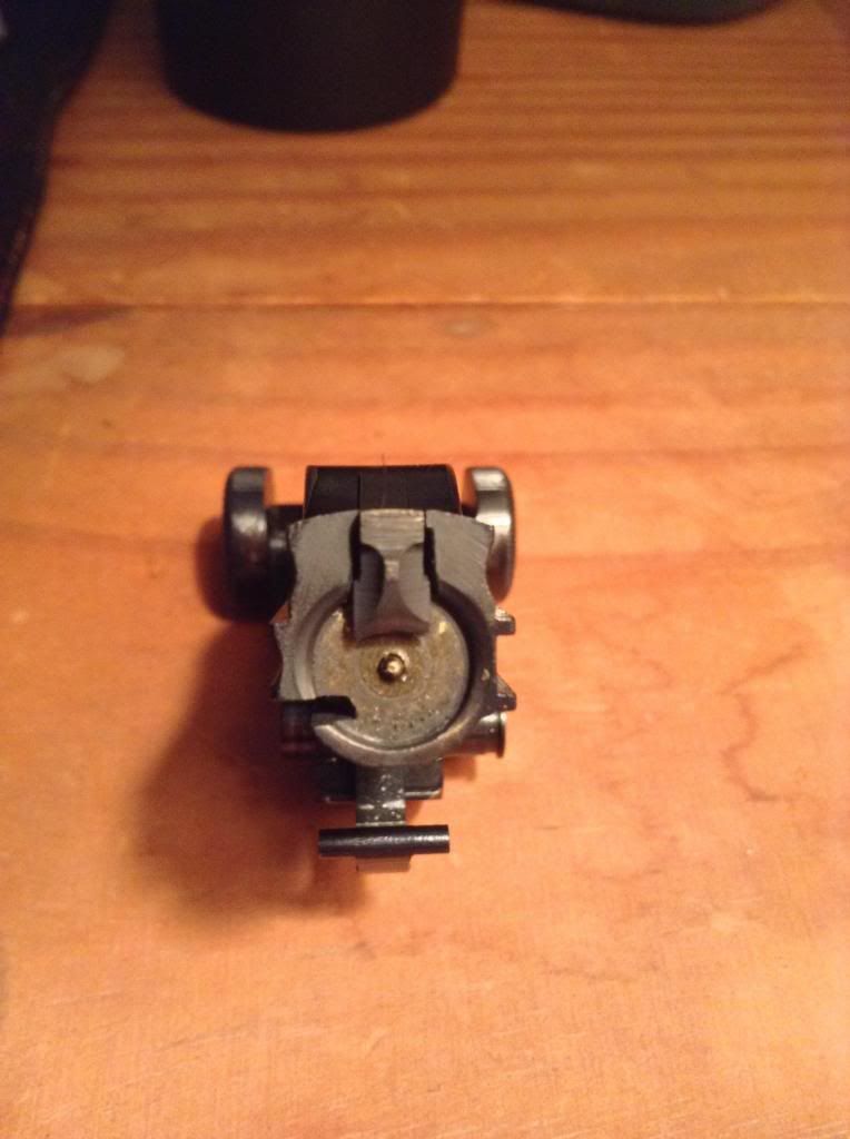

What is that "U" shaped piece at the top of your extractor groove? That does not belong there!?!
Please take a photo of this area from the top of the pistol looking down. This right here may be your problem. I also don't see how a normal extractor could fit in the groove with that piece in there, so a photo of your extractor would also be useful.
Jerry, you may have been onto something after all!

I believe that the "U" shaped "problem" is just an optical illusion caused by the angle that the photo was taken. So long as this part of the received doesn't extend into the extractor cut of the barrel, it should be OK. Too many of you chasing Zebras. Unually when the case mouth of a spent case is crushed, it's a result of the toggle returning faster than the case can eject. There are several possible cause of this, but with the lack of HO after the last round, I would postulate that the recoil spring is too strong for the ammo being used. Cutting a link or two off of the current recoil spring, should solve this problem. Of course it would be a good idea to also check the condition of the extractor and ejector, which can also delay case removal. TH
I hope that's what you were looking for :/ I'm still going to try your idea; just haven't been to the range yet.

here's some photos of the extractor and ejector. I'm new to lugers so I don't know what abnormalities in which I may be looking
It's a bit dirty.. sorry! Wanted it this way for the photos though

Looking at your photos, and noting that you are using WWB, I don't think the "brass" you are seeing in the pistol action is brass at all. WWB is loaded with ball powder, and in my experience it leaves some unburnt powder particles in the action after firing. These particles are a yellow / brass color as the deterent coating gets burned off, and are very small spheres or flattened spheres. To the average shooter they do appear to be "brass" particles, but instead are simply unburnt pwder particles and are quite normal when firing ammo loaded with some types of ball powder. I see this all the time when firing my Sigs with Winchester ammo...

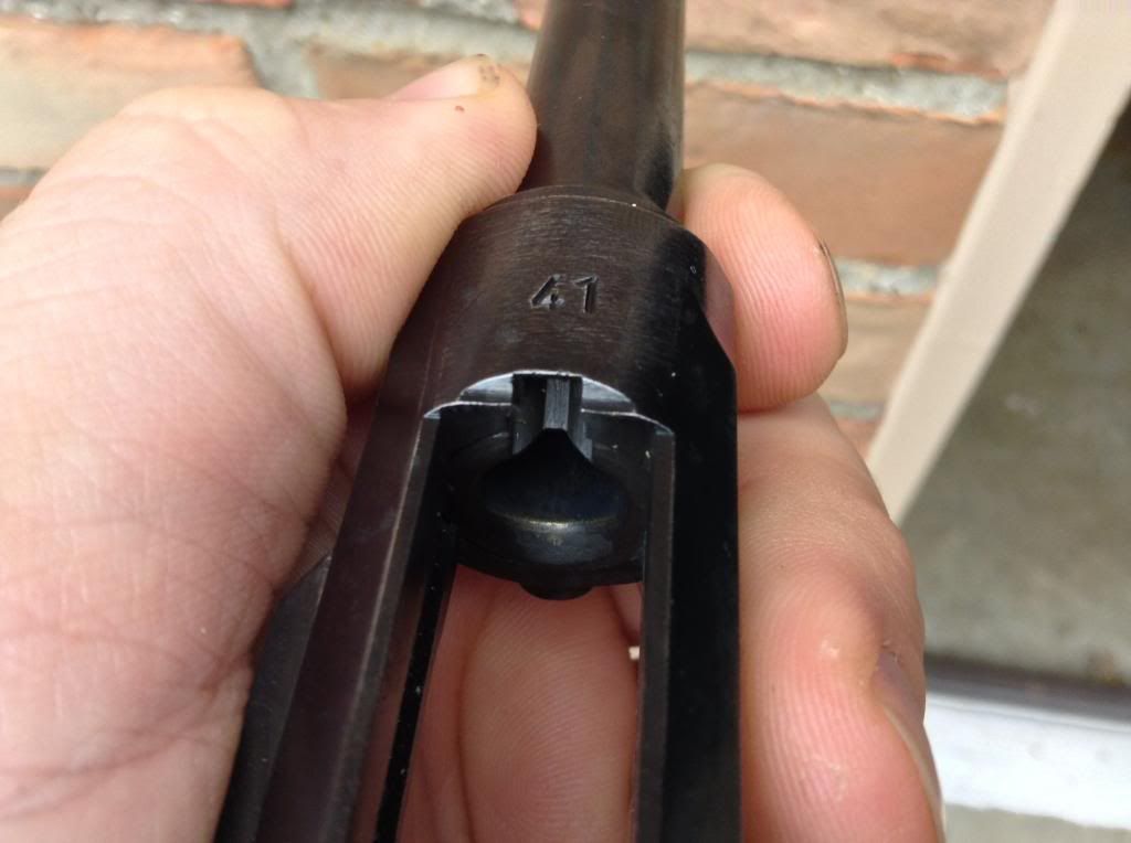

It looks like the barrel is not rotationally aligned in the receiver. Note the lack of symmetry at the extractor cut.
Note how the left side of the cut is vertically aligned, and the right side of the cut has a step.
Does the barrel witness mark line up, and is the front sight perfectly vertical to the receiver and frame?
Excellent info. It's not that I don't believe you or don't want to take your word for it, but these brass looking shavings are also shiny like they are on the casings. There are also large bits/chunks/strips of this shiny brass colored material laying here and there around the different parts of the gun. Is this powdery residue you're speaking of shiny as well? It shines when light is put to it.
Now that you mentioned it, I see a lack of symmetry in the area you're talking about as well as a misaligned witness mark. Here's a photo.

Unburnt powder particles can look shiny if they are covered in oil or when you shine a bright light on them. Powder particles are round or semi-round flattened spheres, often very small. Powder particles would not be in the shape of strips, or rectangles. My guess is that most of what your seeing is powder particles, with probably some real brass particles thrown in too...

should I get my proof marks aligned? (see picture 2 posts up)
