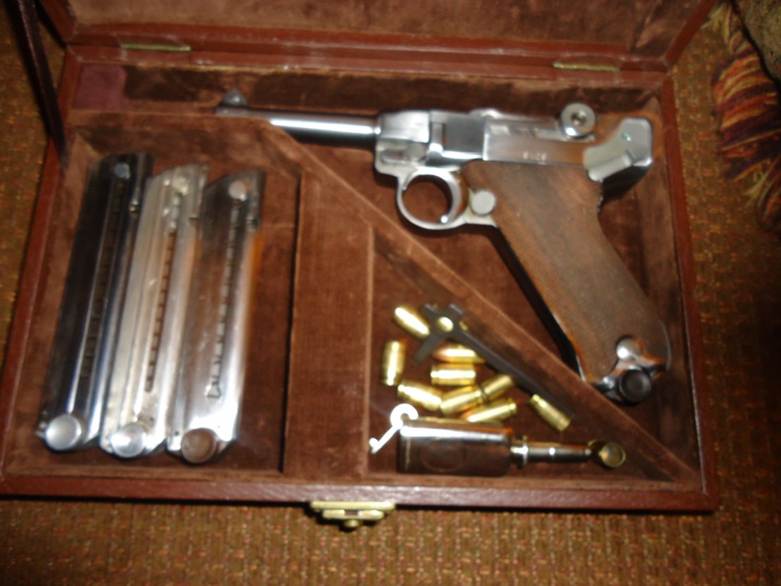

not sure who made the case , it came with one of my dwm's. i use both the wooden bottom mags and the aluminum bottoms one with it as well , it has worked well with all of the mags.

haven't decided which case i like best to display it. yet. both look pretty good.
