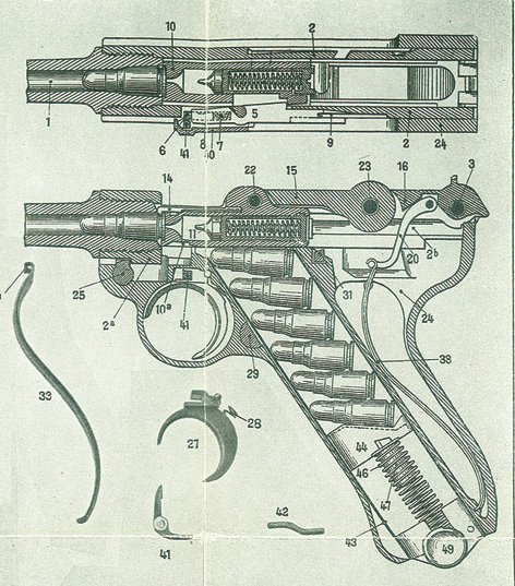

Can you tell me what/where to look to figure out why the breech isn't closing under spring pressure??? I can't even find a cutaway view of a 1900 to see how the mainspring fits...
ETA: My favorite auction house has a manual for a 1900 Swiss with a good pic of the fold-out from the manual (which they estimate will fetch $700 - $1200)...
Anyone know the most likely spot for problems??? I'm hoping it's something simple...Like the mainspring not being seated in the grip bottom...

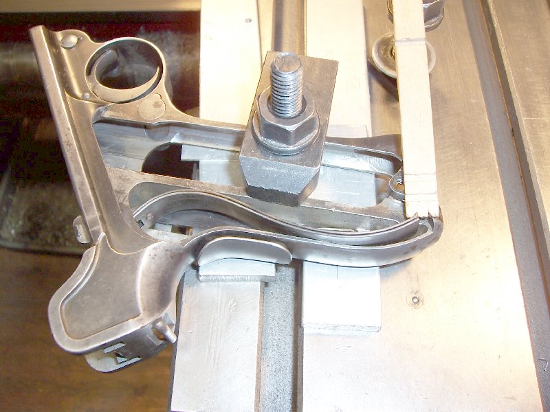

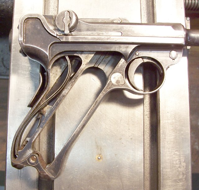

Got the 1900 put on my PP and brought it home today...I lucked out...The mainspring is OK...
When I took the grips off and turned it over, I could see the toggle link flopping back & forth...Not sure how that got loose...The claw on the mainspring wasn't catching it...I poked it a couple times, and it engaged, and now there's no "slop"...
...Just 111 years worth of crud...
Is the mainspring supposed to fit in a slot at the bottom of the gripframe???

Rich,
Congratuations on a nice looking (from the one pic) 1900. You have put the spring where it belongs. The spring did not come off by itself, probably someone assembled the gun wrong. Nonetheless, if you plan on shooting this thing, I still suggest acquiring a replacement recoil spring (I have two spares) and an extractor, and an ejector (Lugerdoc). We await a full set of pictures.
KFS
No. The drawing you posted does not show how the spring actually fits (Egad!..an error in an old document) The spring just tucks up under the lug at the bottom of the grip. There is nothing wrong with your gun. Glad the mainspring is OK. I kind of suspected the toggle hook was not engaged but didn't get around to posting. Sorry...but then think about the fun you had finding out!

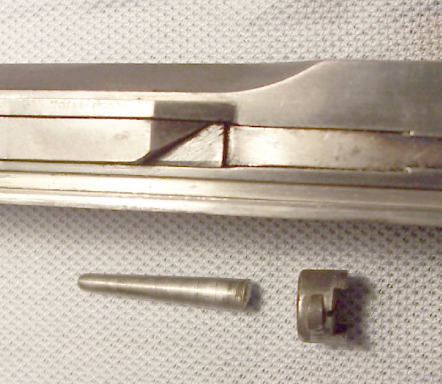

I cleaned out the firing pin cavity and found the firing pin spring retainer [guide?] was broken. I also don't know how I'm going to remove the trigger bar as the trigger bar spring has no 'bend' on the front end...I need to clean under it...
The magazine also had a buggered-up wood bottom...It looks homemade...And the mag sticks/rubs when inserted/removed...
Grips are worn...Oddly, the grip screws aren't buggered...
The bore is...Well, every time I wash & brass-brush it, I get more crud out...(Four times so far)...But it still looks worn & frosty...
Yep...It's a mutt...
Edit: I got the TB spring to move, so i know I can get it out...and a P08 FPS retainer (from my S/42) works, so it functions...Sort of...

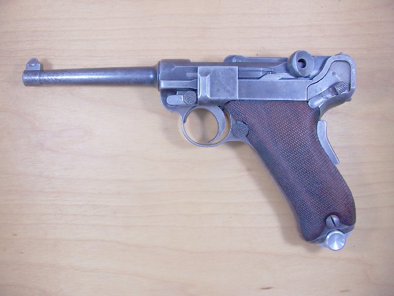

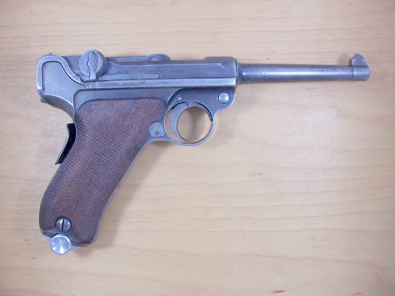

Originally Posted by Karl View Post
Congratuations on a nice looking (from the one pic) 1900...We await a full set of pictures.
I don't have a full set, and my magazine is out for repairs, but here's a sneak peek...
The seller wanted four times what the experts here thought it would be worth...But I managed to negotiate it down to only three times what it's worth...
