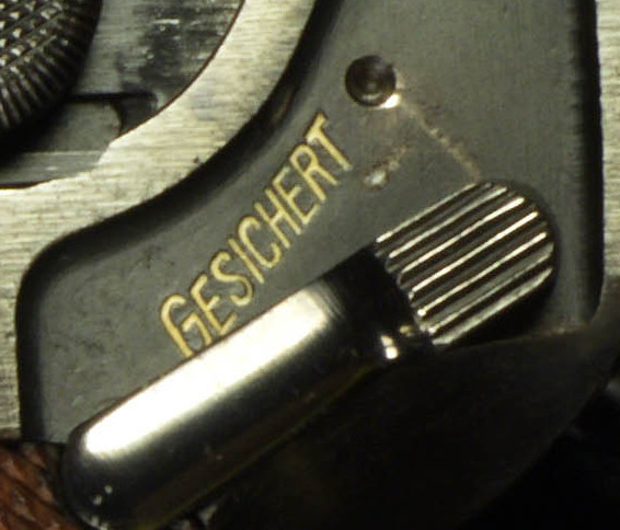

There are some details about this Luger that don't seem right, don't seem original, but would appreciate some further expert evaluation.
Sideplate finish looks different than adjacent frame ?
Safety lever finish not strawed ?
Blue ( especially on frame ) appears to be the thinner salt-blue characteristic of late WW2, not the rust-blue I thought belongs on this gun.
What do you think about it ?
