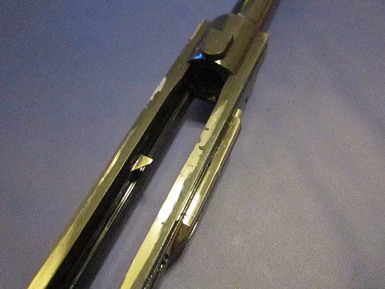

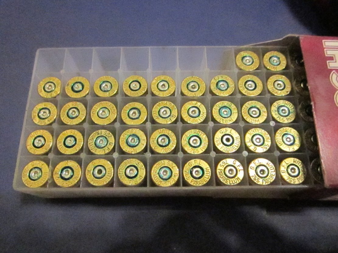

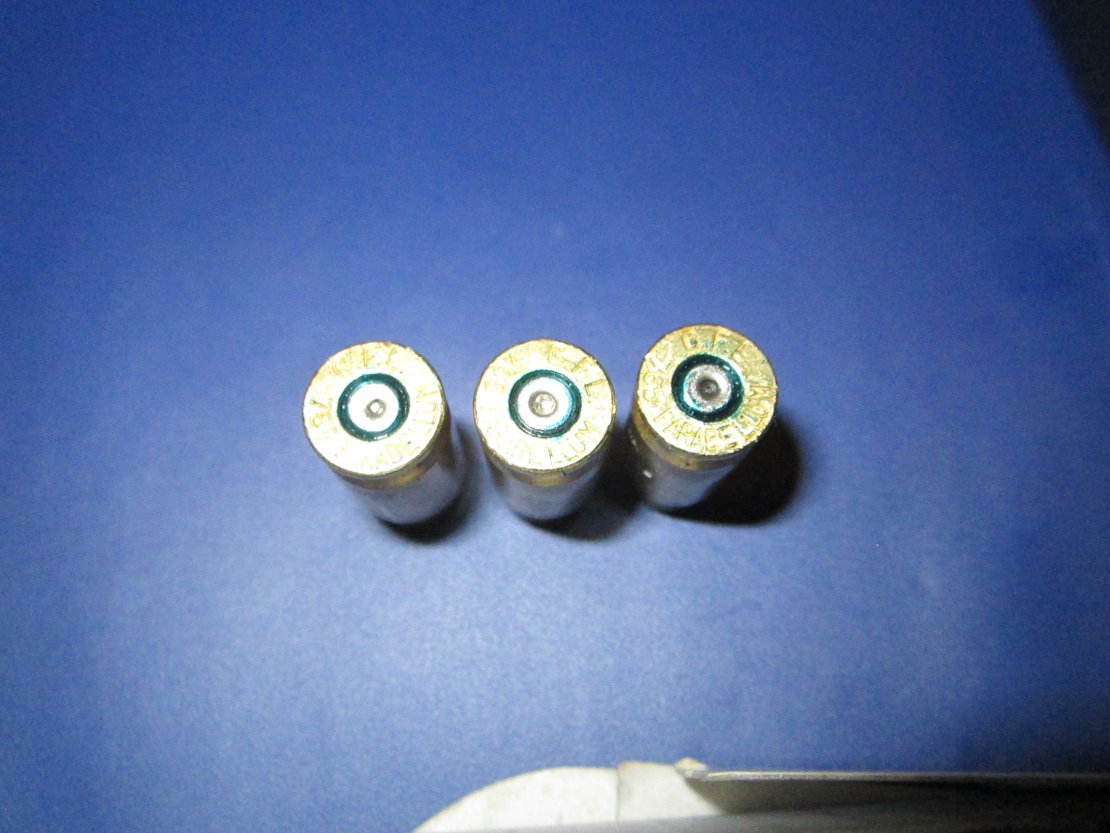

After getting home I did some looking at the gun and spent shells. I noticed the spent shells on the back side where the firing pin hits the shell, had different depths of indentions on the primer.
As looking at the upper frame where it rides in the groove on the main body, I noticed some unusual wear on the frame.
So Anyone got any comments on this issue with the toggle. I also did some further inspection on the entire gun. See next thread.

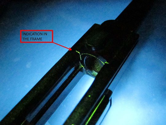

When I got home I completely stripped the gun down for cleaning and a good looking at. Well I do NDE for a living so... I went and got some fluorescent magnetic particle equipment from my shop and brought home to do a more thorough inspection on the entire gun.
Well, in doing this I found to areas on interest that will more than likely make me not wanna shot the gun again.

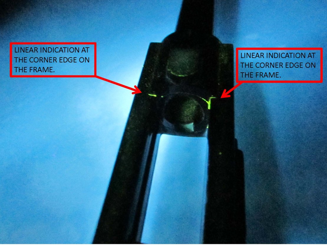

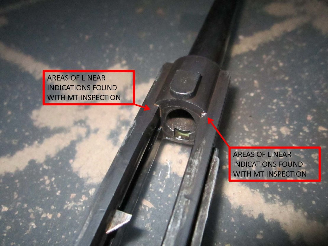

The 1st area was around the loading chamber on the upper frame. This was on the bottom sde of the frame at the point where the thin rails tie in to the round portion for where the barrel screws in. These indications are in a corner and run in the corners and out into the round portion <1/16" on one side. See Pics.

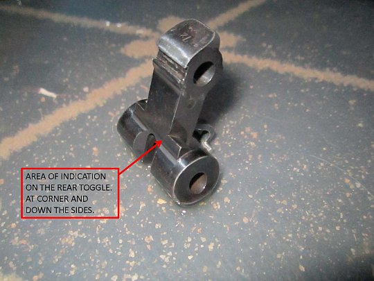

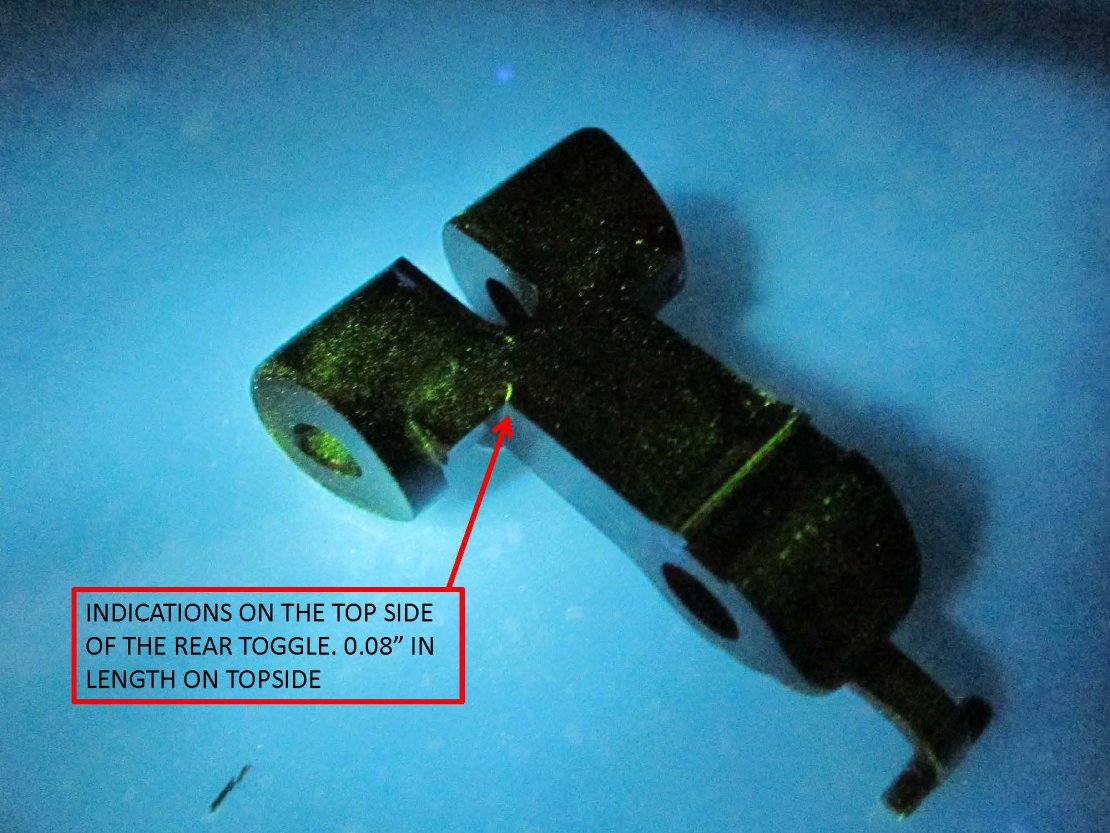

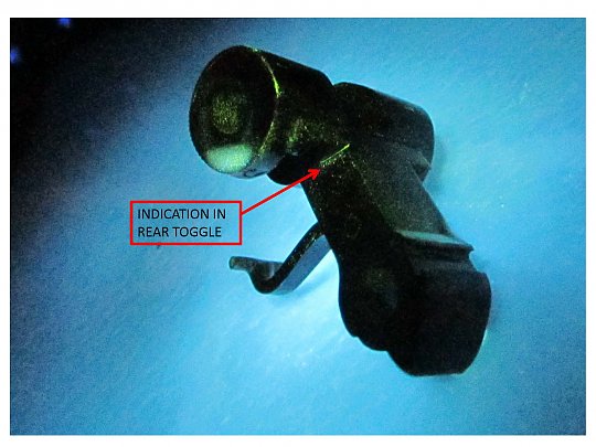

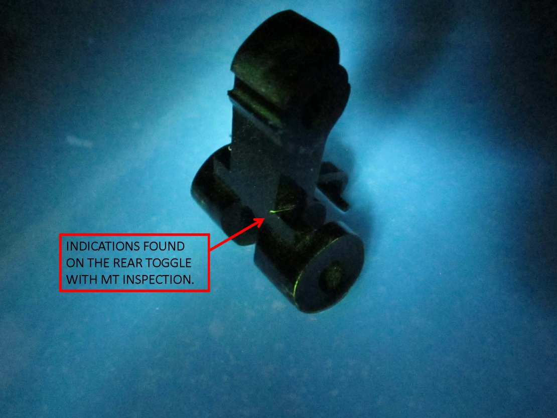

The next and probably more detrimental to the gun was found on the rear toggle. The cut out corners on the toggle where it sits down into the main frame when completely closed, I found some cracking inthe corners and on the left side of the toggle the indication ran onto the top of the toggle approximately 0.08". This particular indication makes me NOT wanna shoot it anymore as this portion of the gun appears to take alot of stress through its operation.
So... This is my new issue with gun that I truly love shooting. So now I dont really know what to do. Do I just keep it all together as is, as this gun is the 1900 american eagle. Or do I try and replace parts. The frame indication may not be a real issue, or is it? Please comment on this. The toggle I know not to shoot the gun anymore with that indication in it, or do I?
PLease give me yalls thoughts and opinions on what I should do with this relic. I probably just need to invest in a good shooter luger to keep with the enjoyment of shooting these guns. Definitely a 9mm version as these 30 cal bullets are quite expensive to shoot.
Thanks for any feedback yall give me, as I do take yalls suggestions and comments to the heart.

Great info for everyone! I agree, get a shooter that doesn't matter if it breaks.

Yeah Im actually glad I went through and did a magnetic particle examination on the parts. Cause them indications on the toggle and frame I never would have seen with my eyes only. The bigger one on the toggle once I knew it was there could faintly see it.
Overall this is a good lesson of you cant always see things that can cause trouble on your guns. It never hurts to look if you have the capability to do so.

My first thought was the main spring but after seeing those cracks IDK.
If you really want to keep shooting this gun I'd replace those raked parts with good ones and save the original parts.
OR buy a shooter and retire this one to a display case.

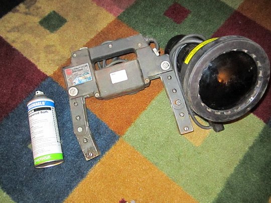

"NDE" is "non destructive evaulation", right?
Is this the kind of portable equipment you're using:
http://www.magnaflux.com/Products/Ma...ectionKit.aspx
That dye really gets into imperfections, doesn't it!

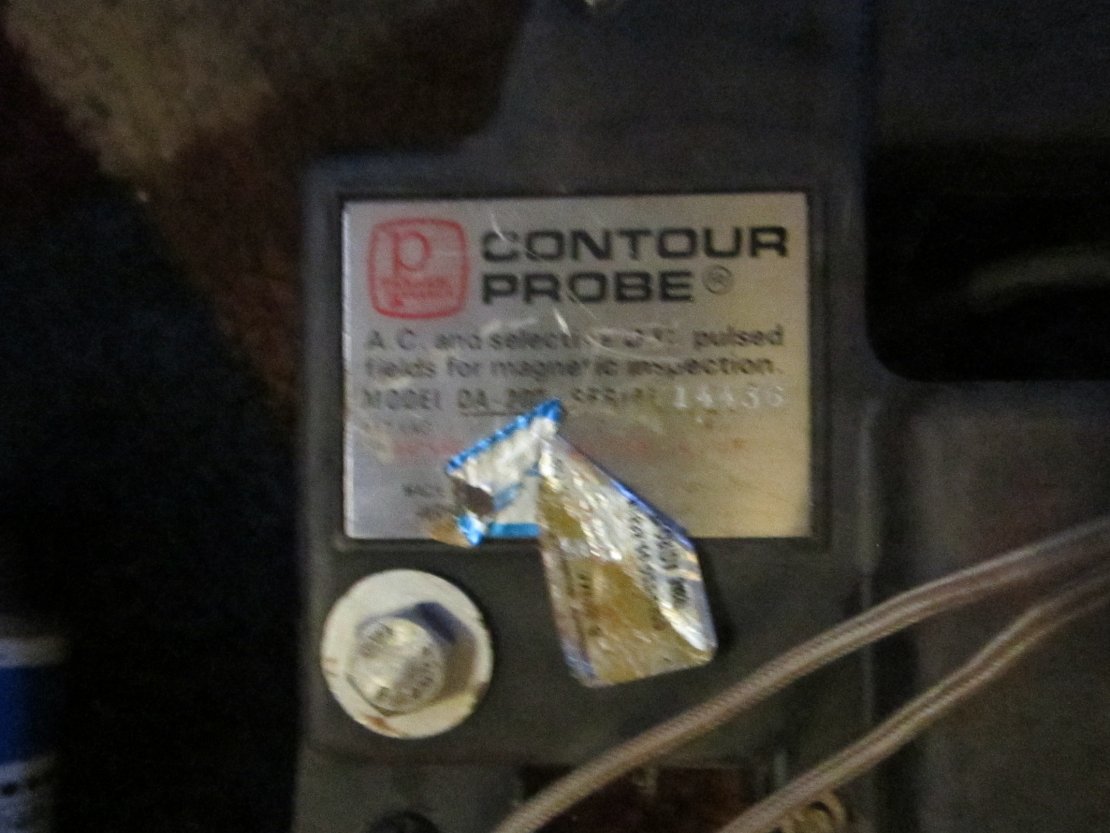

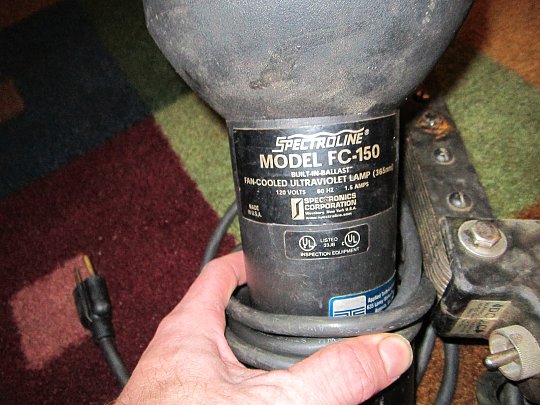

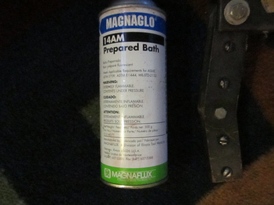

Marc you are correct on how I went about getting these pics. This method of using magnetism to show cracking in a carbon steel part is very sensitive. I use this method in pressure vessels and storage tanks in chemical plants, paper mills and refinerys around the SE portion of the United States. It is quick and very good at showing areas of metal fatigue that you can not see with your naked eye. I attached a photo of what I used.
There is also a cheaper way of doing this as well and can be done on stainless steel as well as carbon steel. Its liquid dye penetrant examination. You spray on a red dye and let it sit for a bit and wash the dye off and then spray a white developer on the part after its dry. If there is a crack or pin hole or something open to the surface the dye will pull out of the crack and you will be able to see it.
Just food for thought on those out there that wanna inspect there own luger parts quick and easy.

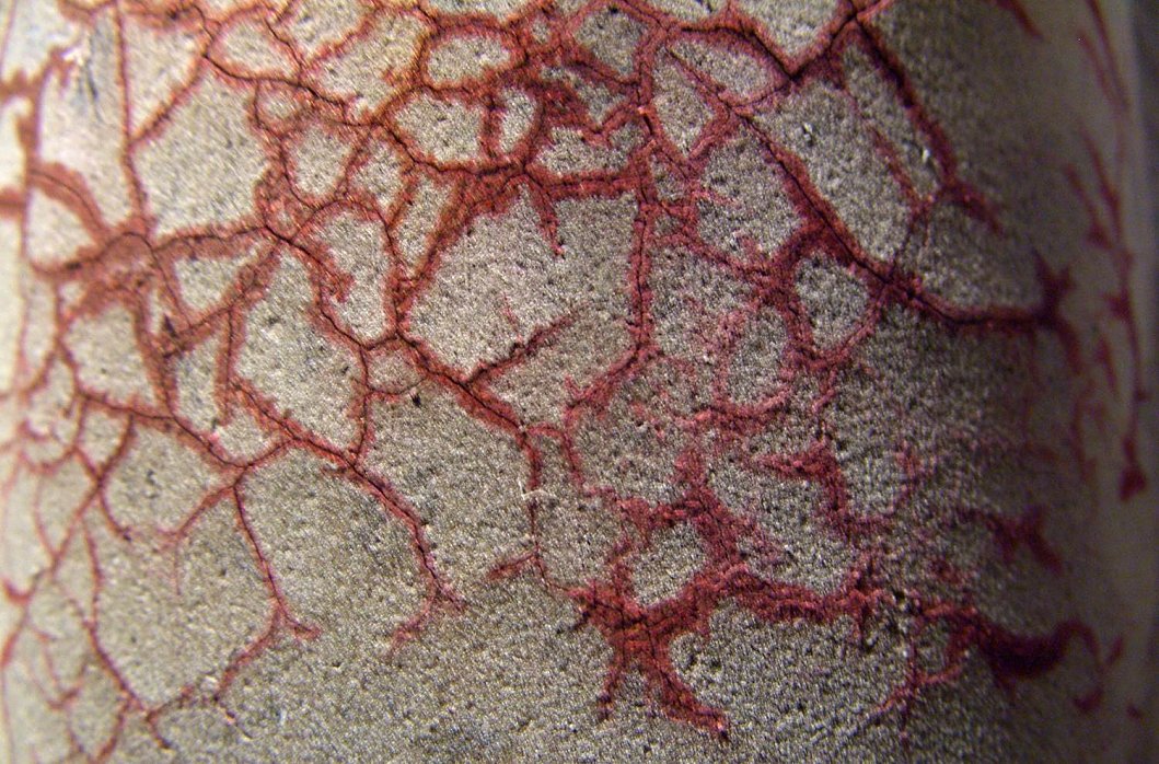

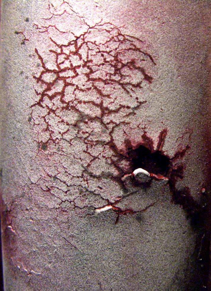

Heres a couple of good pictures of liquid dye penetrant examination to give you an idea of what else is out there. This method is cheap and can buy the supplies at any welding supply store I would imagine
If anyone wants to know exactly what to ask for, Id more than happy to help them out.

I don't pretend to be an expert gunsmith but I do shoot a 1900 AE. I cannot account for the inconsistant firing pin strikes if you have a clean gun. The wear marks on the receiver rails suggest to me that the receiver may have been damaged as a result of an attempt to remove the barrel. The drag you experience could be anything but I can relate a personal experience: I had a similar problem with drag and the toggle not fully returning to battery. The problem was the leaf spring (a replacement - probably an ancient aftermarket part). the "ears" on the top of the spring where it engages the link on the toggle were rubbing against the bottom of the breach block. Some carefull fitting solved the problem. You might try putting a piece of scotch tape on the bottom of the breech block and cycling the action - scars on the tape will tell the story. On another note - I notice that you are using commercial ammo. I suggest that you reload and work up to the minimum load that functions. Best of luck.

Yeah I have been using the fiocchi brand ammo, as that is the only kind I can find locally. And at $35 for a box of 50 I would rather have some reload.
I am going to try the scotch tape idea and see what happens. Im curious about that. But your idea about the barrel b eing changed, your dead on with that. My barrel has been changed out sometime in the past as it hasa no SN on the barrel.
